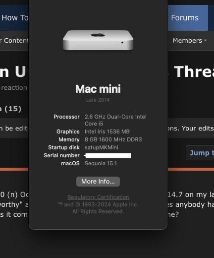

OCLP 2.1.0 trying from today
Same error with 15.0.1 and OCLP2.1. Going to try without spoofing MM7,1 to 8,1.
