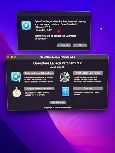

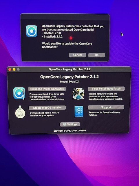

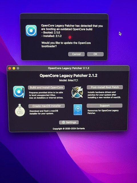

I have a new, to me, late 2015 27 Imac. I wanted to start over and put everything on an external drive, for one thing I tired of constantly seeing the top message appear. I searched the Imac and deleted the dortania files, I am now on the latest Monterey. I have reset NVRAM and SMC.
I downloaded the latest OCLP from 11 hours ago, and again up popped the annoying message about booted 2.1.0, installed 2.1.2. I have not installed 2.1.2. or any other OCLP I just downloaded and opened 2.1.2 then the top message appeared again. On this clean install of Monterey I thought I had erased all previous traces of OCLP so I could start over. What else do I need to do to stop the top message from appearing. Thanks for the help.

Using OI recovery I wiped every thing, installed Monterey, used Time Machine, uninstalled
OCLP to get rid of a repeated annoyance, (thanks Mwidjaya), installed 2.1.2, OTA installed 15.2 from software update, patched. Everything seems fine.

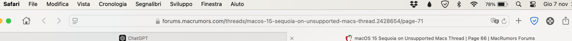

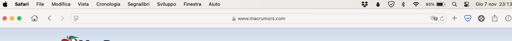

Since I installed Sequoia, starting with version 15, I've encountered a minor bug that only happens in Safari. Randomly, the menu becomes blurred. However, if I switch to another app and come back to Safari, or if I close and reopen Safari, the issue resolves itself. Has anyone else experienced this?

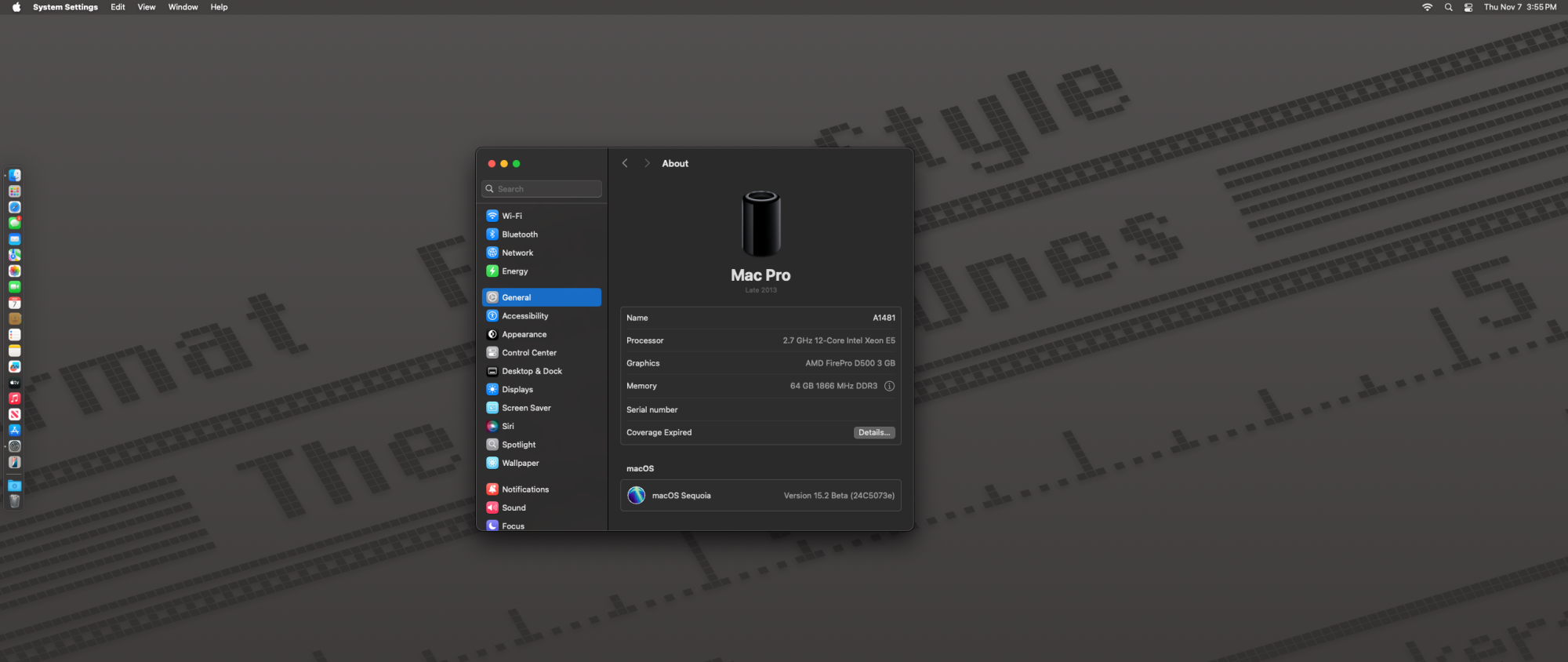

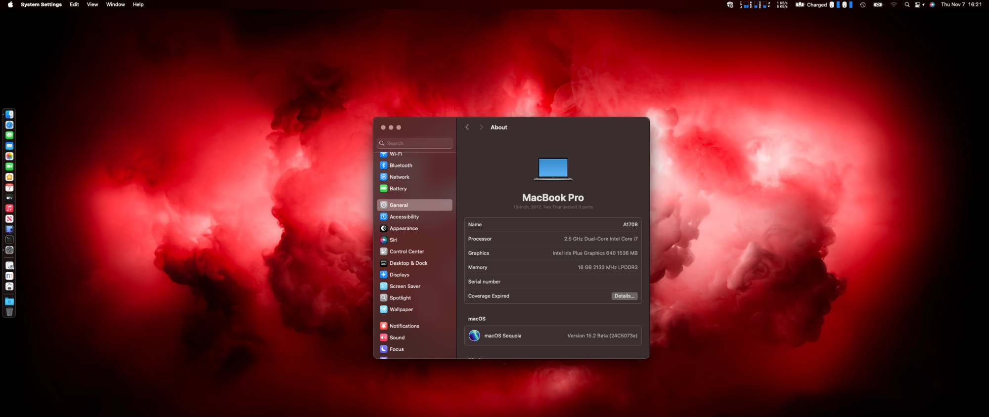

mbp 11,1 currently updating to same
