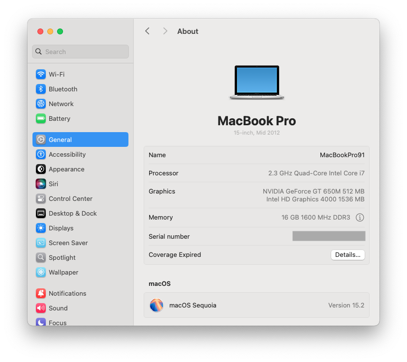

The mbp9,1 got OTA'd to 15.2 successfully. Will keep an eye out for any unknown issues.

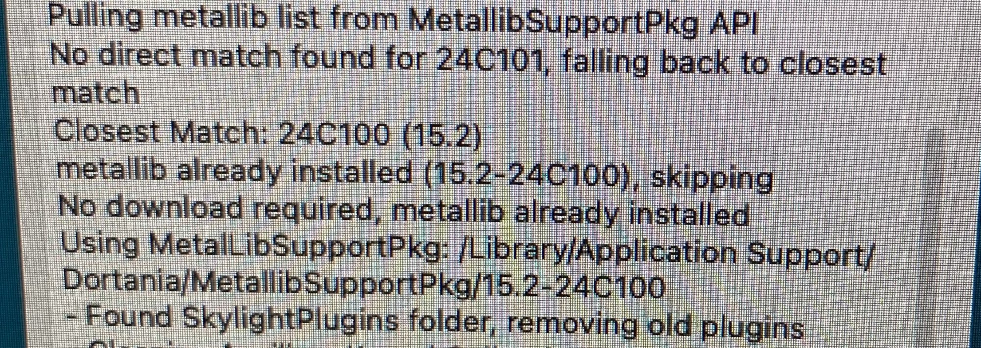

So you all installed MacOS 15.2 (24C101) with OCLP 2.2? Did OCLP download the matching metallib 24C101 somewhere even if it is not yet available for manual download on GitHub?
Reactions: macpro_mid2014
OCLP uses the closest match so metallib 24C100 will also be used for 24C101 without problemes - same behavior with the KDK if needed.
Yes, I was just curious (and impatient). I have now installed 15.2 (24C101) with OCLP 2.2, and indeed, OCLP says it can't find the 24C100 metallib and has downloaded 24C100. As usual, I have the "gray screen phenomenon" during startup, but as I know by now, this disappears later when the background activities with the updates are finished. I'm happy to see that the Find My app is finally working again on my Mac, and with it the desktop widgets. So all other iCloud issues are probably fixed as well, as expected from the changelog info.

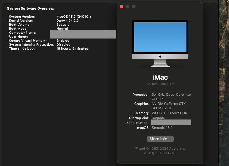

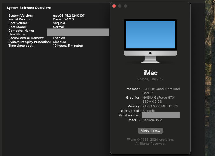

Hello to all,
A preamble: both of my computers are connected to Ethernet while updating system software, hence, loss of WiFi during installation is not relevant to the process.

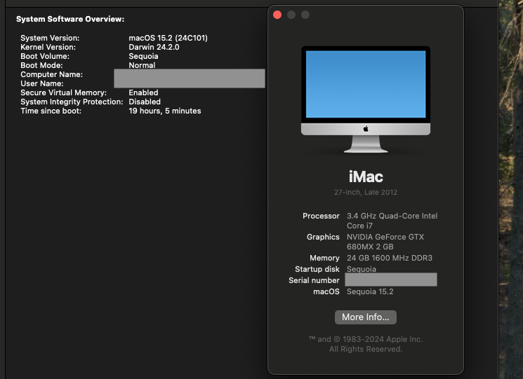

iMac 13,2 (late 2012). Metal-capable
On the iMac I have to revert patches before the OTA update panel actually works properly (panel seems inactive or stalls mid process). Once rebooted without patches, OTA update offers delta update. The delta update process fails with an error message, but once error message is dismissed, and update button is clicked again, full installer is downloaded.
Installation proceeded without issues. Patching was also smooth; there was no request attempt by OCLP to download new Metalib package. However, I previously transplanted Metaliib folder, from an external drive running15.2RC to the iMac internal drive; the latter run Sequoia 15.2 - 24C100, so there was a Metalib resident when 15.2 - 24C101 was installed. See post #2072 or, for alternate method, Tom1211’s posts (above) regarding MetaLib package "fix".
Patching via OCLP 2.2 completed without issues; WiFi and Bluetooth were fully enabled.
Airdrop, Handoff, continuity and iPhone camera (e.g. FaceTime), all work as expected.

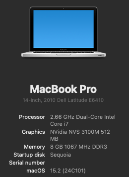

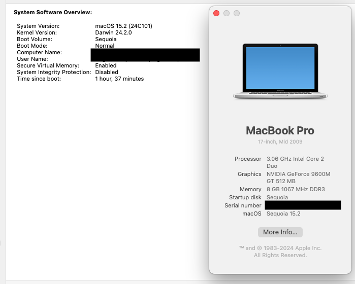

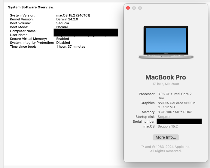

MacBook Pro 5,2. (2009). Non-metal (probably applicable to some other non-metal machines)
Requires external keyboard and mouse connected via external USB hub in order to complete installation and login; keyboard and track pad are fully functional once system is patched.
Process:
Downloaded 24C101 OTA, and patched with OCLP 2.2 (public release)
Installation went without problems and machine booted to desktop.
OCLP did “try” to download KDK for 24C101while patching, but process stalled. I quit the installer and downloaded KDK 24C101 from apple website. Installed it manually, then relaunched OCLP to complete patching. On reboot graphics acceleration worked, as did WiFi and Bluetooth. Keyboard backlight required SMC reset to work.
Again, superb work by developers and tester teams.
Hope this post may be of help.

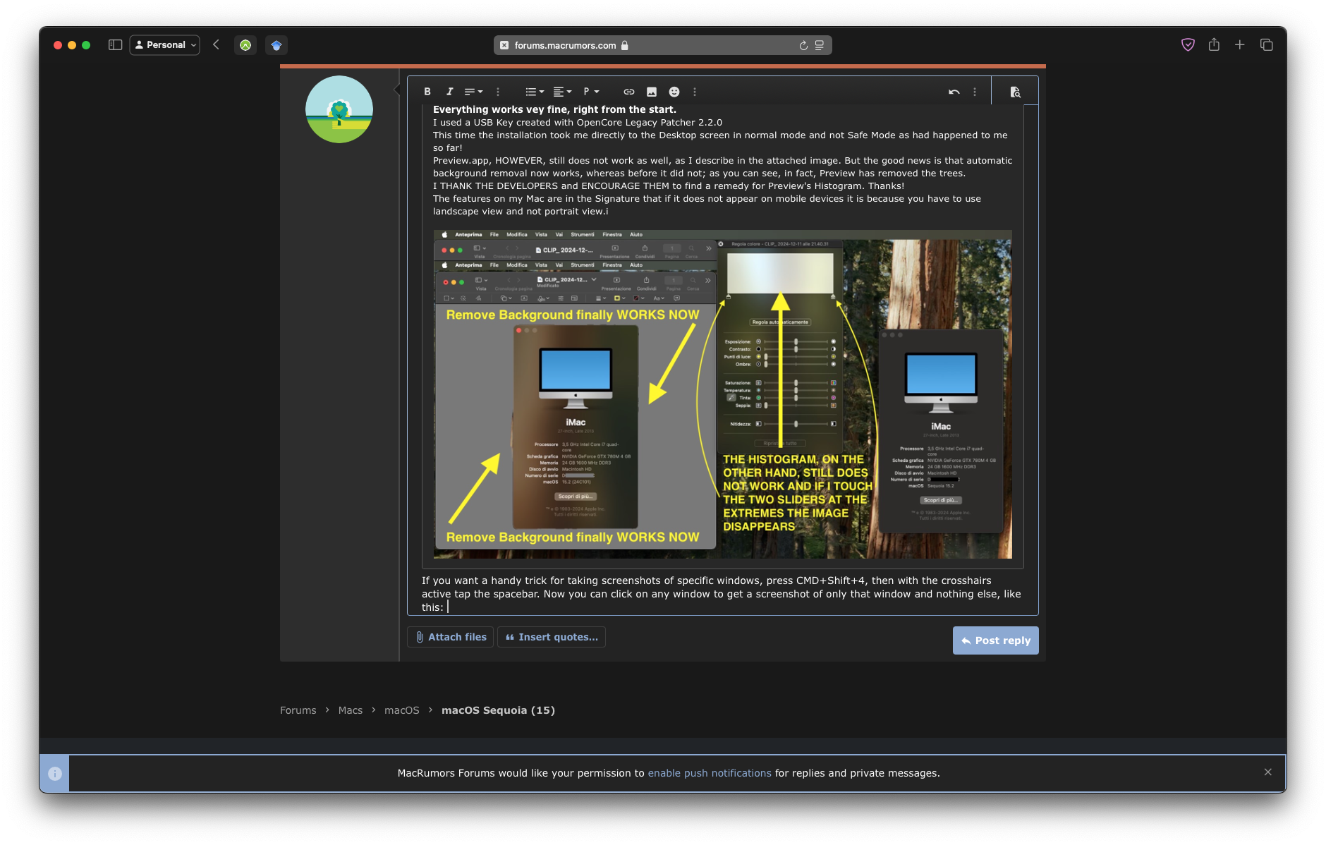

iMac 14,2 updated to MacOS 15.2 with OCLP 2.2.0. All seems ok, but still can't render the Sequoia dynamic wallpaper.
Ho @Marfan-58! We meet from time to time! :)
Sequoia's original / final dynamic background doesn't work, and if you're really interested you might be able to find the version distributed with the early betas around, since it's created in .HEIC format, like the earlier dynamic versions. (Or I can send it to you privately). But both the final version and the beta are very ugly, and maybe that's why our "Sir iMacs" refuse to start them ;):p:D
Instead, if you haven't noticed, the standard background with the Sequoia forest works just fine! It comes alive when you freeze the screen or wake it up from sleep and changes position in the Desktop.
That said, the only thing that worries me as I work is the Histogram malfunction in Preview and the bug that causes the image to disappear if you press "Auto Levels" or touch the two sliders at the ends.
Preview is an original and important part of macOS and I hope the OCLP’s Developers will fix this Metal issue (which the powerful Kepler video cards in our 14,2 iMacs can overcome), as they did with Chess, Music and FreeForm.

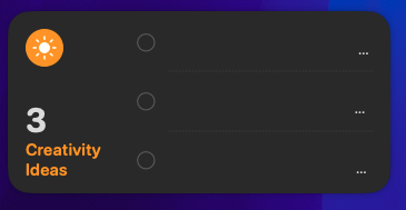

just installed my mbp early 2015 13" to sequoia 15.2 + oclp 2.2.0 and reminders and calendars widgets are not displaying infos. Am i the only one who's experiencing this? how can i fix this issue?
