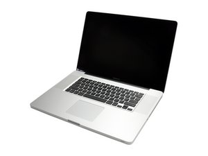

I have had a weird problem with my Macbook Pro 8.2 (2011 15"). This is the one with the AMD GPU that fails (mine failed about 5 years ago.) It was running Sequoia fine (surprisingly well) but then an Apple update made the display go black. I ended up doing an SMC and NVRAM reset which undid the disabling of the dGPU and I also tried to wipe the SSD and do a clean install. I have managed to get the install to complete with the fuzzy screen but I can't get it to boot afterwards. I could probably get Linux to install but I don't know if you can re-do the NVRAM GPU disable from Linux. I have also tried Ventura and Sonoma with no joy. Any help or advice much appreciated...
I have had a weird problem with my Macbook Pro 8.2 (2011 15"). >>> Any help or advice much appreciated...
Had a friend that had this reasonably well fixed. Read this if you have not and still want to give it a go:
It is also technically possible to replace the GPU but probably not worth it, unless you have a very good friend in a repair shop. Good luck.
The issue is that I had it working these last 5 years with the broken dGPU but as far as I can work out, I need Mac OS on there to do the fixes and it just won't boot. Anyone know how to do the NVRAM and kext fixes from the install USB which does boot or from Linux? Single user mode just boot loops and even safe mode won't finish booting. Recovery doesn't work either.

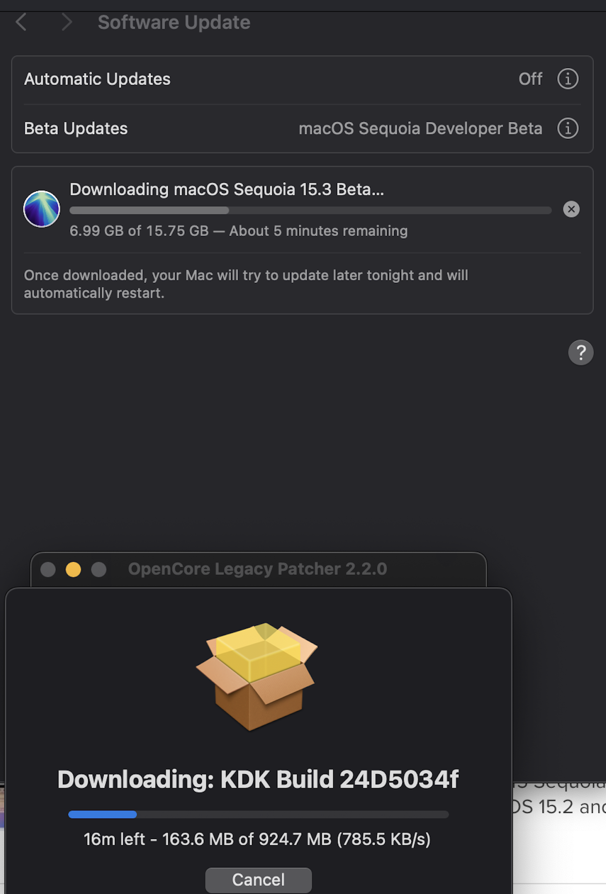

I did the above post after downloading the latest beta, that came at the same time as the IOS and ATV betas. It used to be that I would have a white screen after an update before the patching process, recently the desktop has been normal at startup, but the mouse control is still iffy. The OTA update process was smooth, although I did have to sign in, and there was an error sign about windows something or other. After the patching no problems.
Do you get any video signal whatsoever with an external monitor connected in open or closed lid mode while holding the option key? Does the machine gives off the POST chime?

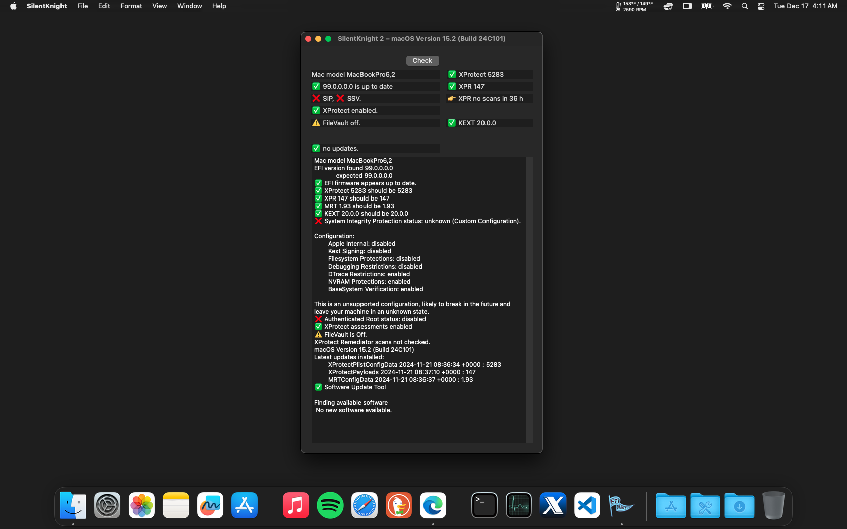

MacBookPro6,2 is running good. Some slight lag here and there, but not unusable.
Issues:
- Keyboard brightness varies, but re-applying patches and clearing NVRAM (3 chimes) brings it back most of the time.
- I did have to change my wallpaper and change the wallpaper in the plist file (Library/Preferences/com.apple.wallpaper.plist) because it kept on trying to revert to the animated sequoia wallpaper which would lag TF out of everything. Looking at it again, it changed itself back, but doesn't try to load anymore 🤷‍♂️
Code:
<dict>
    <key>SystemWallpaperURL</key>
 <string>file:///System/Library/Desktop%20Pictures/.wallpapers/Sequoia%20Sunrise/Sequoia%20Sunrise.mov</string>
</dict>
I don't use all features, so I'm sure there is stuff that doesn't work 100% due to being Intel based.
External monitors haven't worked since the dGPU failed. The machine does chime and the backlight comes on. I get a fuzzy boot screen and can choose OCLP, Install Mac OS Sequoia etc but the boot process doesn't complete and ends with a black display. I can get terminal etc if I boot from a USB stick but with the fuzzy display.
I have the same issue on one of my Macs.
Not much to do with OCLP and the known fixes are in the link I gave you a few posts back.
The one thing to try in OCLP would be to build a new OCLP with "Disable Firmware Throttling" on a USB stick and boot from that. Unlikely to help but maybe worth a shot.

Thanks for the tip. OCLP has really kept this MacBook alive, I have gone through Big Sur, Monterrey, Ventura, Sonoma and Sequoia. In the past, i have always been able to do a clean OCLP install and get it working again which is why I am asking on here. I don't really want to go back to Lion or High Sierra and start again. If I can't get Sequoia working, I'll probably have another go with Ubuntu, Mint or Pop OS which all really fly on this machine. I think I can blacklist the AMD drivers and go that way.

These issues predate my use of OCLP on this MacBook but OCLP has really helped me keep on top of it. The "root patches" disable the dGPU and make sure it just uses the iGPU. I think my issue is getting to the point where Mac OS is fully installed, boots and I am able to root patch or use the NVRAM args to disable the dGPU. If I can't manage this, I may try to install Linux and blacklist the AMD drivers as an alternative approach. When it works, it is my most productive laptop where I can just get stuff done quickly.
Can you see the boot picker or any other display while booting?
