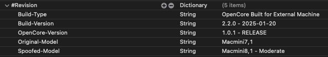

@nekton1 I don't know the OCLP behavior with your MM7,1; however, if you didn't perform a clean install, that may be suspect.

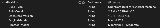

If you inspect your Open Core config.plist again and look at the top section labeled "#Revision," what do you see? Can you post it? It should look something like this:
Note that your "format" is not different from mine, just the "view" is different. The config.plist format (raw file) is unchanging. The view depends on which plist editor (or raw editor) you're using to view the file. I use Xcode.
EDIT: @nekton1 On your iMac16,1, if you want to enable spoofing, you should be able to do the following: 1) Run OCLP 2.2.0 on your iMac16,1 2) change SMBIOS spoofing level to "Moderate" under the SMBIOS tab 3) Return to the main menu and "Build and Install Open Core" and click "Install to Disk" when prompted.
I prefer to install the OC EFI to a GUID formatted USB thumb drive for testing before I make it "permanent" on my SSD. That way, if I screw it up, I can always remove the USB thumb drive and boot to recover.

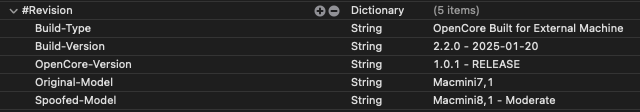

Here it is:
</data>
<key>Hardware-Wifi</key>
<string>14E4:43A0</string>
<key>Hardware-iMac-dGPU-1</key>
<string>8086:A2E</string>
<key>OpenCore-Version</key>
<string>1.0.1 - RELEASE</string>
<key>Original-Model</key>
<string>Macmini7,1</string>
<key>Spoofed-Model</key>
<string>Macmini8,1 - Moderate</string>
Thanks for the 16,1 spoofing advice.

@nekton1 You have confirmed that Open Core is spoofing MM8,1 and that OCLP performed "Moderate" spoofing when it "Build and Installed Open Core." How that happened may remain a mystery.

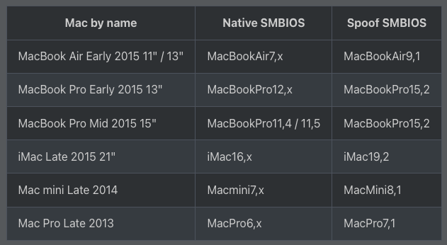

I can only help you with the spoofing part since I don't have your Macs to test and don't use UC myself.
Why are you spoofing iMac18,2 on your iMac16,1? According to the OCLP docs here, selecting Moderate spoofing is supposed to spoof iMac19,2.
If OCLP is spoofing iMac18,2 when Moderate spoofing is selected, you may have found a bug or a problem with documentation. Good luck!
EDIT: @nekton1 I thought you were testing Sequoia (since we're in the Sequoia thread). According to OCLP docs here, spoofing for iMac16,1 depends on which macOS you're running. For example, on my MBP6,2 running Ventura, I "built open core" with OCLP 2.2.0 (Release) for IMac16,1 with Moderate spoofing. OCLP generated an Open Core EFI spoofing iMac18,3 which is different from what you found and different from Dortania docs (which say to spoof iMac18,2). For Sequoia, the OCLP docs say you should be spoofing iMac19,2 for UC.
EDIT2: @nekton1 It appears to me that there is a difference between OCLP docs and OCLP behavior. Docs say that, for iMac16,1, spoof iMac18,2 for Ventura and iMac19,2 for Sequoia. I just performed another test on my MBP6,2 running Sequoia 15,2. When I "build open core" for iMac16,1 with Moderate spoofing, the resulting Open Core EFI still spoofs iMac18,3 (as it did when I ran OCLP in Ventura). Not sure what's going on, so you may need to experiment with different SMBIOS spoofing to find the solution. Sorry I couldn't be more helpful.

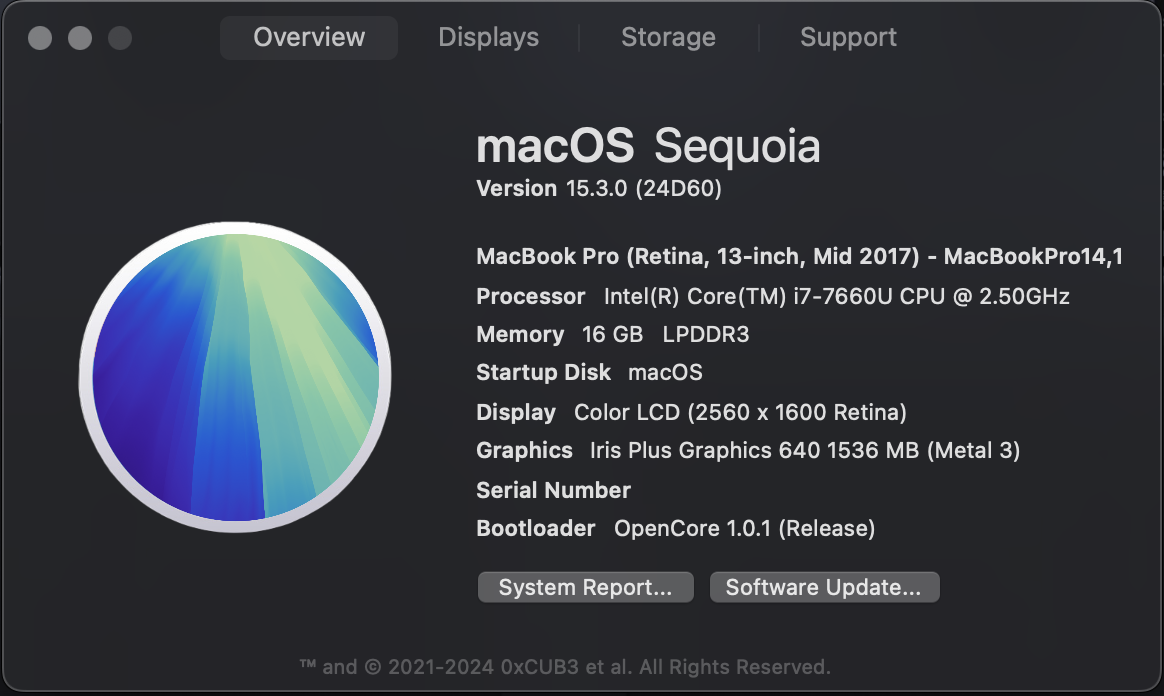

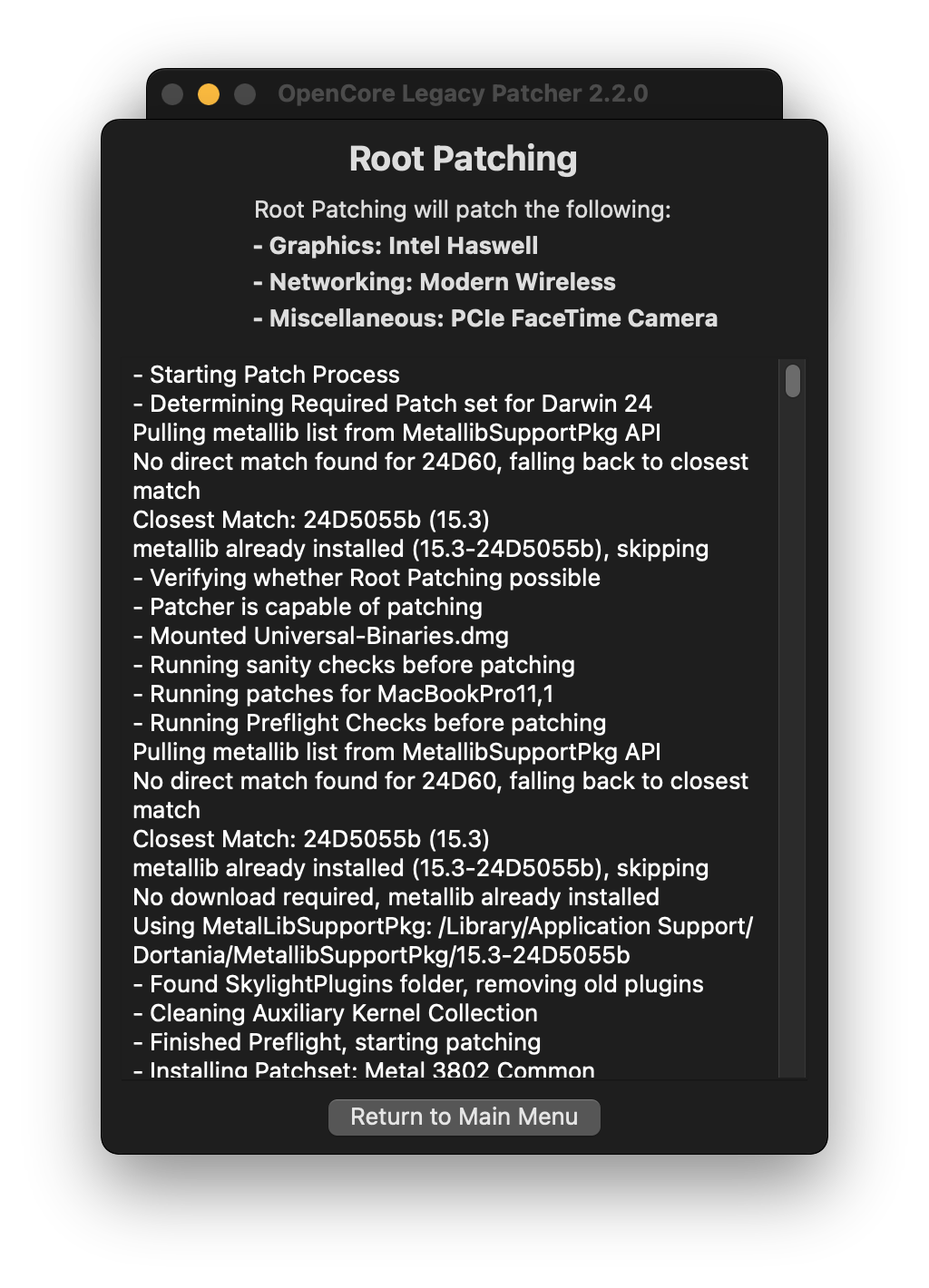

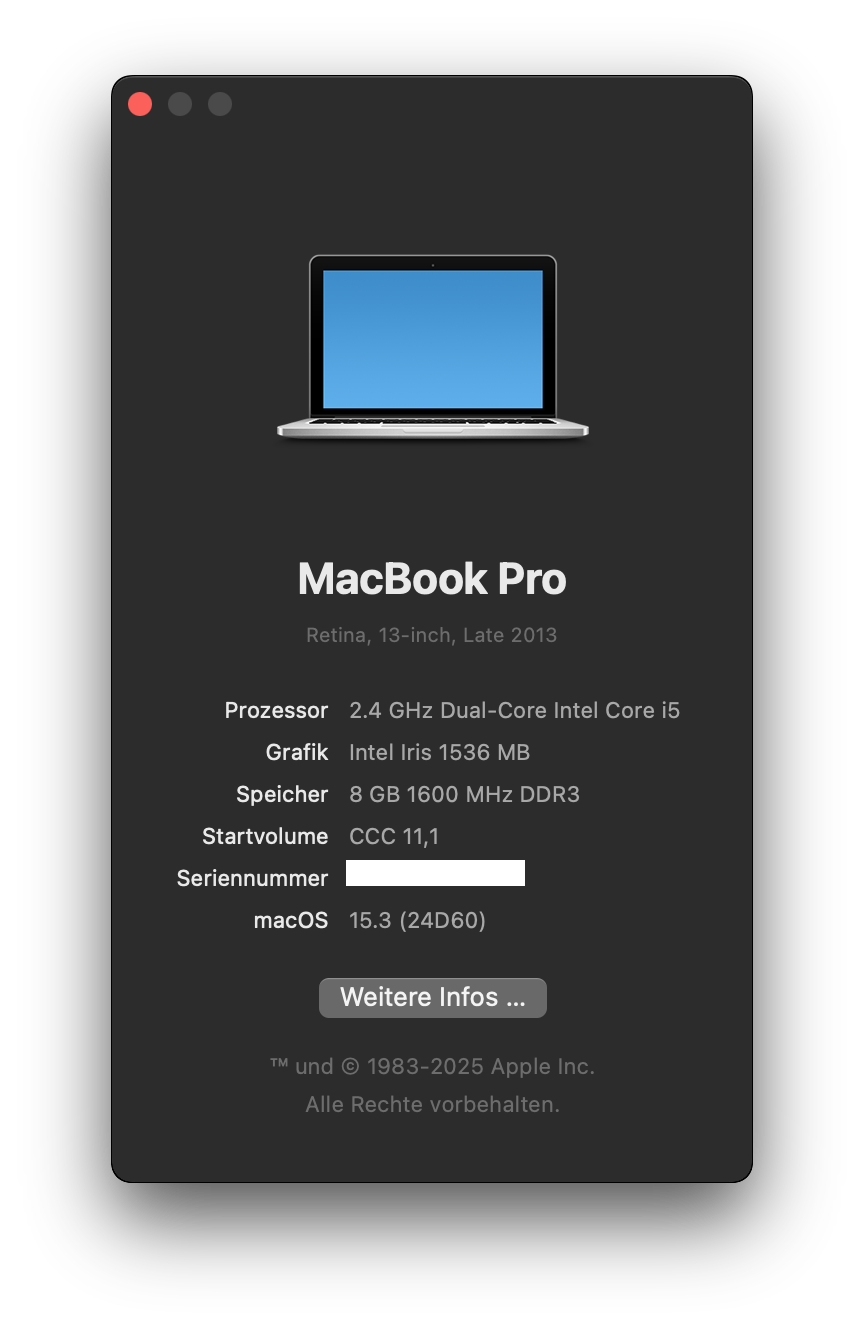

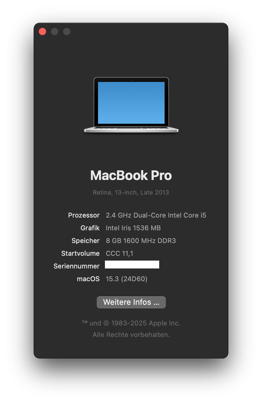

macOS 15.3 Kernel 24D60 Release Candidate is available.
MBP11,1: updated OTA from 15.3b3 to RC (24D60) on external SSD. Using OCLP 2.2.0.
Smooth update and running, no surprises. Thanks to developers!
The metallib from b3 is used in root patching (wired ethernet works but metallib for RC not there yet).

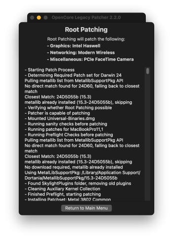

OTA update to 24D60 done using 2.2.0.
Intervention through hard reset was necessary as expected at this point:
AppleUserUSBHostHIDDevice:0x10000047d close by AppleUserHIDEventDriver:0x1000004bf (0x0)
DK: AppleUserHIDEventDriver-0x1000004bf :force close (AppleUserUSBHostHI
Windowserver crashed
Kernelpanic
Continued installation using safe mode.
Patching was rather uneventful and went as expected.
