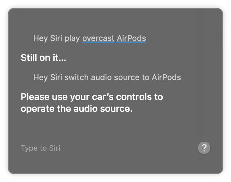

Anyone on 11.3 Beta and with bluetooth audio (bluetooth speakers and AirPods) as well as AirPlay to HomePod completely broken?
Had no issues with any betas ever and suddenly with the 11.3 beta, boom! I was originally pretty excited to get the HomePod stereo output.
