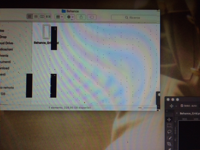

Installed High Sierra 10.13.1 on a MacBookPro 5,3 (Mid 2009). Everything works, though I noticed some strange behaviors: when changing the GPU through System Preferences (passing from discrete GPU, which is default, to integrated) sometimes it never wakes up from logging out (so showing a black screen). Also it happened of not waking up from sleep mode (without closed screen).
Someone experienced the same? Is that a known bug or something like that?

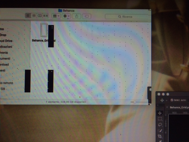

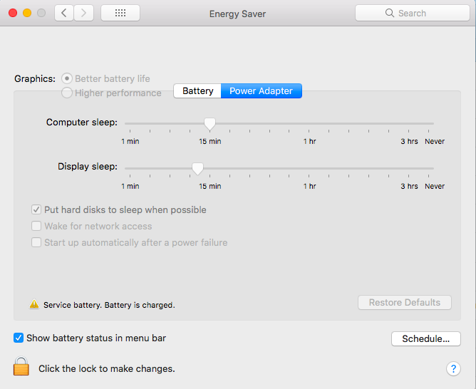

I have a MacBookPro5,1. Anyone else seeing this oddity - the radio buttons overlapping the main pane - on the Energy Saver preference pane?

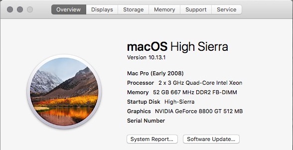

After two weeks with HS 10.13.1 on my Mac Pro 3.1 I downgraded back to 10.12.6.
The Red Screen got to annoying, the wakeup problems with my 5870 weren't solved 100% with the never sleep and I got the feeling the Computer wasn't running as good as under Sierra.
And My AppStore showed me 5 Updates but crashed every time I opened it (without showing what the updates are).
10.12.6 was running like a charm (after I set all tiny niggles) but somehow my 3dot1 doesn't seem to like High Sierra.
I will watch this space and will sure give it an other try some time later!
