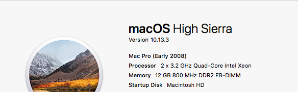

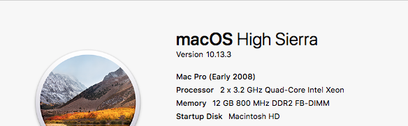

Hello again
Right good we have the same Board ID what we need to do in Text Wrangler is go down to the section for Board IDs
and select one to replace, just one will do. I tend to replace one that has the same amount of characters, I think the one I choose to replace starts with F22 etcetera I just replace the characters after the F with the ones for the MacPro 3.1 Board ID. And then in the nonSupportedModel list MacPro 3.1 is way over to the right nearly at the end of the list just put the cursor behind the last apostrophe of 'MacPro 3.1' and back space to remove it and the apostrophe, be careful to also remove the comma so there is also only one between the two Mac identifiers left with of course the correct spacing.
Once you have done that click on File in the menubar and then Save As from the drop down, save it to the Desktop as Distribution.xml.
Next in Terminal enter the chmod +x command and press space after the x now drag the Distribution.xml into Terminal press return. Remove the .xml extension as described above and move this new modified Distribution into the Expanded folder replacing the original
In Terminal follow the commands to make the modified.pkg
Try again and let me know.
O Happy Joy! it worked
Thank you very much Mr. L Caputo
Note: After I clicked the installer I got the beach ball for a few minutes I was just going to kill it when the installation started at the end of the install it said installation failed but after a reboot I'm now on 10.13.3
Note: After I clicked the installer I got the beach ball for a few minutes I was just going to kill it when the installation started at the end of the install it said installation failed but after a reboot I'm now on 10.13.3 View attachment 749379
