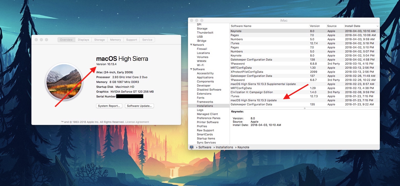

I first of all updated via the App Store and About This Mac was reporting that 10.13.4 was running, but there was no indication in the App Stores 30 day list, so I went to System Report from About This Mac, clicked on Software> Installations, click on Install Date twice to see the most recent updates first and 10.13.4 was not listed. If it is not in the System Report then it hasn't installed. I then downloaded the Combo update, modified the Distribution file repackaged it and installed, 10.13.4 is now installed.
So, are you saying that I'm not really running 10.13.4, even though About This Mac says I am? Is there a way to confirm this by looking at versions of things that were part of the 10.13.4 update to see if they're installed?
I thought that I made it clear that it is the System Report that will tell you whether or not it has installed, have you looked there.
I seem to be part of the group that's not quite sure if I'm actually updated or not. The 13.3 and its supplemental update show as installed under software installations (about this mac) but not 13.4. But it shows that I'm running 13.4. Confusing.
I seem to be part of the group that's not quite sure if I'm actually updated or not. The 13.3 and its supplemental update show as installed under software installations (about this mac) but not 13.4. But it shows that I'm running 13.4. Confusing.View attachment 757064
If it is not in the System Report it has not installed or not installed fully, the fact that About This Mac shows 10.13.4, it is just a blob of information that is taken off the download first and then applied. Please check your install log for an errors.
Would the solution be to simply download the non-combo update file from apple and install?
Yes, you were clear. And yes, I'd looked in the System Report. Same thing happened during the 10.13.3 update. In both cases the System Report didn't show the update but About This Mac was reporting something different. My question was: which do we believe?
Regardless, I've now downloaded the Combo Update, modified it as per your instructions earlier in the thread and installed that. My System Report and About This Mac now happily agree with each other - I'm definitely at 10.13.4. Cheers for those instructions.
Well...thanks for the info on where to look for the "truth." My MBP 5,5 is showing the last update as the macOS High Sierra 10.13.3 Supplemental Update in Software>Installations, but the About This Mac is showing 10.13.4. So much for ignorance is bliss!!
Install either the Delta or the Combo, I prefer the Combos but remember you need to modify the Distribution file for both.
Believe the System Report.
