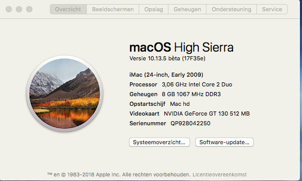

For the first time ever, today I had a dialog pop up saying that I'd run out of application memory and it offered a list of applications to quit. I had a few apps open - Safari (many tabs), Chrome (many tabs), Excel (a few documents), Notes, Reminders, Messages, Keychain - but that's not unusual for me. I have 8GB RAM and loads of free disk space. I'm hoping this is nothing to do with 10.13.4. Strange things were happening as well - when I tried to quit Excel, and it offered me to save open documents (to which I said yes), it said it couldn't find the document. Excel also complained that it couldn't save one of the documents on BT Cloud - I never store documents on BT Cloud. I shall have to keep an eye on it. Anyone else seen this before?
Installed 10.13.5
No problems so far.

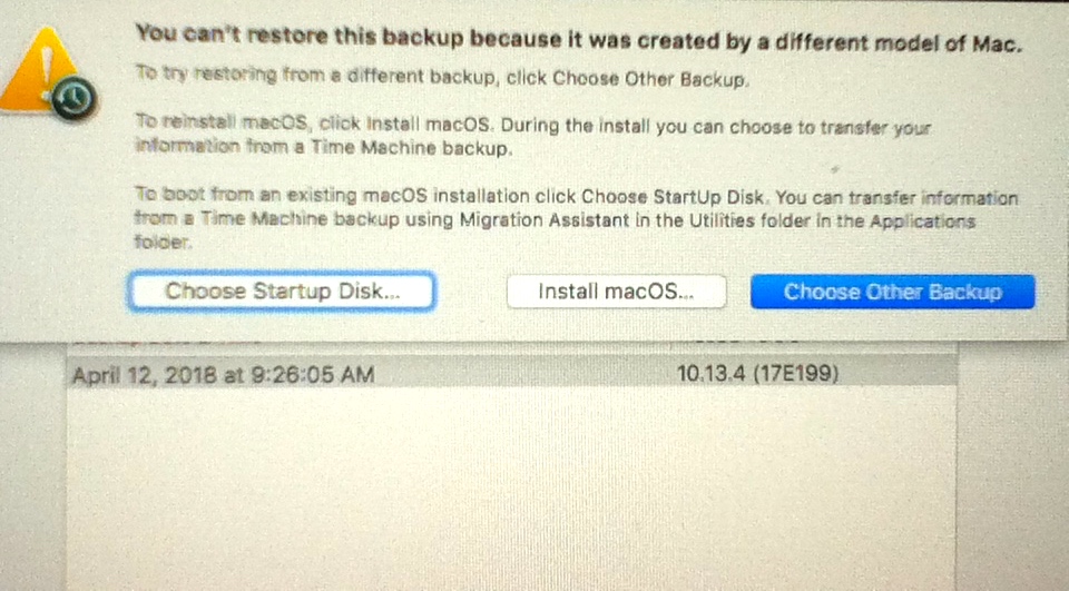

Just discovered something disappointing with my MacPro3,1 High Sierra 10.13.4 installation.
Time Machine Backup, will backup just fine, I can restore individual files no-problem but a total system restore fails with this message...
Originally it would allow restores from 10.13.3 backups, but as soon as I selected a 10.13.4 backup I would get the above message.
So I erased the TM drive and created a new 10.13.4 backup from scratch but still a no-go for system restores.
This was not a problem for me back on 10.13.3.
Thank goodness for CCC.:)

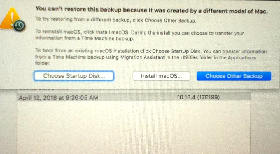

Thanks for the warning!! I will clone my drives, time to buy more drives!
Do you know if individual file recovery works?
You must have missed the part in my original post...
"Just discovered something disappointing with my MacPro3,1 High Sierra 10.13.4 installation.
Time Machine Backup, will backup just fine, I can restore individual files no-problem but a total system restore fails with this message..."
Thanks for the clarification, the time machine restore must check some machine ID and prevents it.
