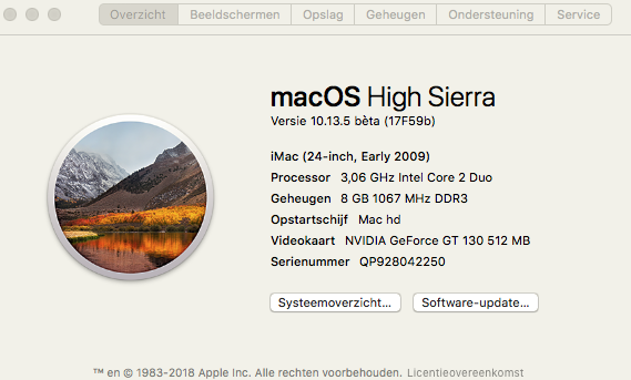

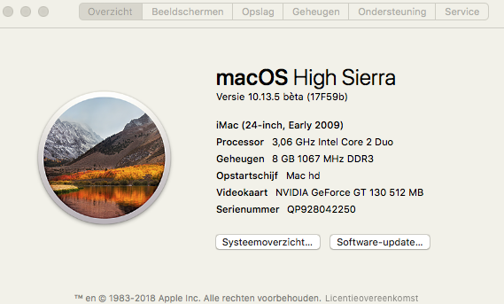

updated to 10.13.5 beta 3 with no problems.
Reactions: flyinmac

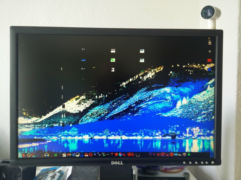

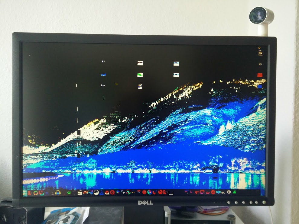

MacPro3,1 running 10.13.4...
When trying to start in Safe-Mode, pressing the Shift key on startup.
all I get is the dreaded "circle/slash" forbidden sign.
Anyone else experience this?
Other then this issue my system works just super fine.
Nope. It works, but really weird ... take a look!:eek:
