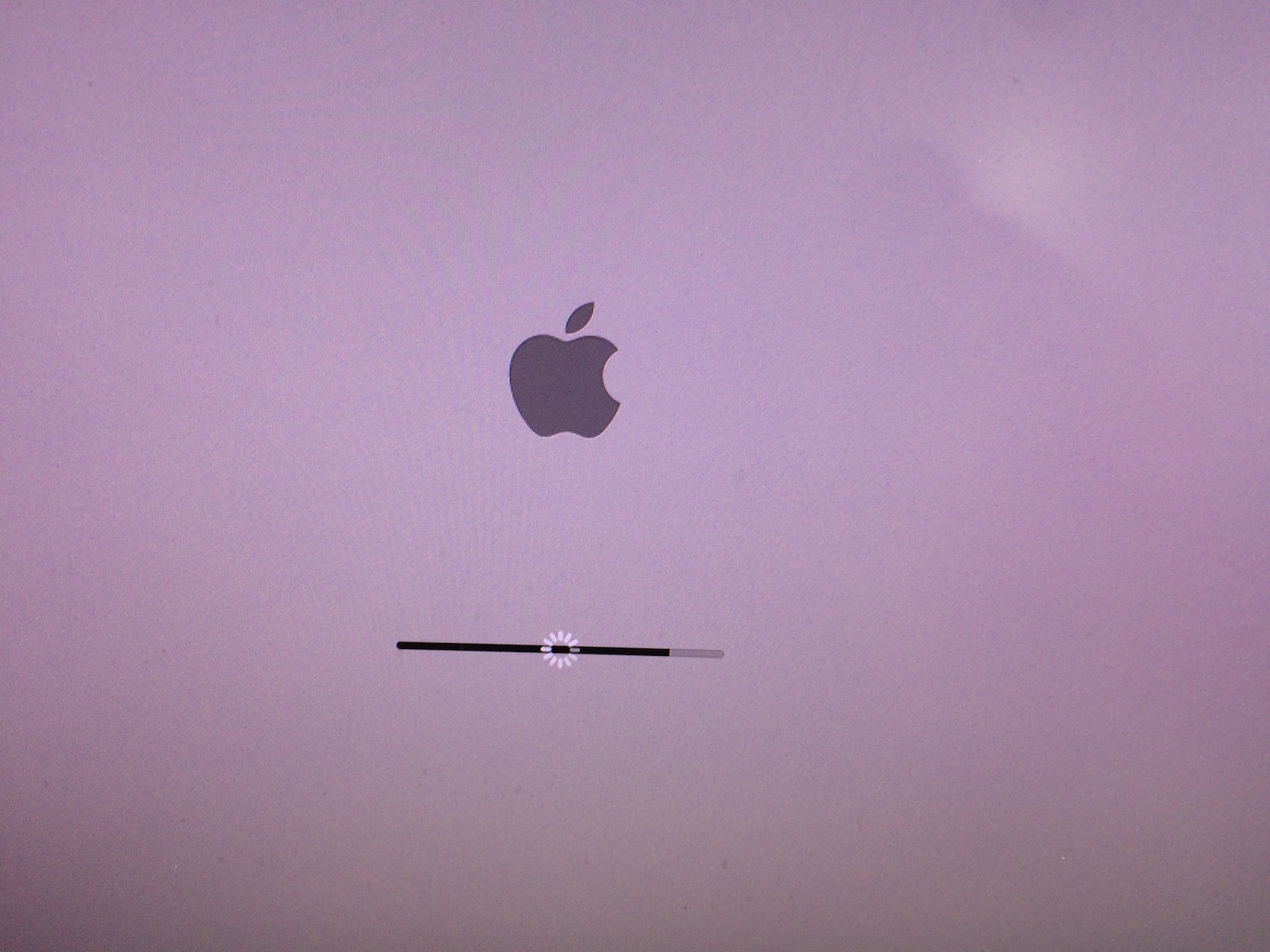

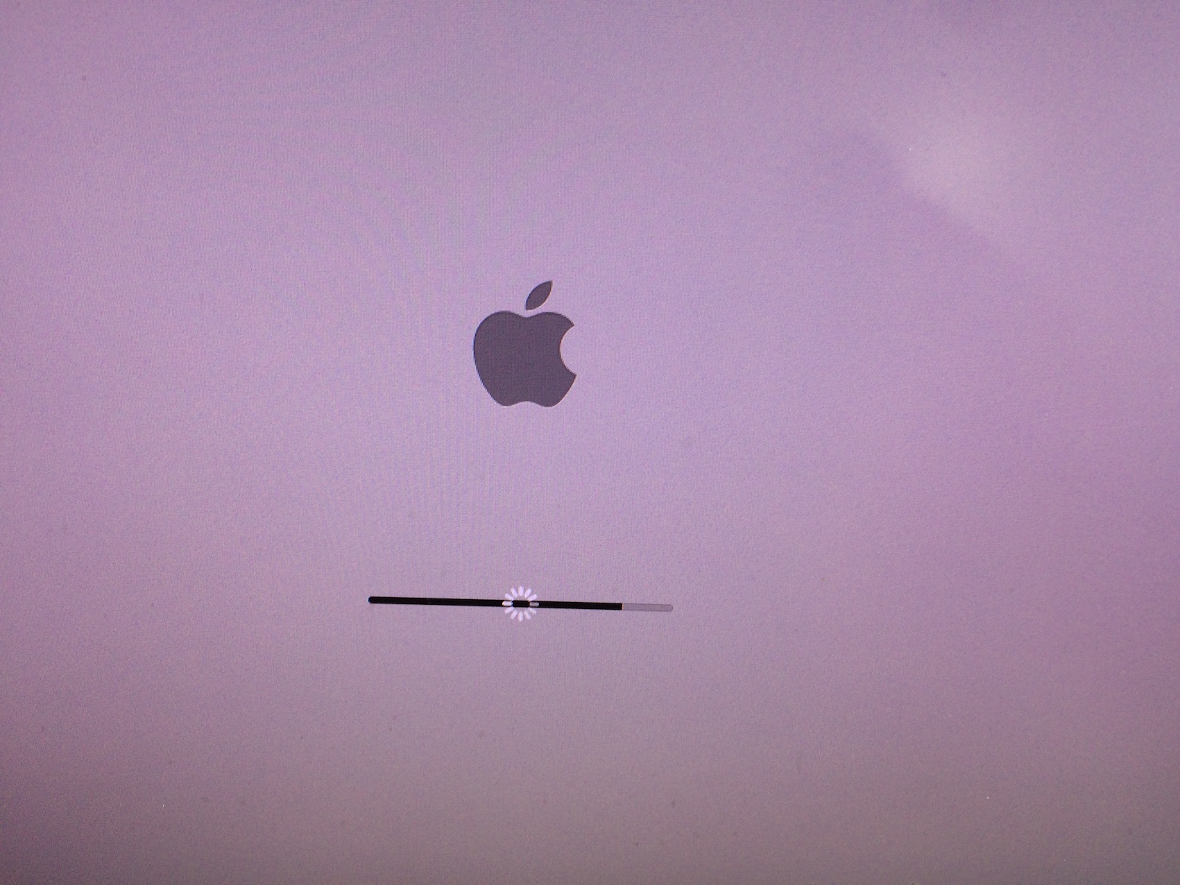

Dosdude as promised here are the Diagnostic Reports for a MacPro3,1 running beta 9.
The earlier WindowServer crash (08:47) is for an HD6870 with full boot screens (shows as RadeonAMDX3000 crash). I enclose a screenshot as well where the boot fails to complete with a spinner. It runs fine in Sierra.
The later WindowServer crashes (about 09:05) are for a Sapphire RX460 4 GB that works fine in Sierra. In this case, the crashes are the RadeonAMDX4000GL drivers.
The later WindowServer crashes (about 09:05) are for a Sapphire RX460 4 GB that works fine in Sierra. In this case, the crashes are the RadeonAMDX4000GL drivers.View attachment 717184

Great, thank you! Try installing this file: SkyLight.framework.zip. To install it, open Terminal, cd into the directory containing the file, and run these commands:
Code:
cp -R /System/Library/PrivateFrameworks/SkyLight.framework ~/SkyLight-backup.framework
sudo cp -R SkyLight.framework /System/Library/PrivateFrameworks
sudo chmod -R 755 /System/Library/PrivateFrameworks/SkyLight.framework
sudo chown -R 0:0 /System/Library/PrivateFrameworks/SkyLight.framework
Then, reboot your machine and see if it successfully boots with the other video card. This may cause the system to stop booting entirely, in which case just copy the backup back into the original "/System/Library/PrivateFrameworks/" directory.
EDIT:
Do not try this, it doesn't work.
Code:
EDIT:
OK, I won't try it.
Update: It appears the GPU issue is the result of SSE4.2 requirements in some of the High Sierra GPU kexts, which the CPUs in the Mac Pro 3,1 do not support. As such, it may not be possible to get these cards working in the Mac Pro 3,1 running High Sierra.
Also, has anybody tried an aftermarket nVidia card? It appears these changes may have only been made to the drivers for AMD cards.
So why does an HD2600XT, which is a much earlier card than either the HD6870 or RX460, work? Also I have read reports that the RX460 2 GB version and the RX580 both work. It seems that it is "just" a matter or Apple modifying the relevant kexts to support the older cards, which they won't do of course.
Apple modified the drivers for all the AMD cards newer than the 2600 Pro. That's why it works just fine with the stock cards.
