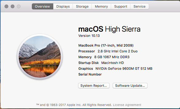

Works a treat here ... MBP5,2 17" (mid 2009). Thanks dosdude1!!

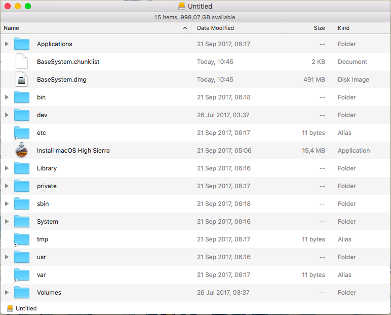

Make sure the name of your USB drive doesn't contain any weird characters, and also ensure the path to the High Sierra Installer app doesn't contain any weird characters (such as accents, ñ, é, etc). Also ensure you're logged in as an administrator on your Mac.

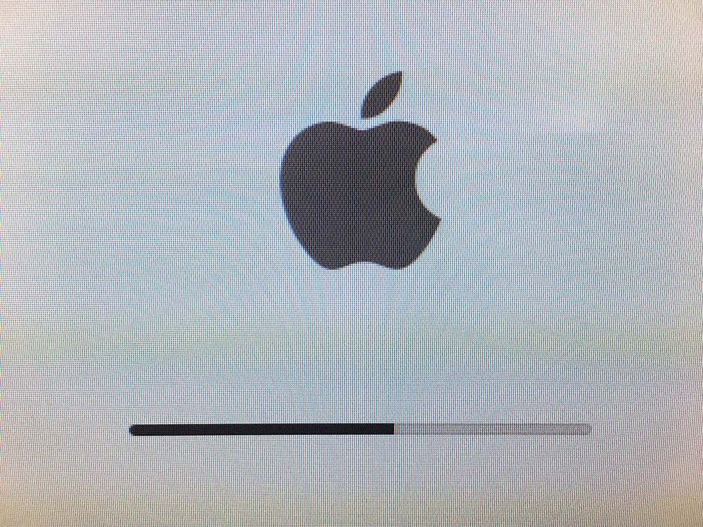

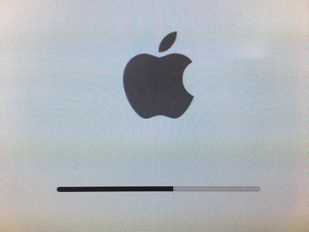

I have tried again. I've set my device language to English, just in case. My username is a single word, with no weird characters, the external device now is Untitled, and it freezes exactly in the same point. More or less, when the bar is at 30%. Just a few seconds after it opens the external drive with this contents:
The HDD it's only 1.79gb used.
I am an admin. It asks for the password and I write it.
Is there any way to see a more detailed log? Maybe I have a library extension or something causing a problem.
BTW, what should I spect with the 9400m graphics card? This is my only device, so I need it to be reliable.

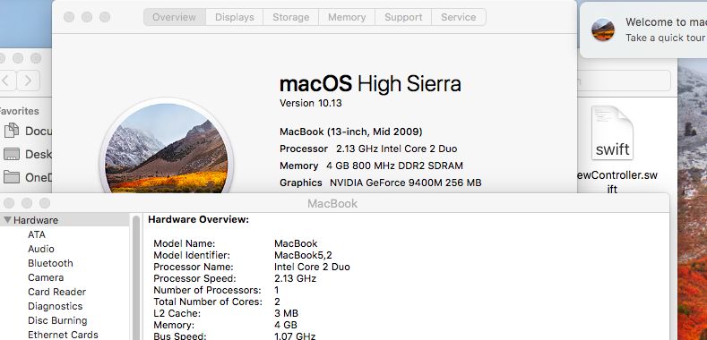

According to every Mac it says the identifier is 5,2 for MacBook. It also lists A1181 MC240LL/A. Etc. so what is it then ? , https://everymac.com/systems/apple/...-duo-2.13-white-13-mid-2009-nvidia-specs.html
[doublepost=1506603571][/doublepost]
There is no such thing as a mid 2009 MacBook5,2. Furthermore, there are issues with MacBook5,2. Do you mean mid-2009 MacBookPro5,2?
dosdude1's patches fixed the issues like the backlight not working and the volume button not working. Since I'm not sure why people don't know what a mid 2009 MacBook 5,2 is here's a screen clip from my system report and about this Mac. Its the one right before the unibody:

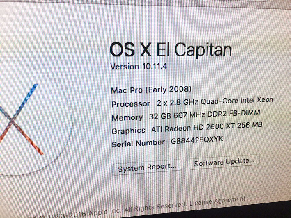

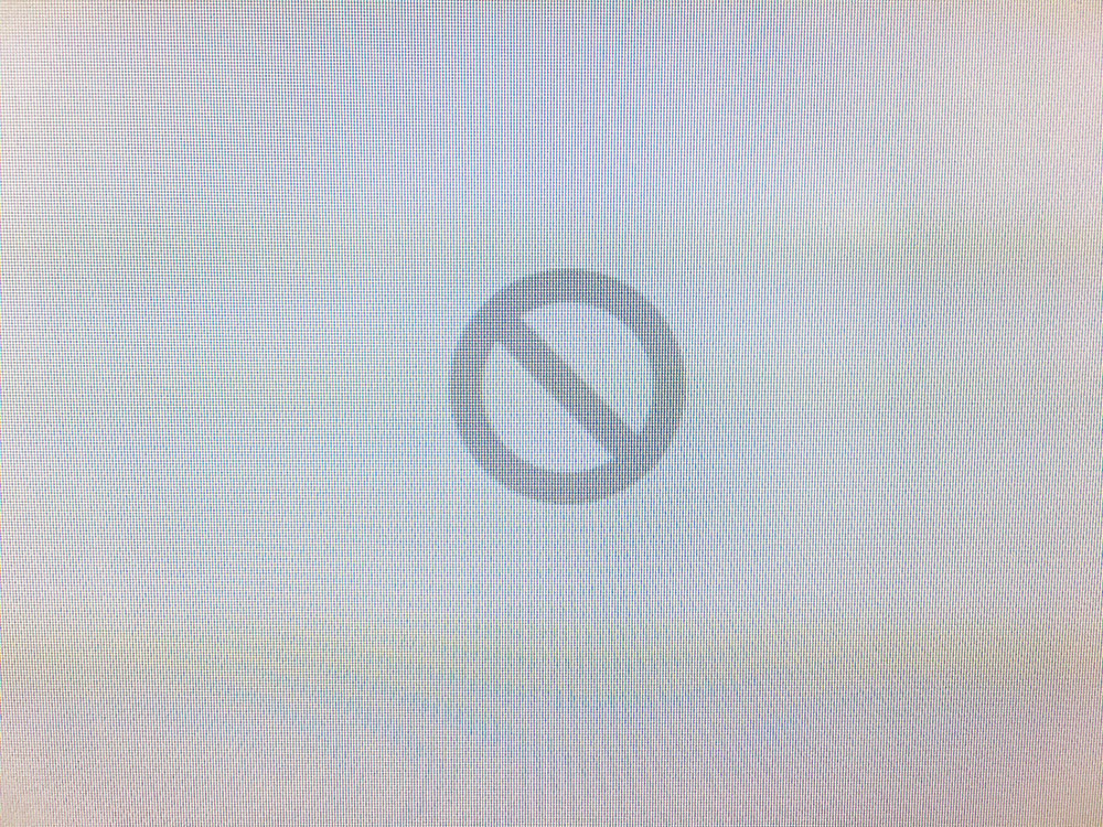

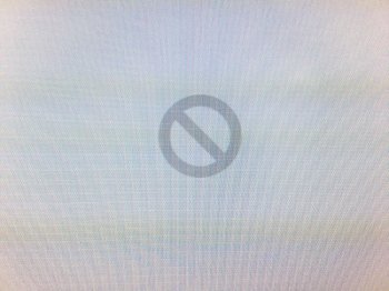

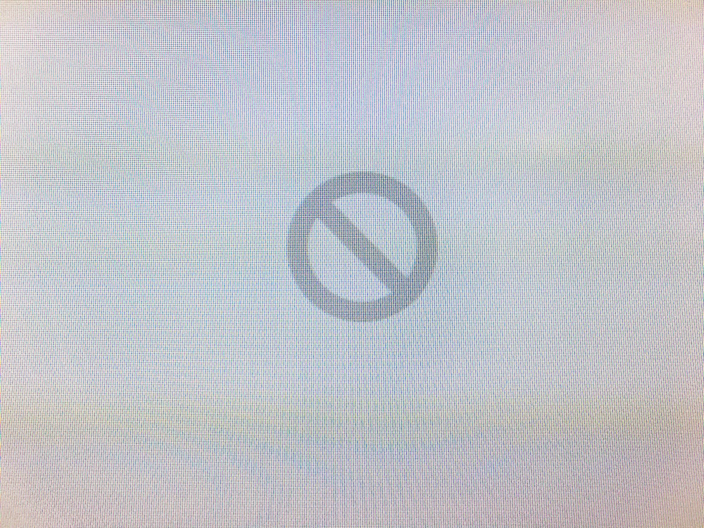

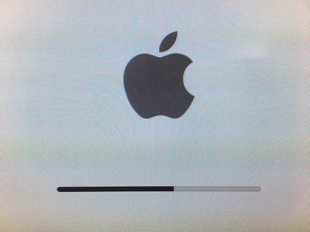

So, I am having an issue booting off the USB. I have a MacPro 3,1 and I created the USB with the latest tool (2.3.2) and downloaded the HS GM within the patcher tool.
When I boot off the USB it goes a little more than halfway on the boot progress before it gives me the big "NO" Icon.

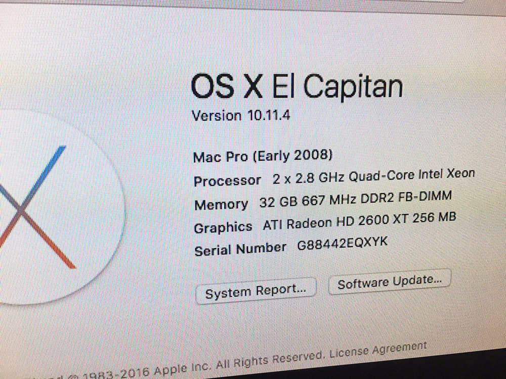

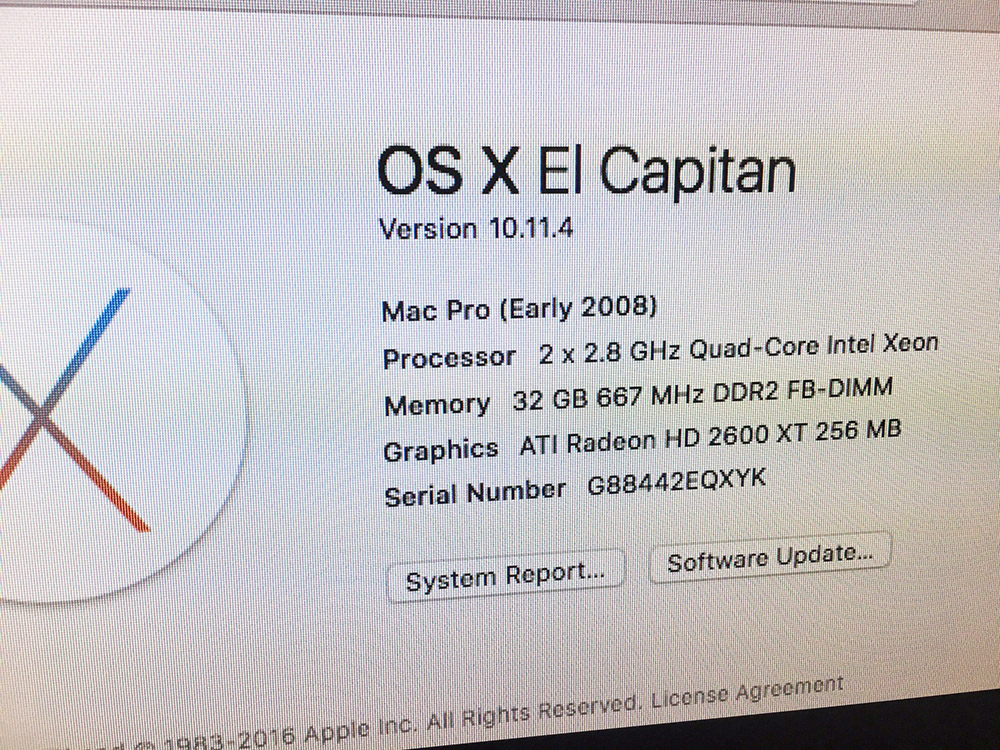

Details about my system are in the screenshots. Only one HD (My 1TB SSD) is plugged into the system and no USB or other hardware.
What could be causing this???

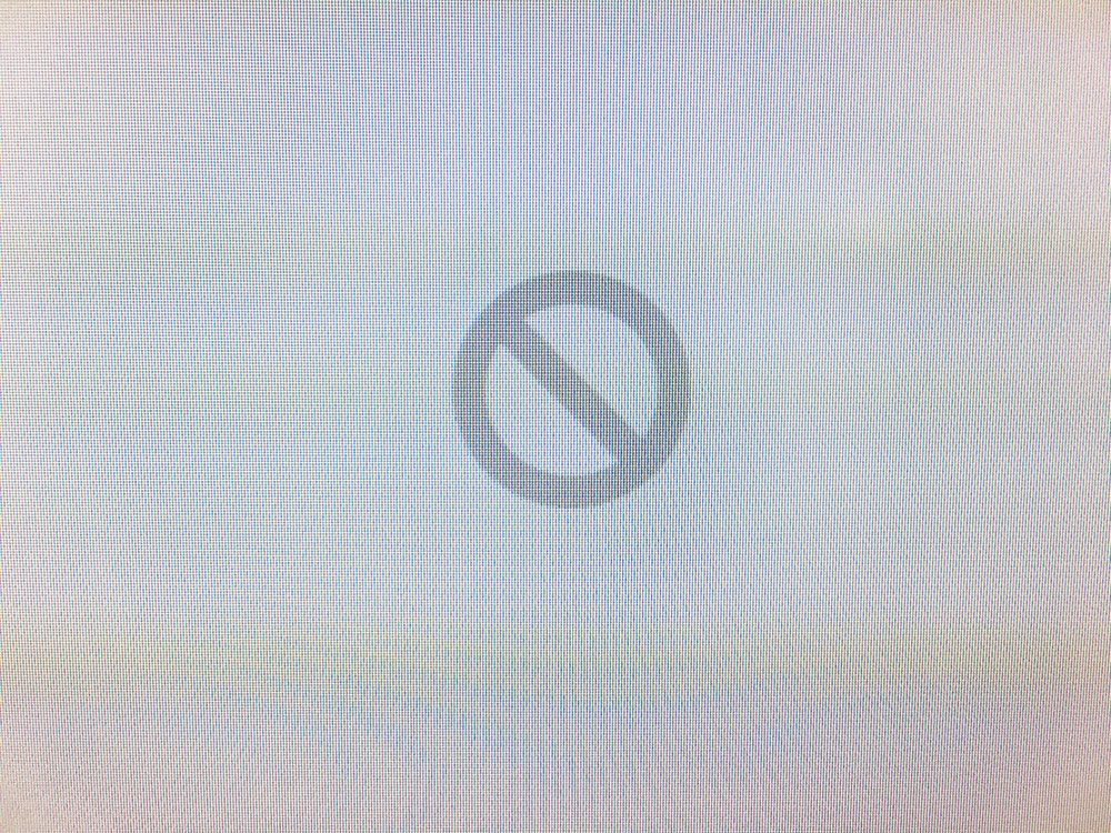

First off, Thanks dosdude1 for making this!
[doublepost=1506622743][/doublepost]I had the exact same issue.
Deleted the Partition on the USB and redid the entire proces again from step 1 and made sure the usb is partioned the correct way on the highest level and then it worked perfectly.
hope this helps.
hope this helps.
Ah I will try that now! thank you. Fingers Crossed.
hope this helps.
Yes! It worked perfectly. Skipped the partition work and installed on entirely different USB and it loaded straight up. Thank you!
