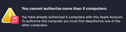

Does playing back music in Apple Music (online/local files) work for all of you?
If not, you can try boot-arg unfairvga=7
I don't use it, but I opened the Music app on my HackMini8,1 (hackintosh without T2 chip configured with SMBIOS MM8,1) and unpurchased song samples play without issues.
EDIT: I'm not an Apple Music expert, so forgive a naive question: could this be the problem?

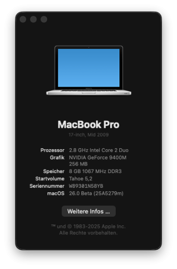

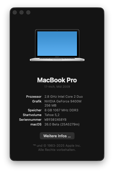

MBP5,2: Tahoe installed OK from USB installer over Sequoia 15.5 on external SSD.
Don't get beyond the login yet (pw entered but then no progress). Will try a fresh install.
EFi used: generated with OCLP 2.4.0 then modified as deveedee describes in post #67, ie mostly OC 1.0.5 beta and the extras in Info.plist of USB-Map.kext. - This EFI can also boot Sequoia as deveedee noted earlier.
Thank you all for encouragement and help... next will try to get MBP11,1 going.

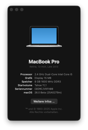

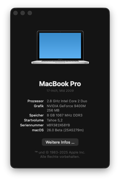

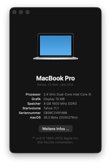

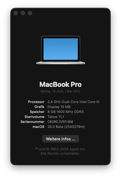

MBP11,1 and MBP5,2: success with installing, booting and logging into Tahoe 26b1.
In both cases, using external SSD connected to onboard USB and made clean install (of 15.5 then 26 atop). EFIs generated with OCLP 2.4.0 and modified in-place (on target SSD) to use OC 1.0.5 and the respective Info.plist in USB-Map.kext. Thanks again deveedee and others! See post #67.

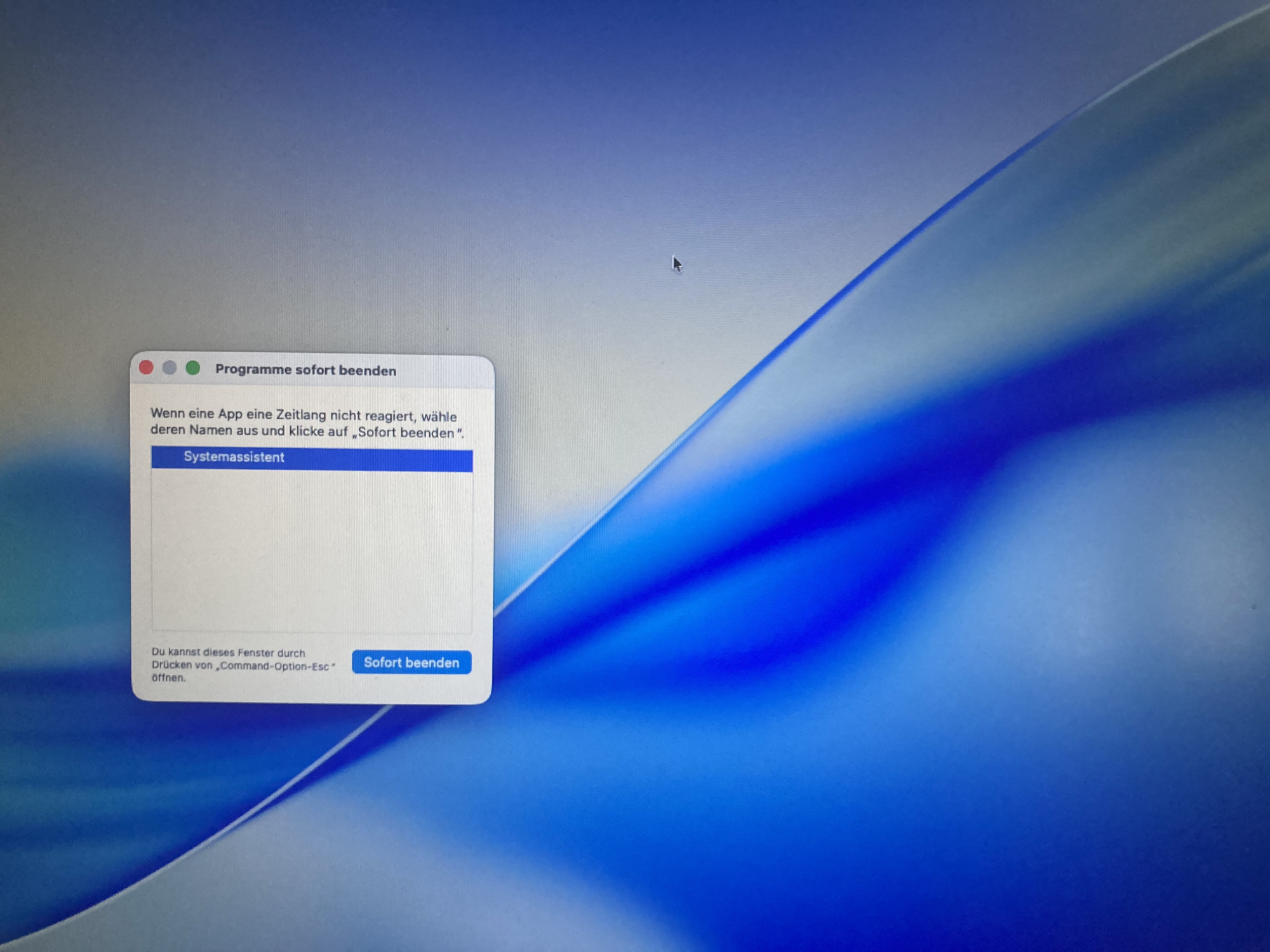

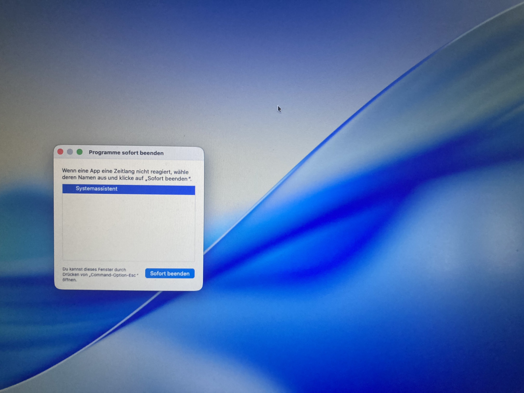

Also in both cases, needed to first install Sequoia 15.5 from USB installer, and do all the fresh setup (no data migration), and then install 26b1 over it from USB installer. Without first having Sequoia, after clean install of 26b1 I was unable to proceed beyond login as it seemed that system assistant got stuck (3rd picture, from MBP5,2) - maybe it would just have taken longer than the 1hr I waited. Thanks to Larsvonhier for his remark earlier in the Tahoe posts.
So far so good or even excellent for this 1st beta - didn't expect more at this point.

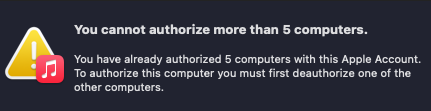

No, that's an issue that can be resolved by resetting that counter by accessing Music/Account/Authorisation/(De)authorise. If I am not mistaken this can be done accessing AppleID using Safari and the related web app as well. The latter would give more options to deauthorize more devices in one go as far as I remember.
