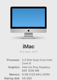

I just learned of the new MacOS and am interested in seeing if this will install cleanly onto my 2017 12-inch i7 MacBook. I plan to give this a try using the current version of OCLP and see what happens. I will report my findings once done . . .
As I had expected Tahoe Beta 1 does not work on the 2017 MacBook. It will start installing and then when the first reboot occurs, the laptop just hangs with the Apple logo against a black screen and no update on the status bar below.
I know we are not supposed to try installing Tahoe until the OCLP developers have made a version which will allow installation and patches for a functioning MacOS 26 build on the computer. It has been put out many times so I understand. My MacBook is one of many spares I have on hand and for me the risk was the install won't work and I will have to reformat the SSD and reinstall everything. No big deal but at least I know it is not worth trying to install an OS that, even if it installs, will have very limited functionality due to no available patching at this moment.
With this said, I will wait until there is a compatible OCLP version in which I will then be able to install MacOS 26 onto my MacBook. I do look forward to reading how everyone is doing in their efforts to have this OS work on their laptops. :apple:

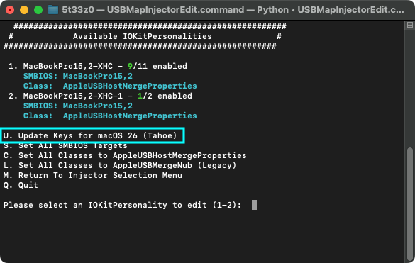

Regarding USB Port issues. The following strings need to be modified in the info.plist of the USBMap.kext in order for it to work in macOS Tahoe:
  • CFBundleIdentifier: Set to com.apple.driver.AppleUSBHostMergeProperties
  • IOClass: Set to AppleUSBHostMergeProperties
  • IOProviderClass: Set to AppleUSBXHCIPCI
  • Under ports:
    • Change every instance of port to usb-port-number. This is critical due to Apple’s updated USB architecture in macOS 26.
Ideally, you would duplicate your existing kext, rename it to USBMap_Tahoe for example. Then add it to EFI/OC/Kext and your config an change the MinKernel version to 25.0.0. Next, change the MaxKernel version of the USBMap.kext to 24.9.9 for other macOS versions.
My guess is that scripts like USBMap and USBToolbox will include mapping options for generating 2 types of kexts in the furture: pre Tahoe and Tahoe.

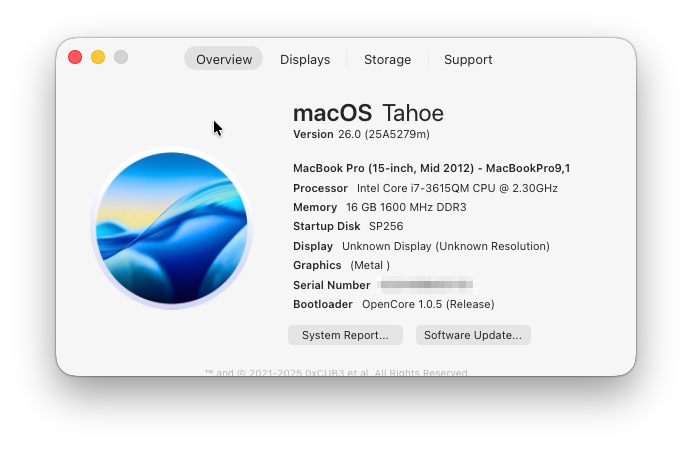

I'm sure we'll be learning more about what changes are actually required. I modified my original USBPorts.kext by only adding usb-port-type and usb-port-number to each port. I set usb-port-type equal to the value of portType or UsbConnector and usb-port-number equal to the value of port.
I did not need to change CFBundleIdentifier (com.apple.driver.AppleUSBMergeNub works fine), I did not need to change IOClass (AppleUSBMergeNub works fine) and I did not need to change IOProviderClass (AppleIntelCNLUSBXHCI works fine).
After I realized what CorpNewt's USBMap tool was doing, I started with my original USBPorts.kext generated by Hackintool and added usb-port-type and usb-port-number to each port. No other changes.
I left the original properties in place, so that the same port mapping kext works for Big Sur through Tahoe.
EDIT: With this simpler solution, there is no reason for the USB mapping tools to generate 2 types of kexts and no reason we'll need to use Min/Max Kernel settings.

@hvds I generated your MBP5,2 USB-Map.kext using OCLP 2.4.0 and I see the problem. OCLP does not include the CFBundleIdentifier et. al. in the Info.plist. Spoke too soon. I didn't look closely enough. You should be able to add usb-port-type and usb-port-number to the OCLP-generated map to produce a working map for Tahoe.
Successful installation! Of course there's not much that works properly: everything is very slow, the trackpad pointer is erratic, no wallpaper, lots of display problems, no wifi or bluetooth (normal, unpatched system), but I've got ethernet.
What unblocked the situation: modifying the info.plist file of USB-MAP.kext as @deeveedee suggests and installing OpenCore 1.0.5 instead of the 1.0.4 currently used by OCLP.
This gives me hope my iMac will get supported. Sequoia runs smoothly the only limiting factor is the 8GB of RAM.

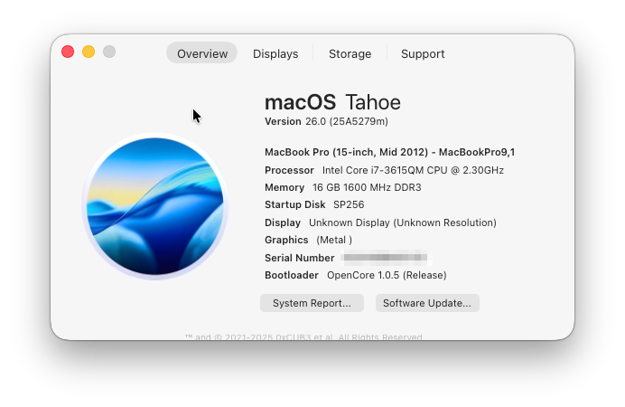

I succesfully installed MacOS Tahoe, with OpenCore efi 1.0.5 from the installed (through OpenCore Legacy Patcher installed) 1.0.4 version. I can’t turn on/activate Wi-fi. Does anyone have any idea?
MacBookPro 14,3
Thank you. Doesn‘t work yet but I guess I need to use OC 1.0.5 beta still… will try later.

I just saw that USBMap also contains a script called USBMapInjectorEdit.command.
Run it and drag your USBMap.kext into the Terminal window. In the main menu all you have to do is press "u" and enter on the keyboard to update the relvevant entries of the info.plist – that's it.
