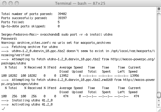

Getting closer :)
port -v -b install utdns
---> Fetching archive for utdns
---> utdns-1.2_0.darwin_10.ppc.tbz2 doesn't seem to exist in /opt/local/var/macports/incoming/verified
---> Attempting to fetch utdns-1.2_0.darwin_10.ppc.tbz2 from http://macos-powerpc.org/packages/utdns
% Total % Received % Xferd Average Speed Time Time Time Current
Dload Upload Total Spent Left Speed
100 10202 100 10202 0 0 13584 0 --:--:-- --:--:-- --:--:-- 13584
---> Attempting to fetch utdns-1.2_0.darwin_10.ppc.tbz2.rmd160 from http://macos-powerpc.org/packages/utdns
100 256 100 256 0 0 740 0 --:--:-- --:--:-- --:--:-- 739
Warning: Failed to verify signature for archive!
Error: Failed to archivefetch utdns: version @1.2_0

I guess you either do not have the pem key in /opt/local/etc/macports/pubkeys.conf (path to it) or the key file in a location which is pointed to.
This may happen if you had MacPorts conf files before installing my version. I think MacPorts does not overwrite existing configs.
This is the assumed path: /opt/local/share/macports/macos-powerpc-pubkey.pem
I hope the file itself gets installed anyway, so the problem is likely with the pubkeys.conf.
I will add this to instructions later, but just in case so that these are not forgotten, some – rather random – notes:

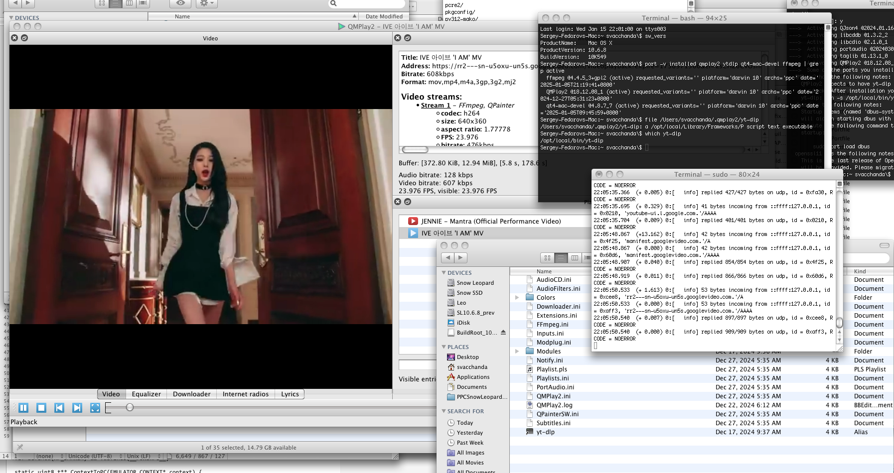

5. For video: the best option is QMPlay2. VLC, mpv and mplayer are a waste of time.

Everything is up to date when when I try to install QMPlay2 I run into issues.
$ sudo port -vb install QMPlay2
Warning: depends_libs change: path:lib/libQtCore.4.dylib:qt4-mac
Warning: Using the mainstream/official Qt4 portgroup
---> Computing dependencies for QMPlay2.Warning: Using the mainstream/official Qt4 portgroup
..........^CError: Aborted: SIGINT received.

Ok, thank you, now I know the problem.
Let me push a fix.
Do not run port sync, I will just handle a fixed version and you can do `portindex` instead, to save time.
UPD. Could you please open your `qt4-mac-devel` portfile and just replace its text with https://raw.githubusercontent.com/m...91140a1ebdbfeeb43/aqua/qt4-mac-devel/Portfile
I removed usage of that portgroup, but used an earlier version of this portfile in some of recent updates when trying to handle rsync and indexing. Sorry.
Then `cd /opt/local/var/macports/sources/macos-powerpc.org/macos-powerpc/PPCPorts/ports` and `sudo portindex`. (This will avoid syncing ports from online sources and just add the missing one locally.)
Let me push a fix.

BTW, does YouTube work from within the app? (Low resolution on streaming playback is expected at the moment, it is not a PowerPC issue.)
It doesn't. I can see them in the list but they won't play. That yt-dl thing is constantly being updated.
Did you do what is written in the port notes?
You should delete a copy of yt-dlp from ~/.qmplay2 and make a symlink to MacPorts version instead.
rm ~/.qmplay2/yt-dlp
cd ~/.qmplay2
ln -s /opt/local/bin/yt-dlp .
Writing this from memory, but I think it is correct.
I have just checked, everything works as expected on my end:
I did that. It can't open the files. If I run yt-dl on a URL I can play on my macbook it fails as well.
$ yt-dlp BtV_nQKhkdY[/MEDIA]
[youtube] Extracting URL: BtV_nQKhkdY[/MEDIA]
[youtube] BtV_nQKhkdY: Downloading webpage
[youtube] BtV_nQKhkdY: Downloading ios player API JSON
[youtube] BtV_nQKhkdY: Downloading mweb player API JSON
[youtube] BtV_nQKhkdY: Downloading player 0b866fa6
[youtube] BtV_nQKhkdY: Downloading m3u8 information
[info] BtV_nQKhkdY: Downloading 1 format(s): 397+251
ERROR: unable to download video data: HTTP Error 403: Forbidden
$ yt-dlp
Sorry, I do not really understand what “It can't open the files” means exactly. Could you make a screenshot of the error you get from QMPlay2, when you try opening some YouTube video (from within the app itself)?
Also, the output of `port -v installed QMPlay2 yt-dlp ffmpeg | grep active`.
