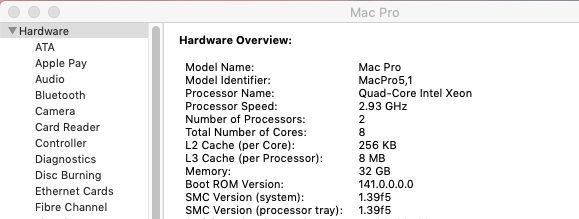

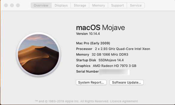

MIKX
macrumors 68000
Dec 16, 2004
1,815
691
Japan
Apologies to this thread's participants for creating any negative feelings re: the 10.14.4 release.
Had a long hard week & not looking forward to my 70th. B'day this year plus there seemed to an onslaught of negative threads appearing so suddenly. The bricking of a fair few cMPs didn't help either.
Anyway, I successfully installed 10.14.4 along with the 141.0.0.0 bootrom - everything seems to be working.
I did a clean install to a 480gb SanDisk SSD.
Tomorrow I'll try CCC cloning 10.14.4 to a Samsung 960 EVO HFS format.
PS : I had absolutely no idea that I could now boot ( & install Mojave ) from my Sandisk SSD in an external USB 3.0 dock. Must have missed those posts regarding this.

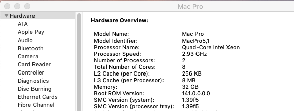

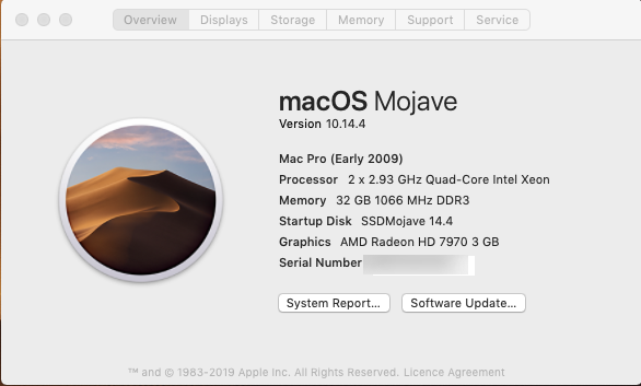

trifero
macrumors 68030
May 21, 2009
2,962
2,803
View attachment 829088 View attachment 829087

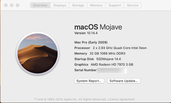

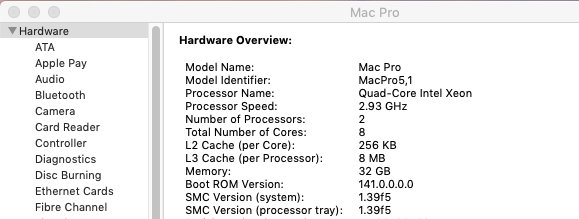

MIKX
macrumors 68000
Dec 16, 2004
1,815
691
Japan
EDIT : Seems I was wrong ( at 4:30 am . .yawn ) I had TWO drives with the same name .. the Sandisk SSD was connected to my PCIe Inateck external USB 3.0 dock the other was a 960 EVO NVMe M.2
Sorry for the confusion. Gotta get to bed earlier.

Updated from 140 to 141, no problems. I'm still using Sierra so I have a basic High Sierra install on an external SSD that I boot from and upgrade the BootROM using that.
