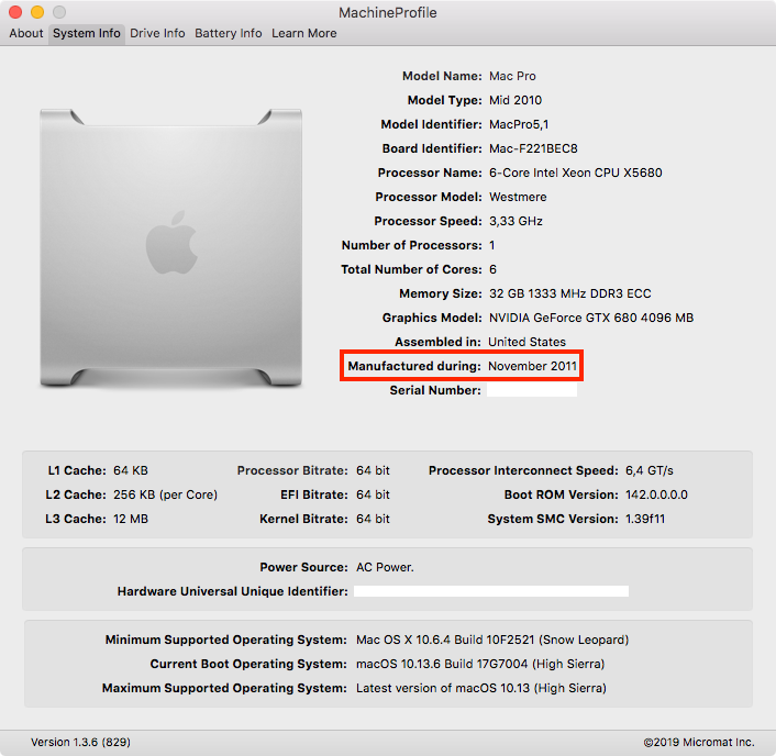

Anyone here has a mid-2012 Mac Pro built in the second semester of 2013? I only have 3 dumps of mid-2012 Mac Pros made after July 2013 and I need more.
Seems that the last ones have a newer hardware descriptor and I only found one example until now.
Usually mid-2012 Mac Pros have the Base_21 descriptor with this header/version:
Code:
01050000 00000809
I have a dump that still has the Base_21 but with this header/version:
Code:
01060000 00000809
If anyone have mid-2012 with 2013 build dates and could PM the dump, preferably later build dates, I'll be grateful. No need to send it again if you ever sent it before.
The easiest way to check is running MachineProfile:
[doublepost=1554028890][/doublepost]Btw, refurbished 5,1 Mac Pros have different headers/versioning, usually 010A thru 010D. This one is from a mid-2012 refurb:

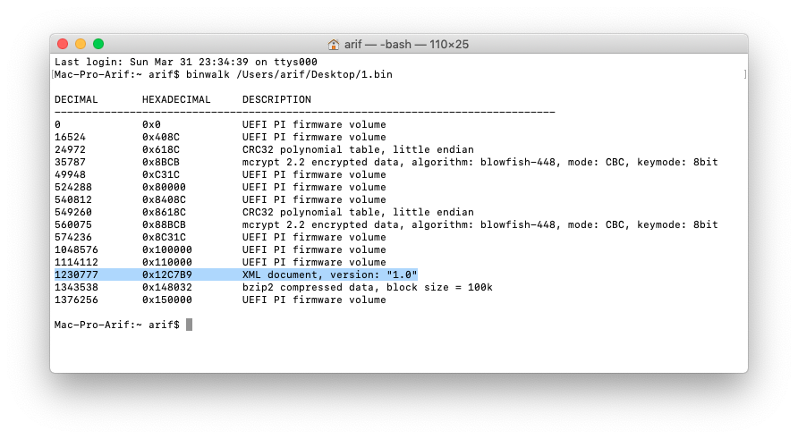

Hello! I want to analyse my bootROM.
The steps i did:
1. disable SIP
2. run ROMTool, dump rom
3. rom saved at the desktop with name MyRom.bin
4. Binwalk installation
In terminal i wrote ruby -e "$(curl -fsSL https://raw.githubusercontent.com/Homebrew/install/master/install)" < /dev/null 2> /dev/null
then
brew install binwalk
5. what to do next?
Found this post by tsialex
"Binwalk is a very complex tool to use and you have to know how to interpret the output.
The most basic way to use it is just:
command + filename of the file that you want to analyse
Code:
binwalk BootROM_dump.rom
This is almost useless, but shows the MS X509 certificates."
But the dump i extracted with ROMTool has an extension .bin not .rom
The steps i did:
1. disable SIP
then
5. what to do next?
Found this post of tsialex
Code:
.rom = .bin
