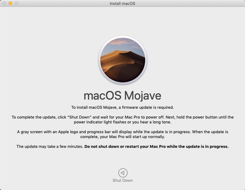

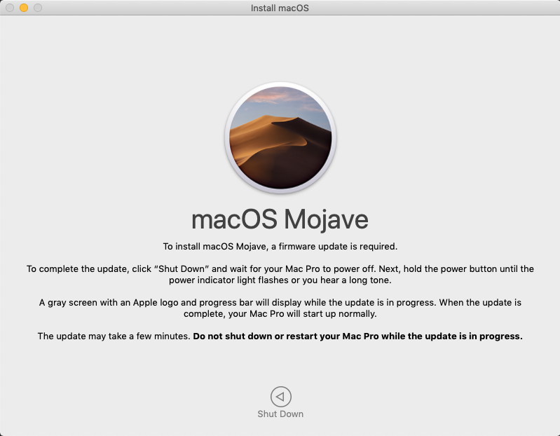

Download the FULL INSTALLER for macOS Mojave 10.14.4 and a window like this will appear:
Click shut down. Enter your password. Wait for shut down. Wait 1 minute. Press AND HOLD power button on front of tower. Wait for chime AND WAIT ANOTHER 15 SECONDS before releasing from power button hold. CD/DVD drive will open. Computer will cycle and then restart.
The ONLY difference with Mojave is the full installer is harder to obtain. That's it. It's the same process that's been used for many previous OS releases with firmware updates.
