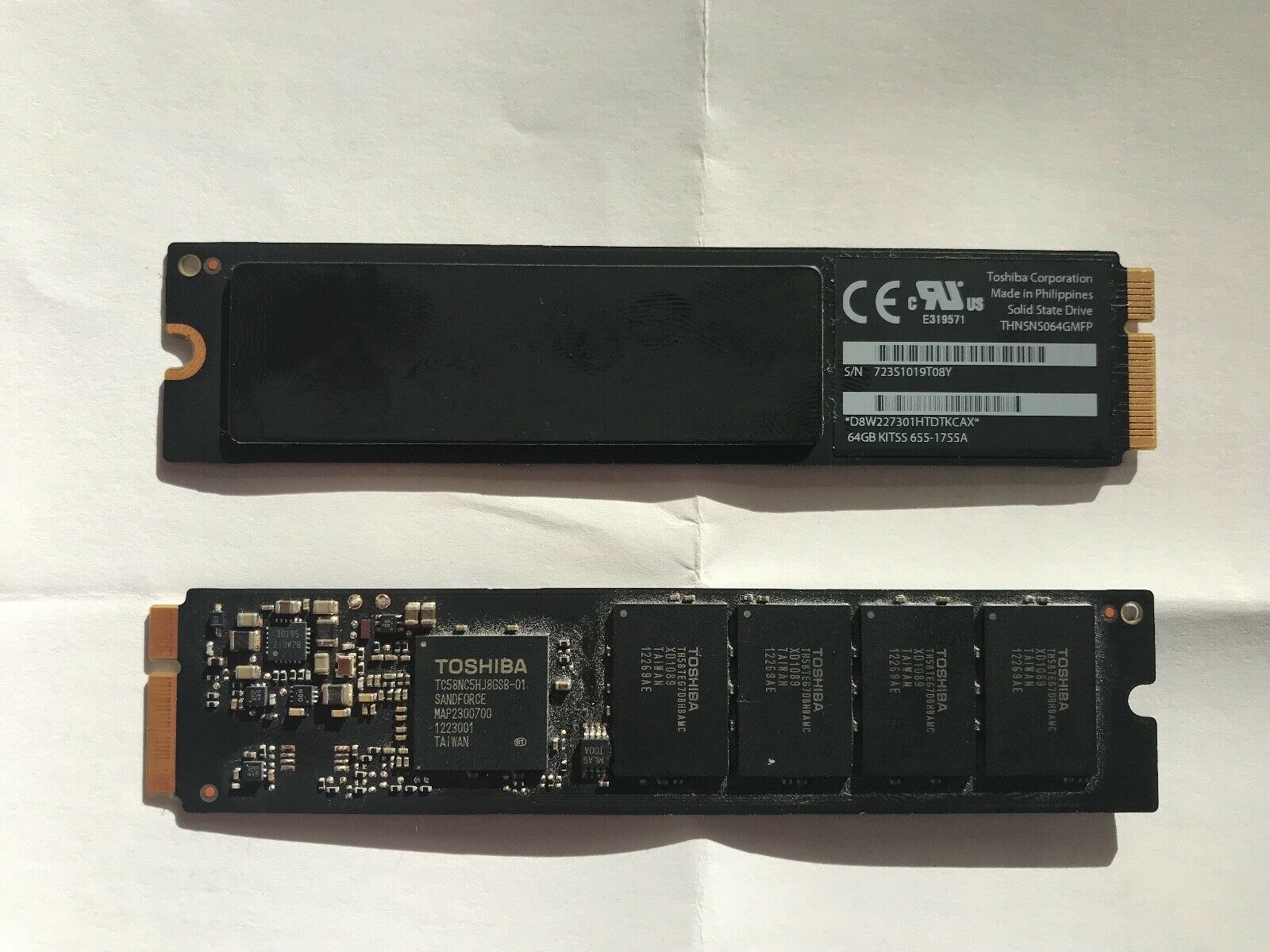

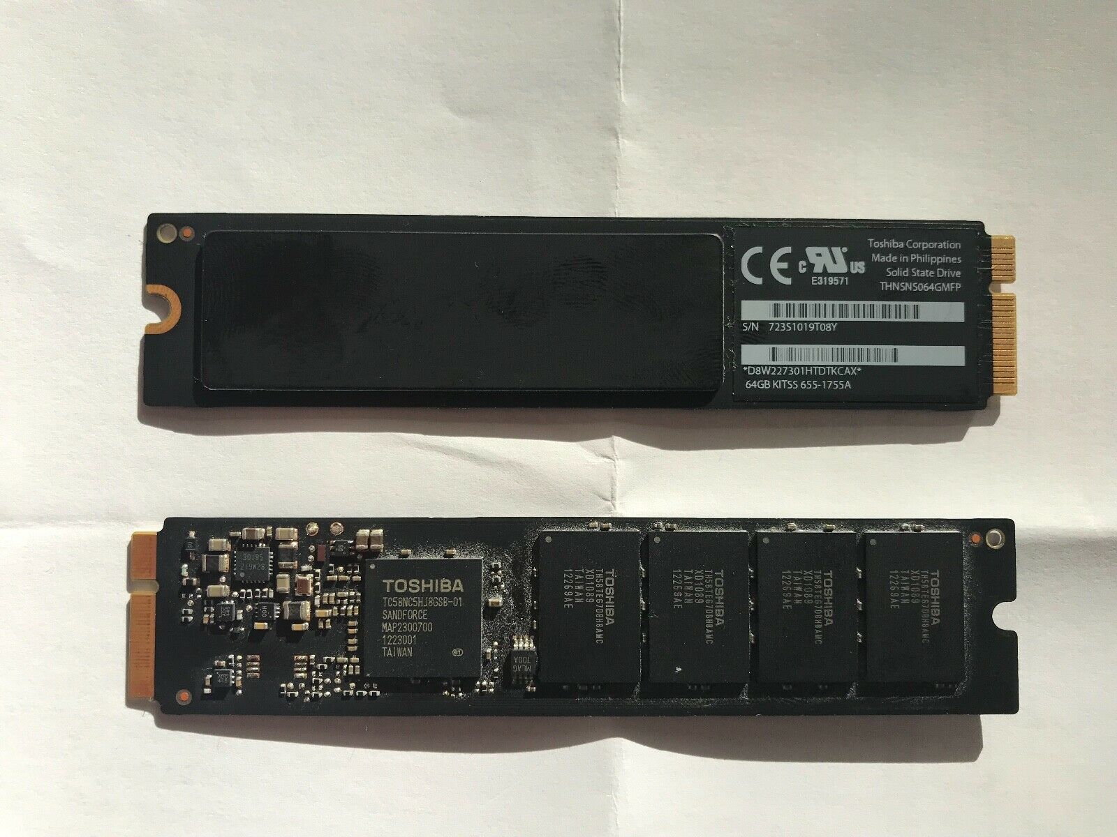

Alex this is 64gb for macbook air *2012* 11" 13" A1465 A1466 . You think i can use to update my firmware? I find cheap in eBay
These are SATA, with a totally different conector.

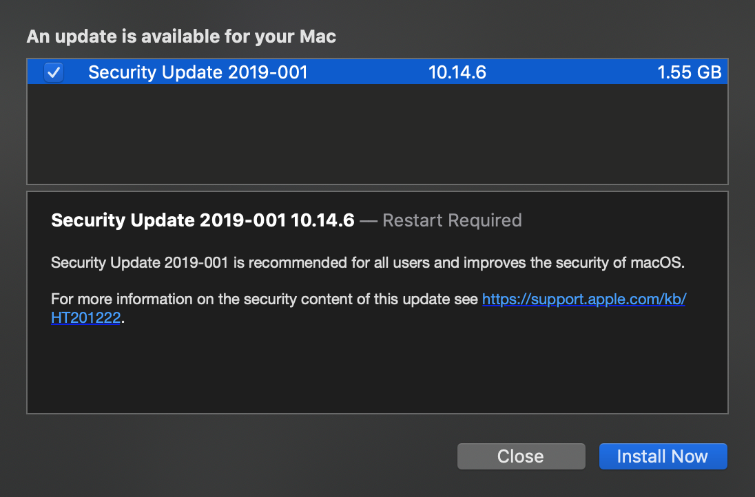

Applied the Security Update 2019-001 for macOS 10.14.6 on my Mac Pro 5,1 and it's still the same at 144.0.0.0.0
Tried upgrading an Early 2015 rMBP to 10.15.1, don't see any changes, still 187.0.0.0.0 as it was before in 10.15.0.

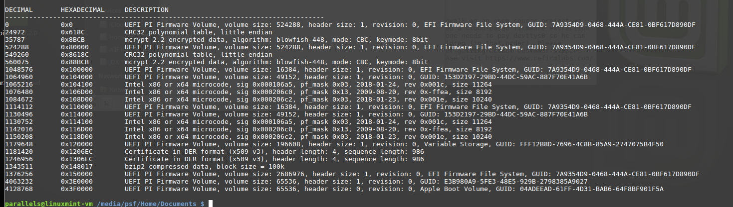

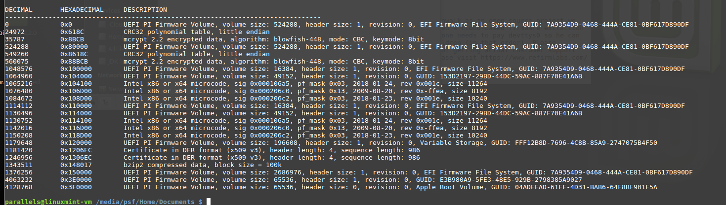

For MP5,1 as far as i know FW updates are only applied by the full installer. Correct me if i am wrong.
MP5,1 probably won’t get a new firmware update, unless Apple send a stand-alone version, since Catalina don’t support it and we won’t see a 10.14.7 release.
From 10.15.0 to 10.15.1, the only firmware upgrade for non BridgeOS Macs was for iMac19,1, from 1037.0.73.0.0 to 1037.40.118.0.0.
Firmwares creation date for 10.15.1 was October 11.

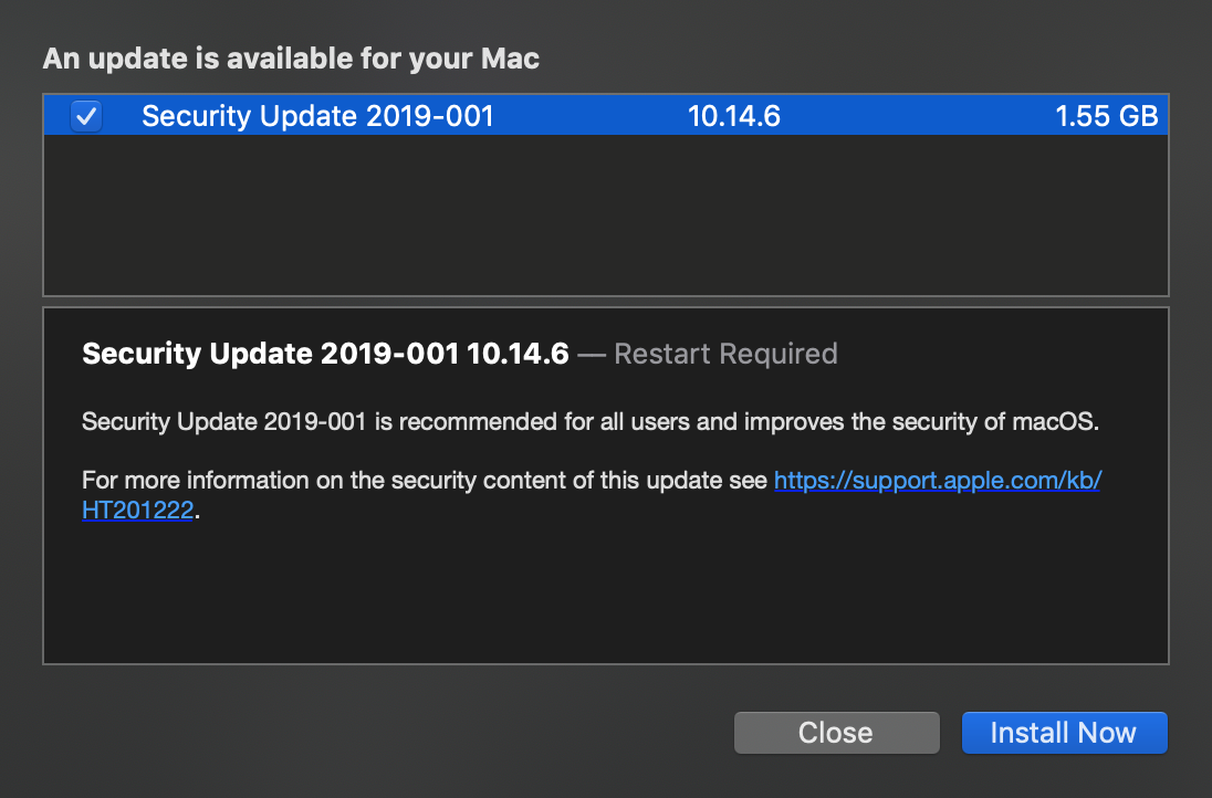

Looks like this update was released, re-released, newly released, mis-labeled, or something...
I'm currently on 10.14.6 (18G103) and was just alerted about this update's availability. Will update with build number after install in a little bit.

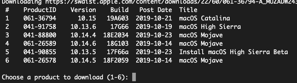

Currently available versions from script:
Code:
 #    ProductID    Version    Build   Post Date  Title
 1    041-91758    10.13.6    17G66  2019-10-19  macOS High Sierra
 2    041-83630    10.15.1    19B88  2019-10-29  macOS Catalina
 3    061-26589    10.14.6   18G103  2019-10-14  macOS Mojave
 4    041-88800    10.14.4  18E2034  2019-10-23  macOS Mojave
 5    041-90855    10.13.5   17F66a  2019-10-23  Install macOS High Sierra Beta
 6    061-26578    10.14.5  18F2059  2019-10-14  macOS Mojave
This update was released last week and then republished overnight. The build number remains at 18G1012 both before and after today's republishing of the update. Apple generally does not release new full installers that incorporate security updates so the installer showing in the catalog is unlikely to ever by anything beyond 18G103.

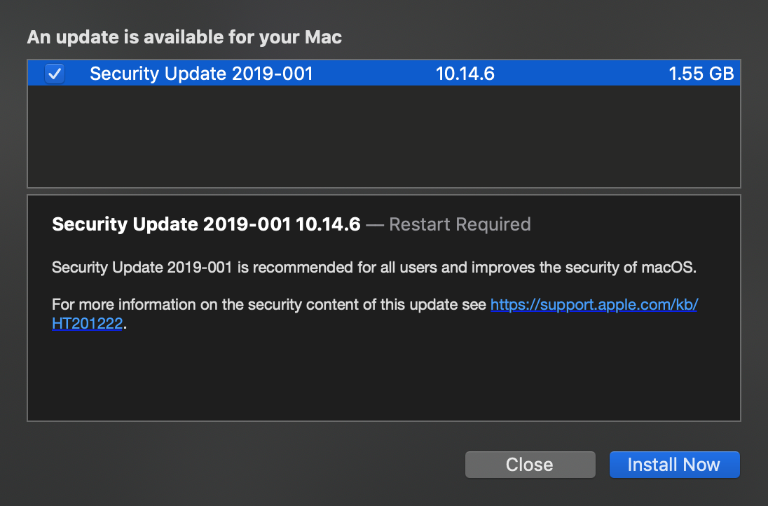

Yes, Apple reissued the last security updates and 10.15.1 yesterday. Even the full installer for Catalina 10.15.1 was re-issued yesterday afternoon.
