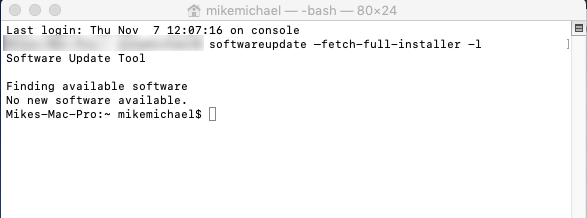

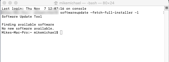

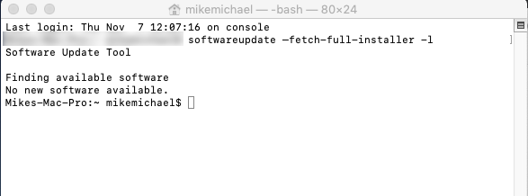

Does this show anything in terminal?
Code:
softwareupdate —fetch-full-installer -l
the "fetch-full-installer" functionality in softwareupdate is new to Catalina, and I don't think including "-l" with it does anything.

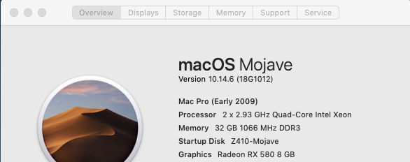

Success !

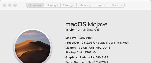

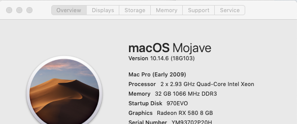

I've been running Mojave 10.14.6 build 18G103 on a HFS+ formatted Samsung 970 EVO M.2 since it was released with out any issues except this Security Update.
I will keep this newly APFS formatted SanDisk Z10 SSD as my " latest Mojave 14.6 backup " and also as a way to install future Mojave Security & any other important updates which are of course nice to have.
From tomorrow I'll CCC clone tonight's APFS installation to another HFS+ formatted SSD and see how stable it is over a month or so. Then, if there have been no issues, I'll clone that to the HFS+ 970 EVO.

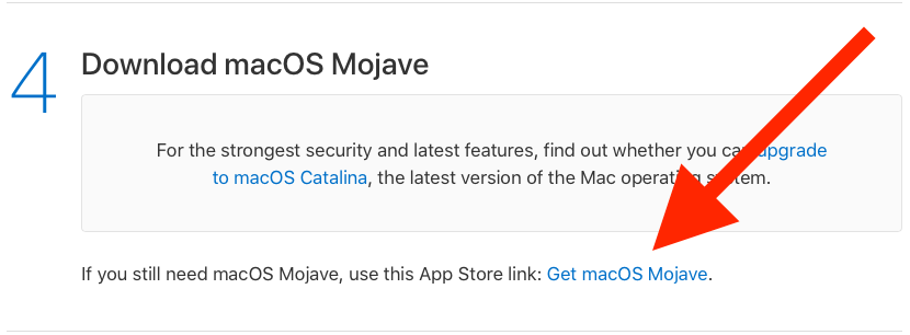

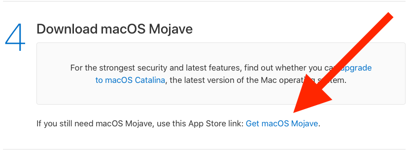

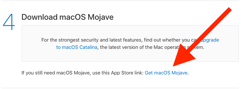

Full Mac App Store installer for 10.14.6. You can get a link here https://support.apple.com/en-us/HT210190

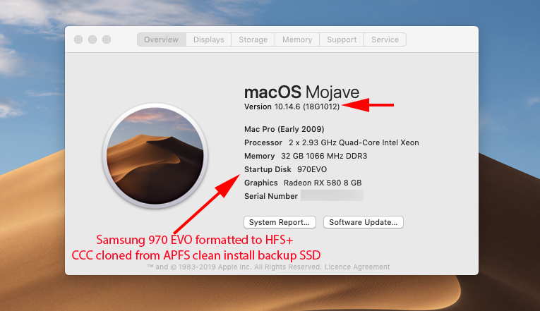

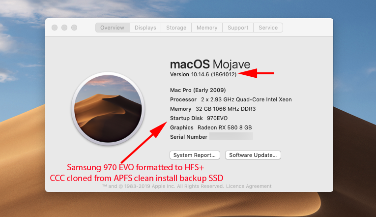

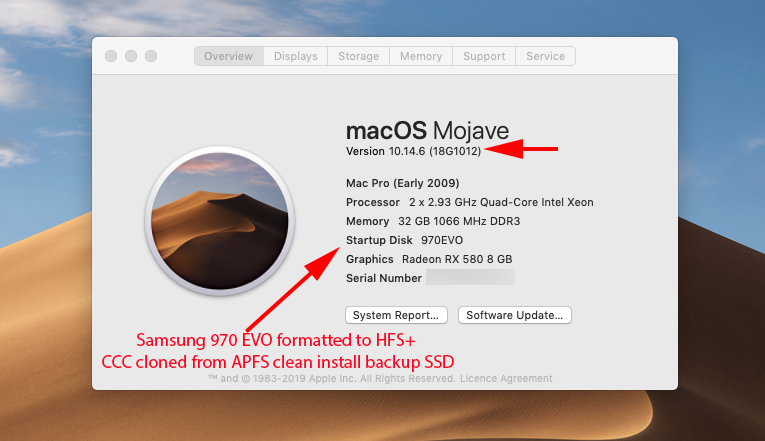

CCC cloned my backup APFS clean install 10.14.6 ( build 18g1012 ) to a spare Samsung 970 EVO formatted as HFS+.
Everything is running cool and fast with no issues at all so far.
'Seems' faster & more responsive than High Sierra. HFS+ install.
