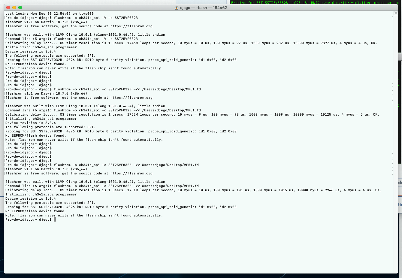

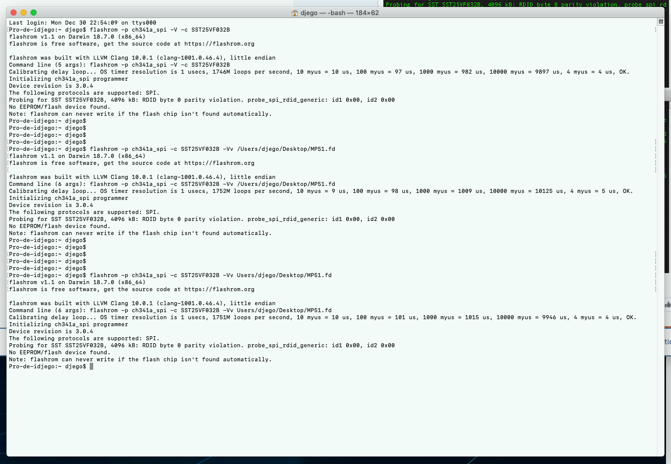

Hi, I already have the chip installed in my CH341A and located the MP51.fd file.
The problem I have is that I don't know how to burn that file. I downloaded the Romtool dosdue1 program, but I don't know if it's correct.
Any help please?
Any help please?
no Romtool is a Tool to program the chip when built in the mac.
You need Flashrom (easiest way is to install homebrew and then brew install flashrom) to use the ch341 programmer.

I have installed brew of that address and I have executed the command that indicates me in the terminal.
I don't see any new applications or what to do
What do I have to do now?
Understand that I have the computer disassembled and for me this situation is complicated
I’ve documented all the steps back in September 2018, see my screenshots.
flashrom is a line of command program, you run it from the Terminal:
screen-shot-2018-09-07-at-08-34-17-png.780084
screen-shot-2018-09-07-at-18-23-45-png.780180

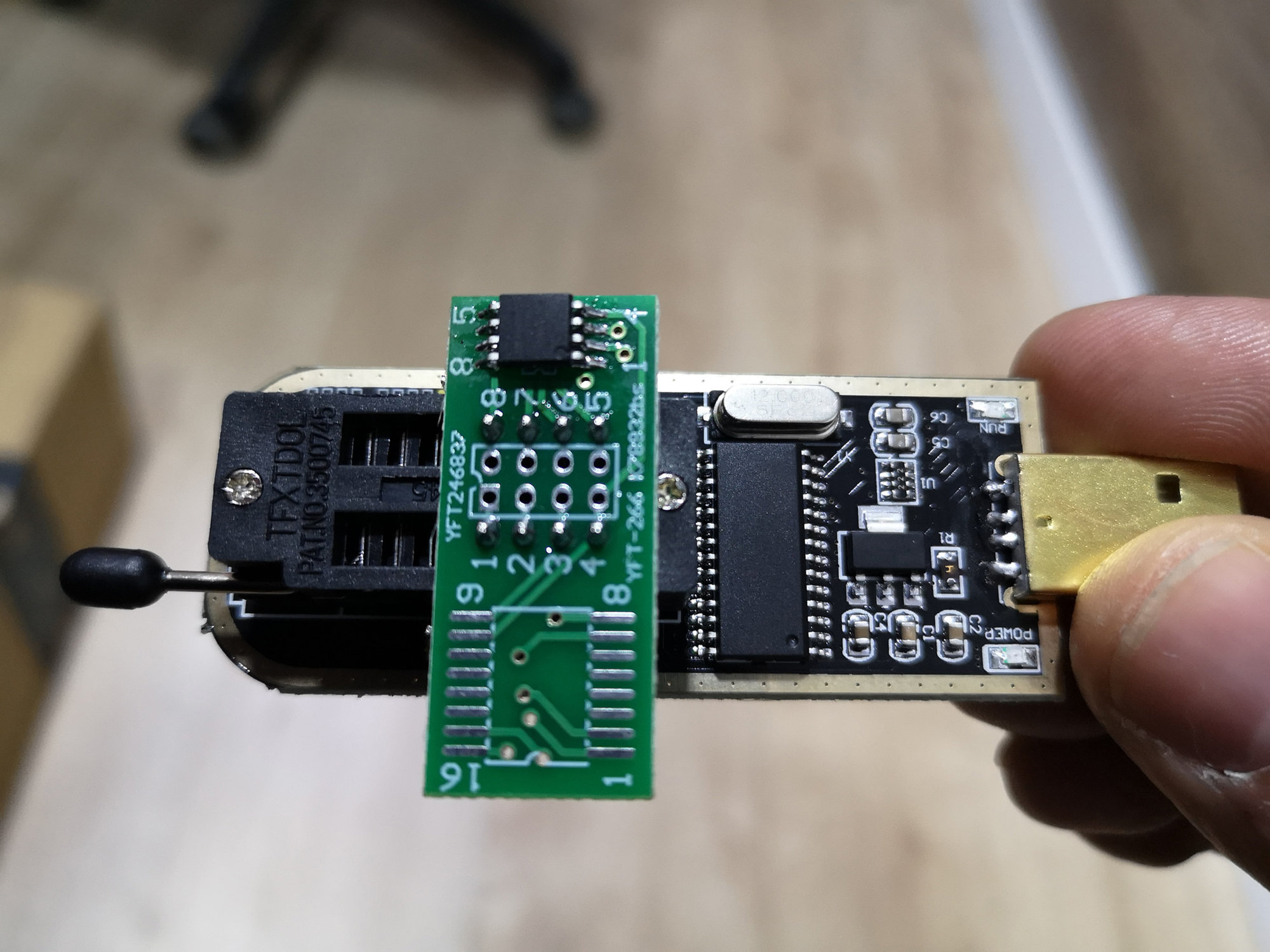

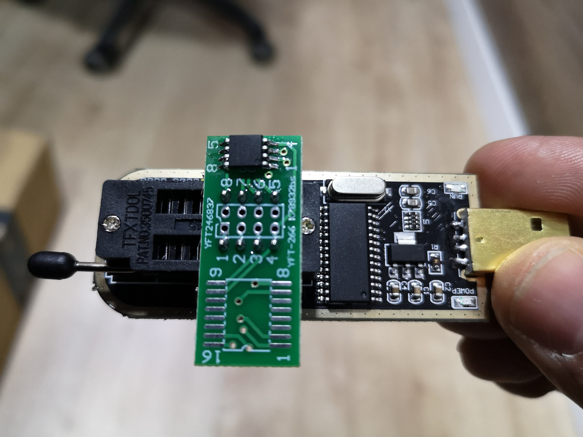

Hello again, I am at the point where I soldered the chip to the adapter, but I think it is not in the correct position, since the chip does not recognize me.
Is the chip well placed?
tsialex
Contributor
Jun 13, 2016
13,455
13,601
It's correctly soldered, but I never used this board.
Btw, Windows ch341a app have a problem to recognise SST25VF032B, use flashrom if you are trying to program one. See #4,061

@tsialex

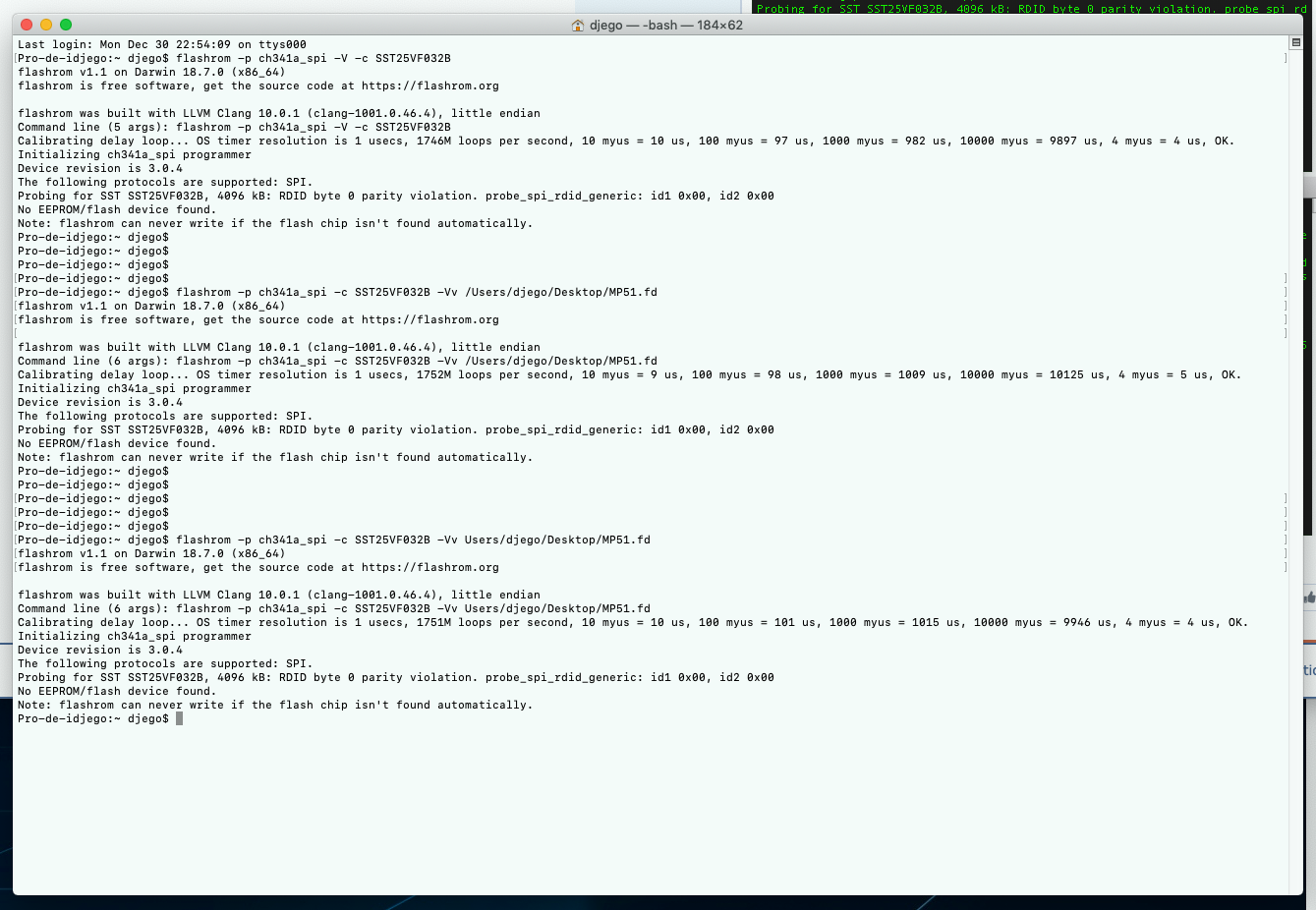

how about the flashrom command to read an SST25VF032B with the ch341a to save the existing bootROM on the chip?
the chip is not soldered on board - the board fails to boot

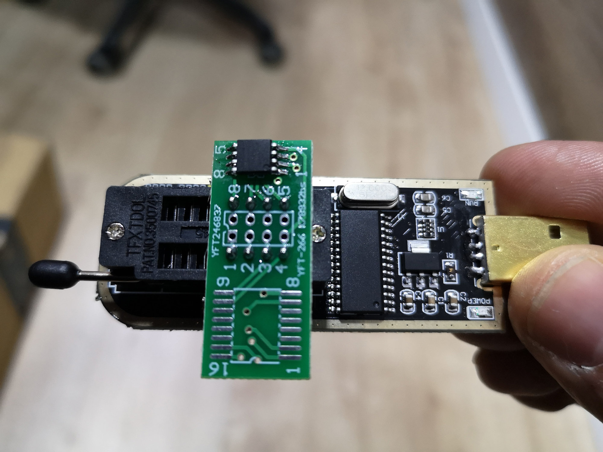

Macschrauber
macrumors 68030
Dec 27, 2015
2,981
1,487
Germany
I use exactly that board, soldered that way. Works.

I followed the instructions but something is wrong
Maybe the chip failed. Test your setup with a know working one.
[automerge]1577743301[/automerge]
@tsialex
man flashrom shows the info page for flashrom. It's the -r option.
