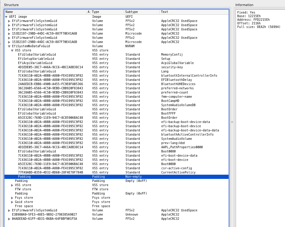

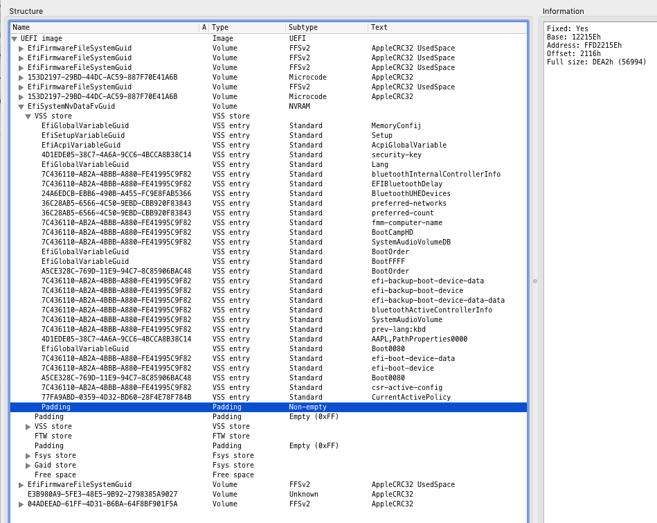

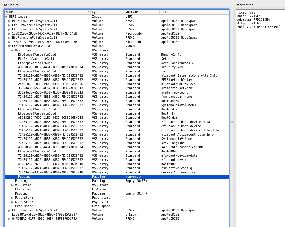

Since I did quite a few tests in my attempts to get a BIOS-boot Windows 10 install to boot off of my second NVMe drive, I can't say for sure when these certificates were added, but I note that the newest RefindPlus release 0.13.0.AG - which I haven't installed yet - includes a fix to "filtering of Windows Secure Boot Certificates on Apple Firmware", so perhaps the NVRAM protection feature wasn't working correctly?
Even more worrying than the X509 certificate entries is the state of my NVRAM. There are no invalid or duplicate entries, but instead of Free Space, there is only padding???
I have no idea if padding instead of free space is an issue, as I've not seen this before and don't remember reading about it anywhere. The second VSS store is identical to the primary one. I now wonder if using RefindPlus circumvents an otherwise unbootable NVRAM store if the "fallback" boot method is used (clearing the blessed boot volume by command-p-r reset to force the Mac to look for bootx64.efi on any EFI partition of connected drives).

When you don't have free space anymore and UEFITool shows only padding, you already partially corrupted the VSS store, garbage collection probably failed and a variable (entry with UEFITool parlance) is now corrupt and being detected as padding space.
Since the NVRAM volume of MacPro5,1 is so tiny for today's usage, the only way to prevent this is to be pro-active and re-flash the never booted BootROM image on a schedule. Nothing will workaround the exiguous NVRAM space, this is a problem long know for some hackintoshes setups and now is a real problem with Mac Pros with more complex configs.

You are correct, the only thing that you are missing is that your dump is from a SPI flash memory that have a decade old NVRAM volume. The NVRAM is a component of the BootROM image and right now you have one that have ten years of usage.
Replacing the SPI flash memory will solve just the SPI flash NAND cells overuse, but still needs a clean-up/upgrade/reconstruction to have a brand new functional BootROM.
