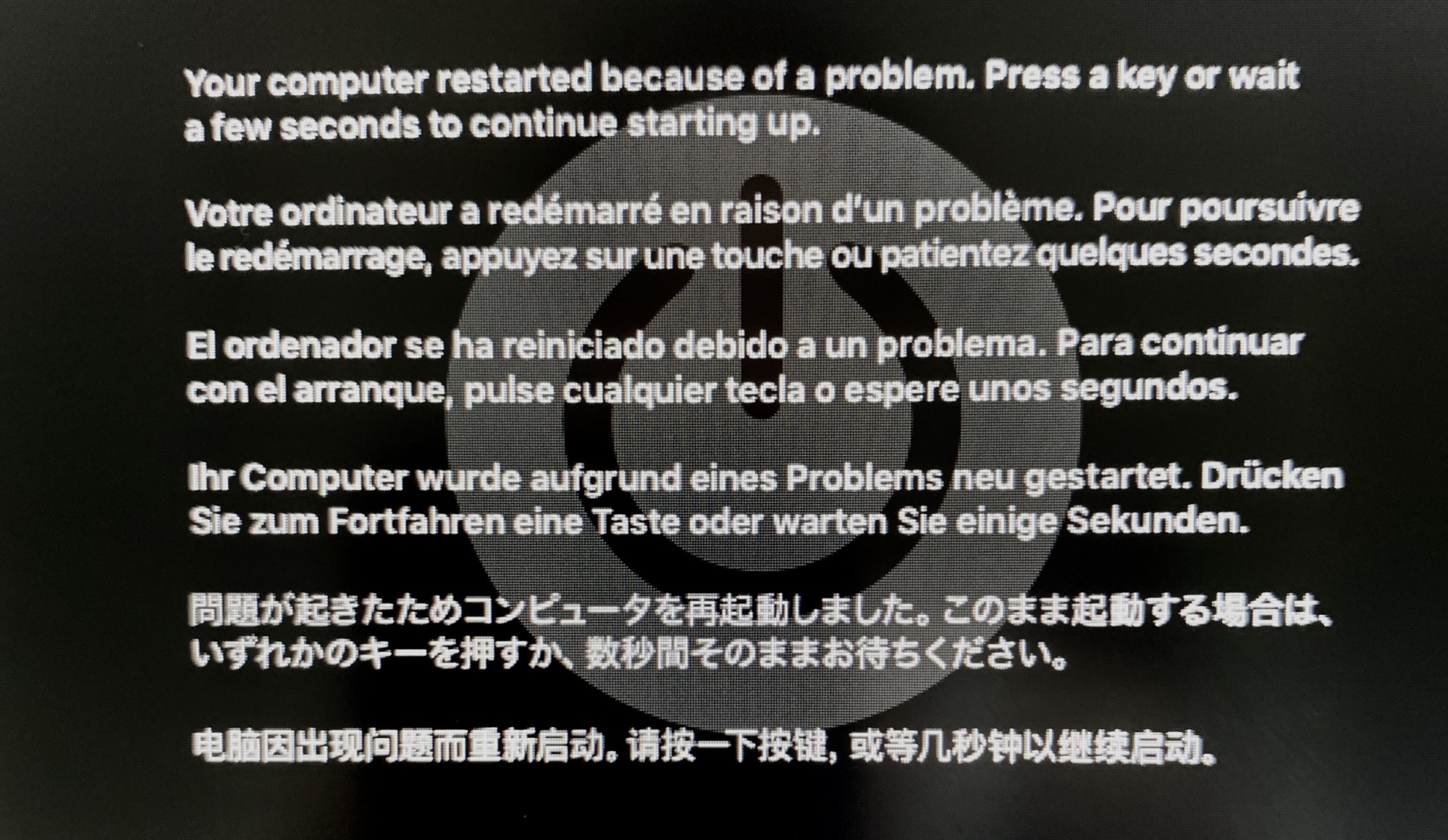

Now, when logged into Catalina (on the NVMe) and after waking up from sleep, the computer fails to wake up and reboots and gives me the same warning message displayed in the picture above.

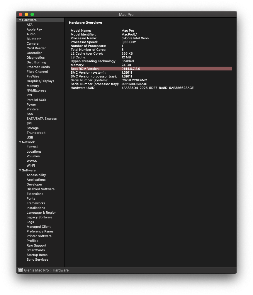

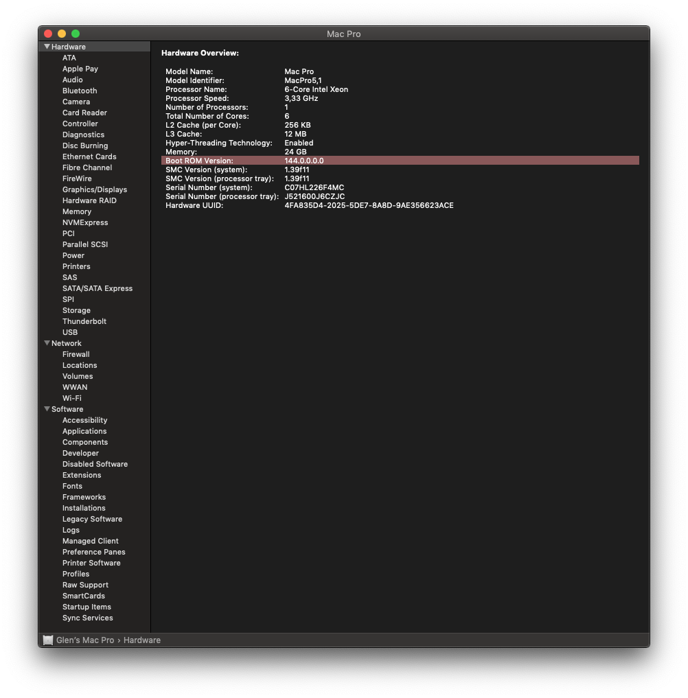

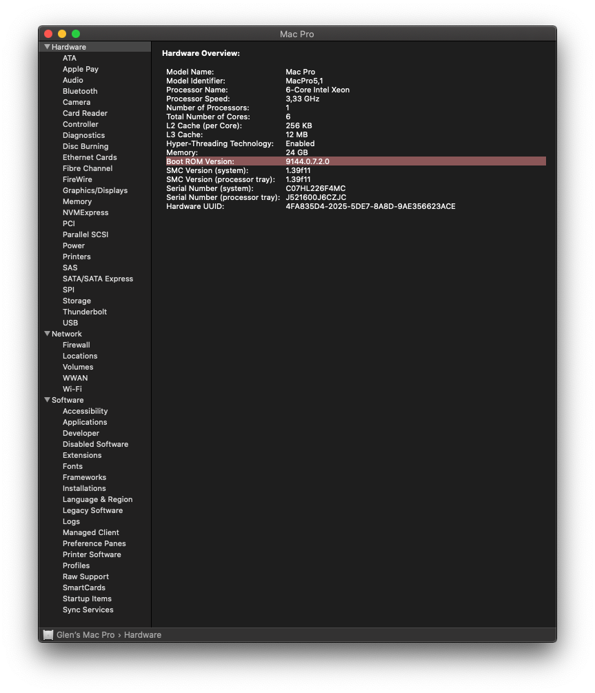

So I checked my bootROM in system information and saw this:
Now, I know from the las time I updated/flashed the ROM back in 2019 that the Boot ROM should be version 144.0.0.0.0 and not what is displayed here.
So what might be going on here, what likely happened? And can I simply re-flash again to version 144.0.0.0.0 ?

Ok, I'll post in this thread since I do not want to pollute the other thread with a problem that belongs here.
My situation is the following:
A few days ago my system (cMP 5,1) was running OpenCore 0.7.2 (martin's package), Big Sur 11.2.3 on PCIe NVMe, Mojave on internal SSD and Windows 10 on internal SSD (as far as I know it was installed in Legacy mode).
On Monday I decided to update Big Sur on my NVMe to 11.5.2 but I forgot to set the emulate flag in the OpenCore config.plist
This caused an unsuccessful install of 11.5.2 (of-course) an the Mac was stuck in a boot cycle where after rebooting it kept displaying the following message:
After this I booted back into Mojave, wiped the NVMe and Installed Catalina instead (this time setting the emulate flag in the config.plist like I should have done the first time around). All went fine and Catalina is running fine. But I noticed I lost my Windows 10 entry in the OpenCore bootpicker screen. The only entries left are Catalina and Mojave.
I am however able to adress the Windows 10 SSD using Parallels to load it as a 'BootCamp' partition. Everything there is running as it should and I checked again if it was running in Legacy mode and it was.
Someone hinted me that my bootROM might be affected (I never booted into Windows without OpenCore and as far as I know, Windows always ran in Legacy mode not UEFI).
Nothing here, it's just spoofing from OC, to block unwanted updates from iMacPro or MacPro7,1.
You could have several other problems, but the EFI release is not one.

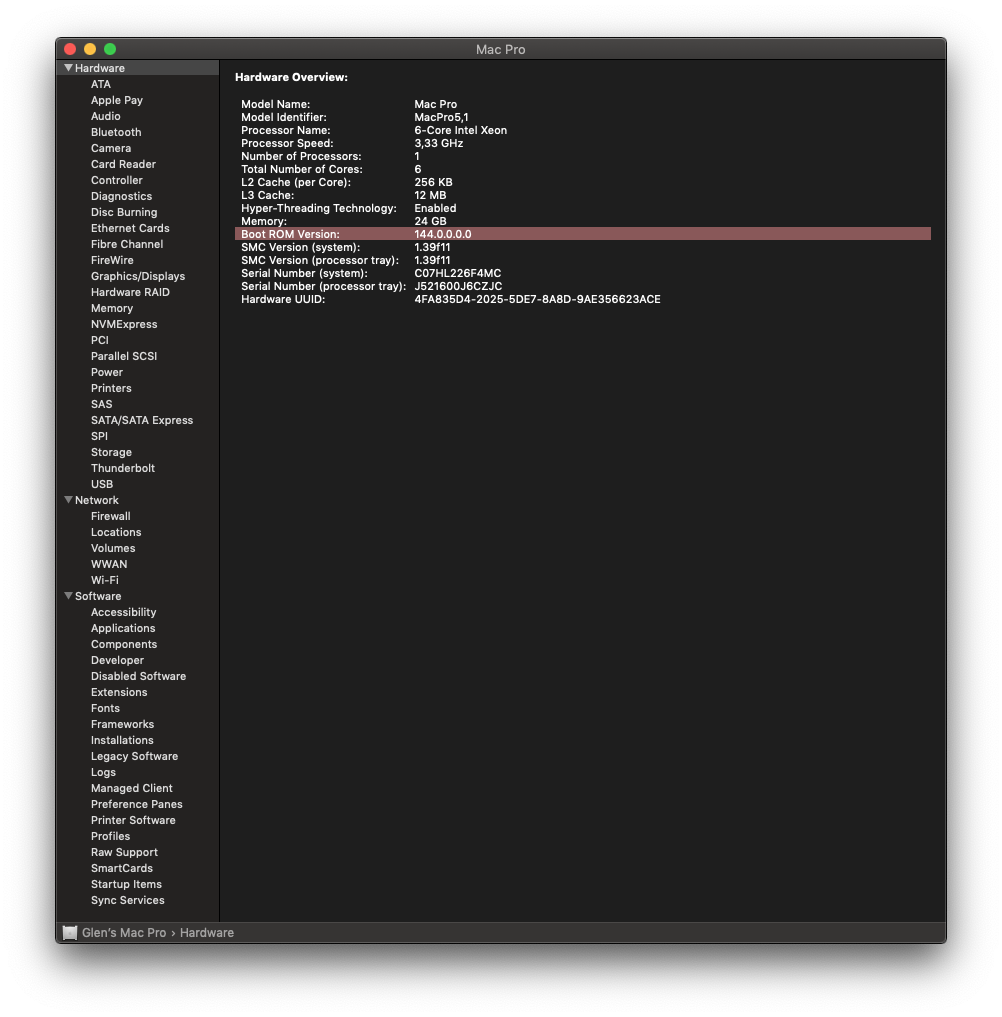

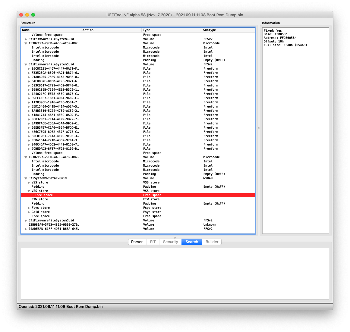

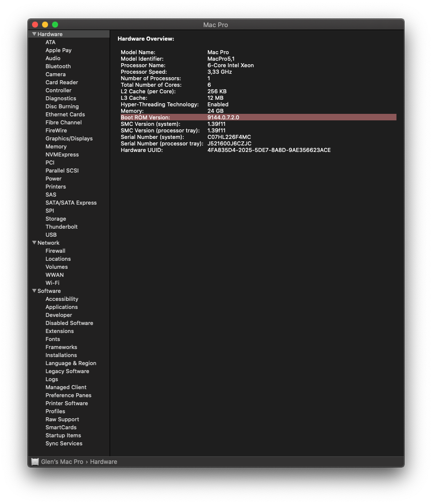

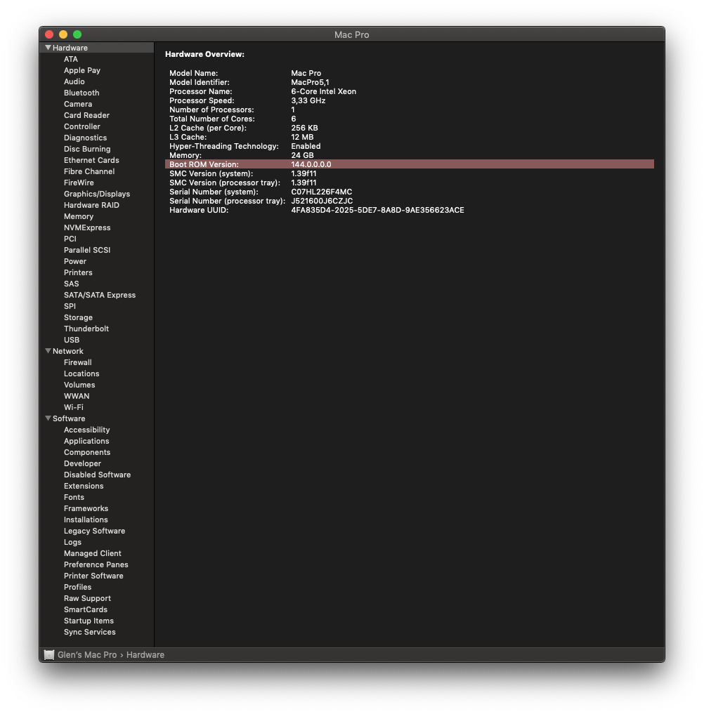

Ok, a small update.. I removed OpenCore 0.7.2 from the EFI of my boot drive and rebooted (into Mojave obviosly). This time System Information shows the correct Boot ROM version:
So now I know the Boot ROM is still as it should be. That still leaves me with the wonder why the Windows drive won't whow up in the bootpicker when OpenCore is loaded and why I'm getting the reboot with the warning message afterwards when waking up from sleep when in Catalina.

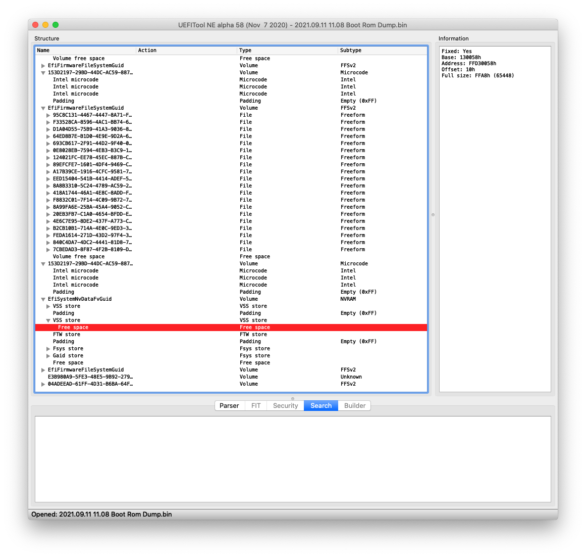

What are VSS stores and how do I check them?
VSS stores are the main and secondary areas of variable storage inside the NVRAM volume, a component of the BootROM.
Start checking with this post below:

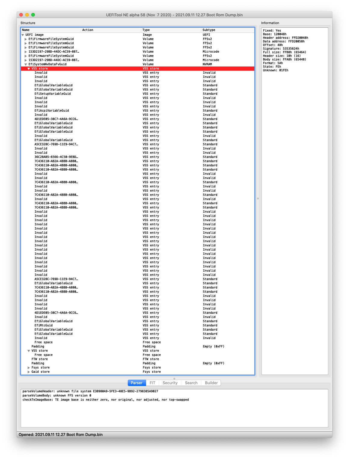

LFO8
macrumors regular
Apr 27, 2019
228
102

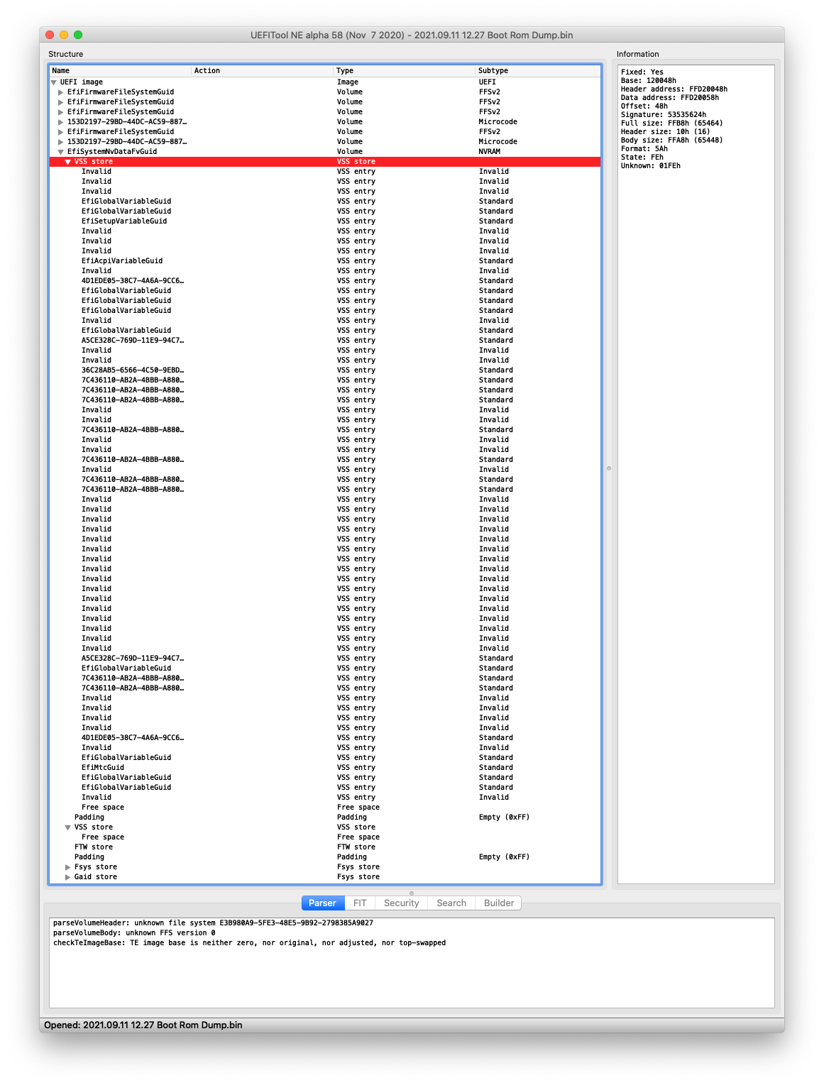

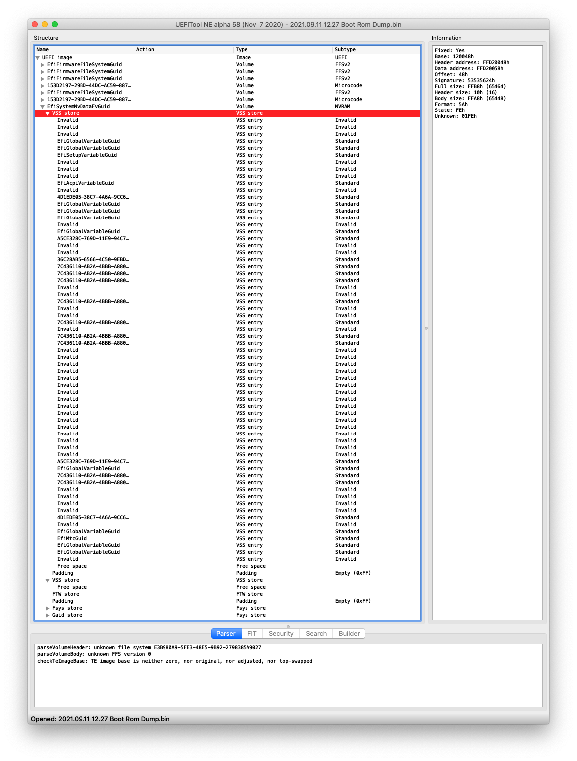

Thank you.. I downloaded that tool. No clue what to make of this though..
tsialex
Contributor
Jun 13, 2016
13,455
13,601
Yes.
Just from looking at the number of invalid entries inside the main VSS store and the pristine secondary one, I already know that you have a failed garbage collection and will need a BootROM reconstruction.
Check your Mac Pro BR2032 RTC battery voltage with a voltmeter right now - a brick is the most probable outcome if you continue like this and will happen soon with all these invalid entries.
Reactions: ironmanny1
