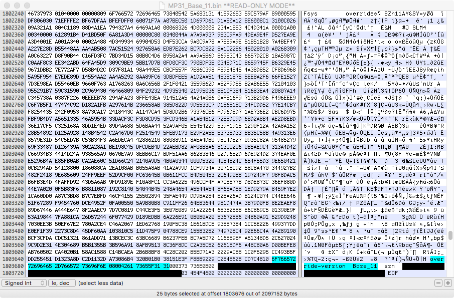

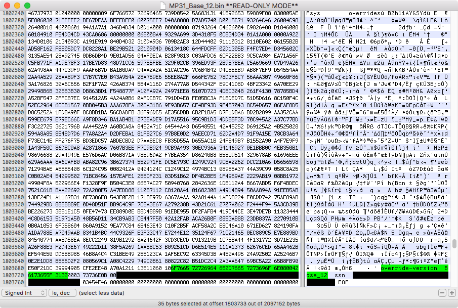

This weekend I had to change the logic board of my Mac Pro 2008. Today, I was taking a look on the BootROM from the new logic board and found that the Base_XX file for MP3,1 changed over time like MP4,1/5,1 ones.
Before I only had found Base_11 in 6 different Mac Pro 2008s. The replaced board has a build date of 20080130 and the Base_11:
Now the first Base_12 one, the new logic board has a build date of 20080819:
  • Base_11.out.txt
  • Base_12.out.txt

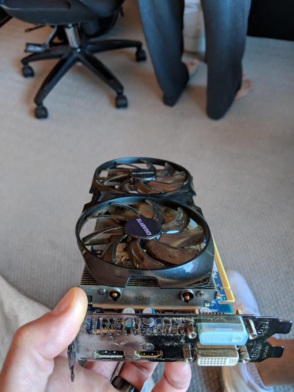

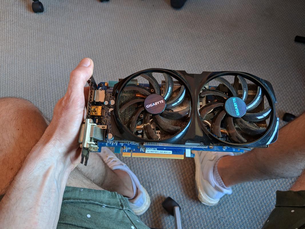

This is a little off topic but I feel like this is place the best brains in Mac right now.
I just got my hands ob a GTX660Ti for free.
Can I flash the Mac EFI onto it?
Does anyone know if this is possible?
First, this thread is about Mac Pro BootROM and associated topics, like how to unbrick a Mac Pro. Please don't bring other things to the thread.
About the the GTX 660 Ti:​
The only NVIDIA GPU that has public accessible EFI firmware is GTX 680. It's definitely possible to adjust the GTX 680 EFI to the GTX 660 TI, almost the same chip (both cards use GK104), but it's not a flashing job. You will have to extract the Mac EFI from GTX680 and adapt it to the GTX 660 Ti, maybe even replace the SPI-flash to one bigger.
Search if anyone already did that for your card, if you don't have the resources to flash the SPI externally, desolder/replace the SPI-Flash, don't even start.
The only NVIDIA GPU that has public accessible EFI firmware is GTX680. It's definitely possible to adjust the GTX680 EFI to the 660TI, almost the same chip, but it's not a flashing job. You will have to extract the Mac EFI from GTX680 and adapt it to the GTX660TI, maybe even replace the SPI-flash to one bigger. Search if anyone already did that for your card, if you don't have the resources to flash the SPI externally, desolder/replace the SPI-Flash, don't even start.

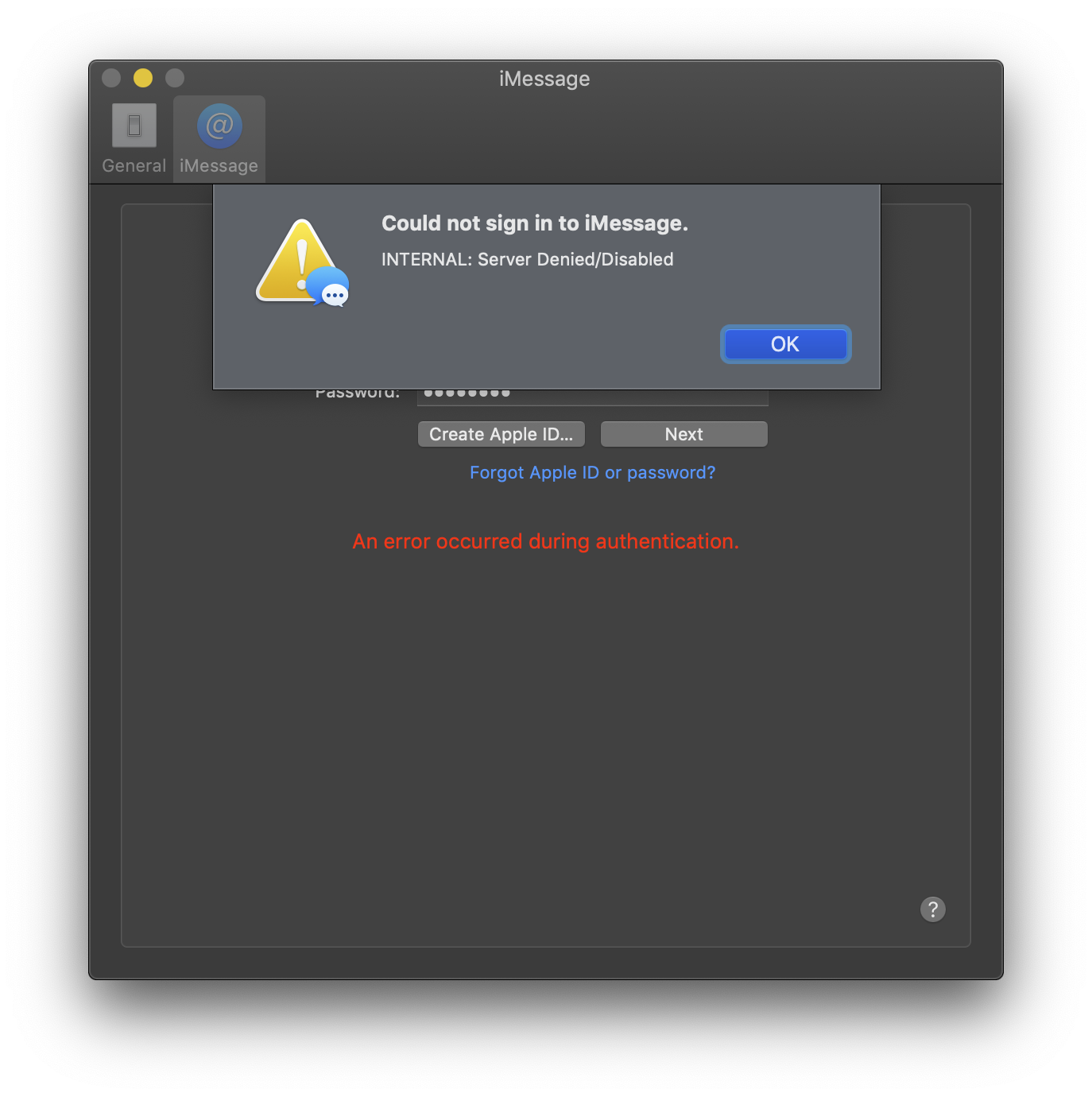

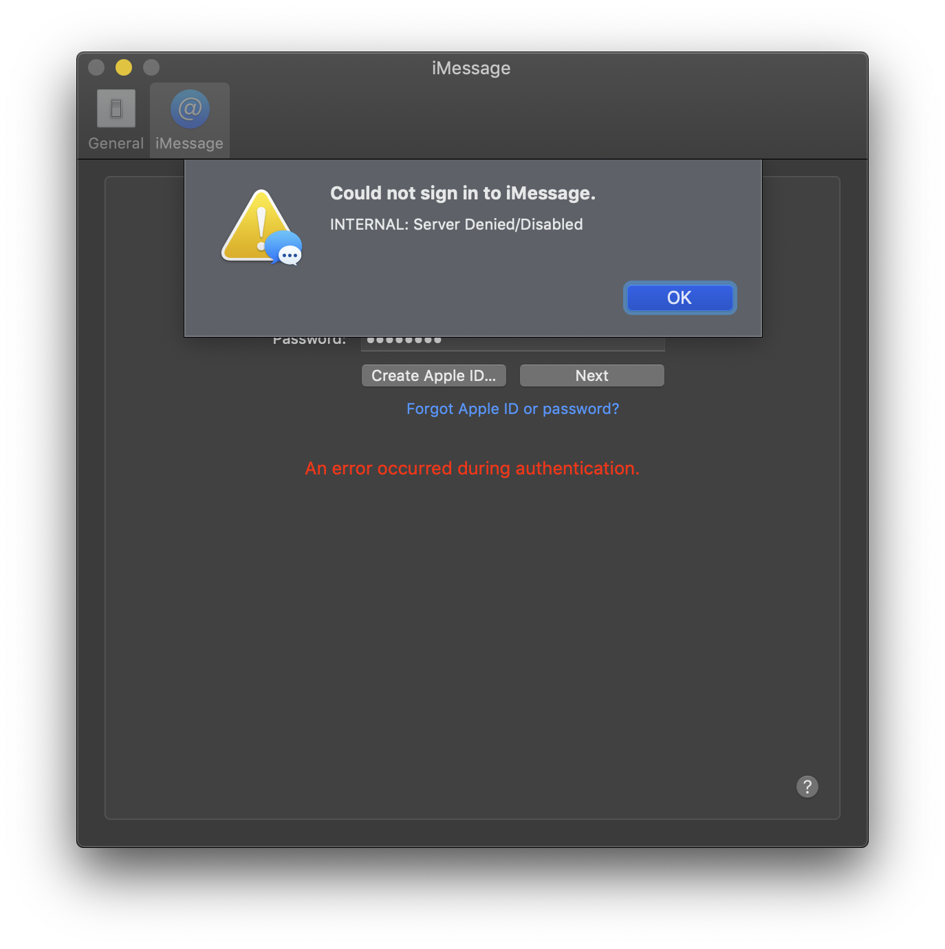

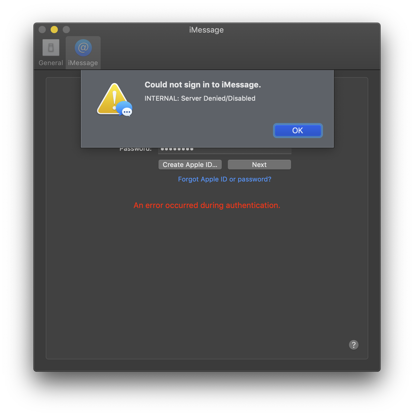

Somehow I get the feeling the 138.0.0.0 BootROM revision is all Mac Pros are going to get, if even that much.. I can see Apple pulling a 180 and deciding upgrades to 0089 is enough.
I've been running iMessage on a 138 ROM'd 5,1 (thanks again tsialex) without interruption, for what it's worth.
Maybe sign out and sign back in?
I doubt if it can really affect Hackintosh. Which can set almost any parameter in the loader, including hardware definition, serial number, etc.
Cat and mouse game.
With all this, Mac Pro people will find the problems with the BootROM easily since iMessage not working is a big indicator of problem.
