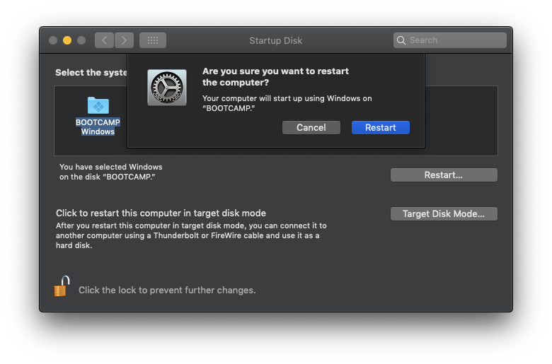

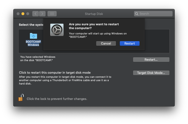

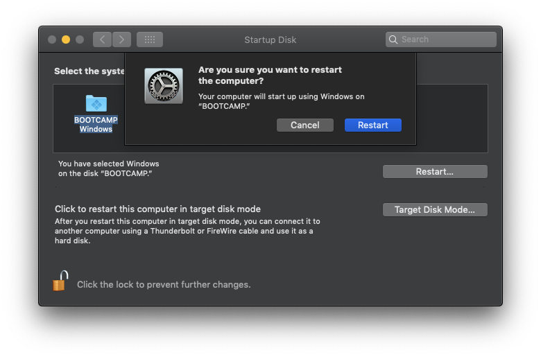

Actually it has changed, you can now boot windows from startup disk with SIP enabled. So yeah it changed...
Oh, nice! At least something. Did you look at updates for Windows BootCamp boot manager?

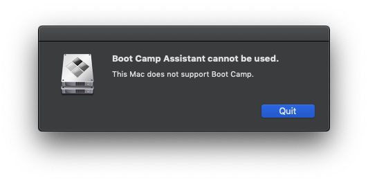

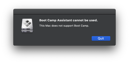

you know any fix for why I get this message?
hello sir, sorry bother you with an old topic, but i need to know your evo 960 boot mac pro or not? it's not ahci, but nvme, if you did boot with it, which pcie adapter do you use please? thank you so much.
@marcoscc has a Highpoint 7101a and I reconstructed his BootROM, 138.0.0.0.0 with NVMe EFI module from MP61.0124.B00.

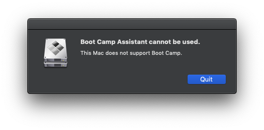

You get the message because Bootcamp Assistant isn’t supported on the cMP with updated firmware/macOS.
The fix is something only Apple can do.
Install BootRunner3 for a workaround. There are other Apps. that work fine too, I just happen to use this one at the moment.
