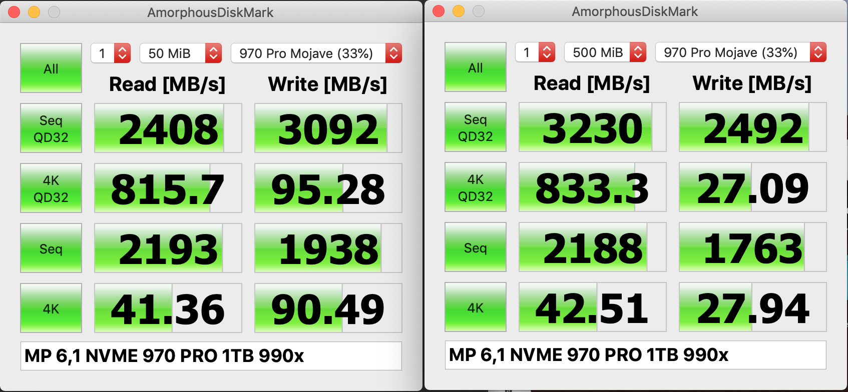

Just one 970Pro with HighPoint SSD7101A (@handheldgames test/image), 138.0.0.0.0 BootROM with NVMe module injected.

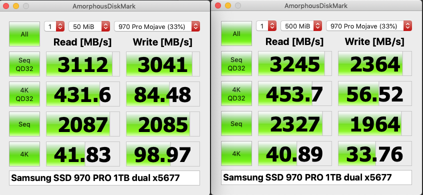

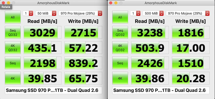

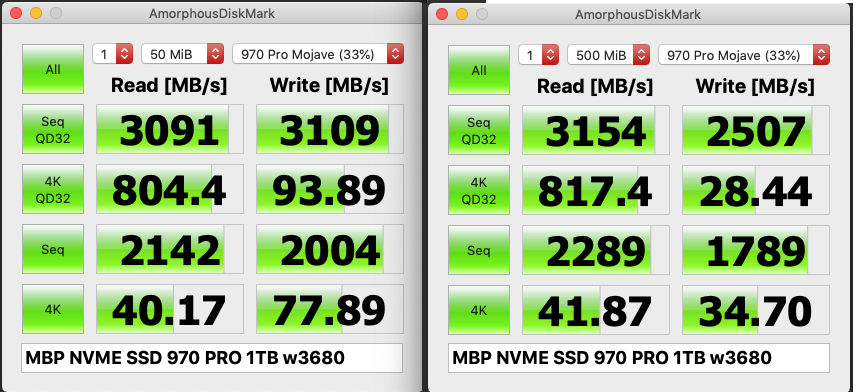

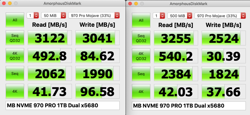

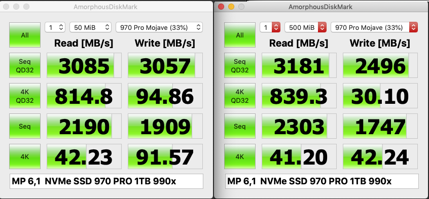

Here is the full suite of benchmarks from the test bench...
Test Bench Setup
  • 4,1 Mac Pro - AMD 480x, dual 2.26 Quad Core 12GB Udimms, single 990x 48GB RDIMMS
  • 5,1 Mac Pro - AMD 7950, dual x5677 96GB RDIMMS, dual x5680 96GB RDIMMS, single w3680 48GB RDIMMS
  • Highpoint SSD7101-a with 970 Pro 1tb. Booting from 256GB Mojave test partition (swapped between systems for the test)
NVMe Performance Take Aways....
  • When it comes to NVMe, Single CPU systems are MUCH FASTER than Dual CPU systems with 4K QD32 file transfers.
  • the w3680 has the FASTEST Sequential QD32 Performance
  • the 990x has the FASTEST 4K QD32 QD32 performance
  • Dual x5677 performance is a little faster than the Dual x5680
  • 4K NVMe Performance is directly related to CPU Speed / CPU configuration.
[doublepost=1536885324][/doublepost]Adding an additional Benchmark from the 990x with the MP 6,1 NVMe driver. An unexpected loss of 500 MB/sec has been resolved. Time to remove the test EFI from the system.
