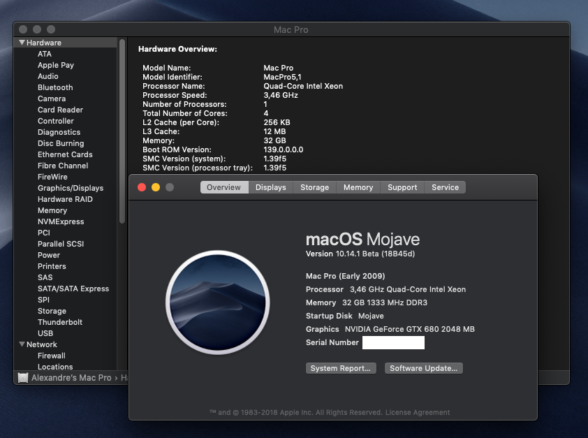

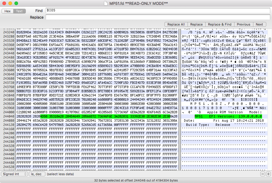

Apple released 10.14.1beta1, build 18B45d.
[doublepost=1537909017][/doublepost]Welcome 139.0.0.0.0

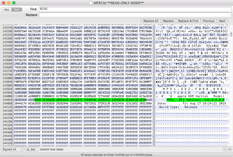

[doublepost=1537909233][/doublepost]139.0.0.0.0 - still no NVMe EFI module for Mac Pro. I'll check the rest ASAP.
[doublepost=1537909342][/doublepost]
Code:
$IBIOSI$ MP51.88Z.F000.B00.1808171030
Apple ROM Version
  Model:        MP51
  EFI Version:  139.0.0.0.0
  Date:         Fri Aug 17 10:24:21 2018
  Build Type:   Release

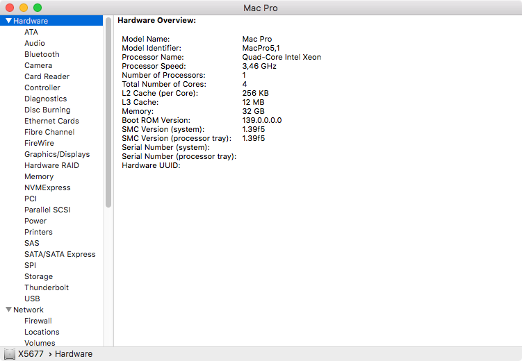

Flashed my vanilla reconstructed one, everything worked here. Now I’m gonna flash the NVMe v124 one.
[doublepost=1537912962][/doublepost]Booting Recovery with the NVMe BootROM to disable SIP. Seems to be working too.
[doublepost=1537913010][/doublepost]Double boot, yet… :mad:
[doublepost=1537913763][/doublepost]Screen Shot 2018-09-25 at 15.14.15.png
[doublepost=1537914469][/doublepost]Lot’s of restarts, 10.14b1 update seems interminable.
[doublepost=1537914737][/doublepost]Screen Shot 2018-09-25 at 15.29.25.png

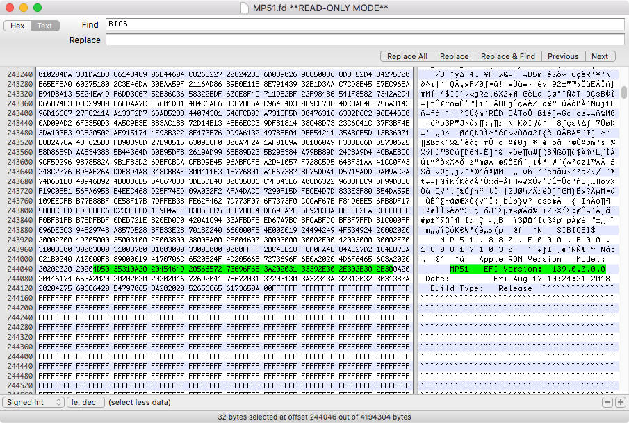

[doublepost=1537915656][/doublepost]Reconstructed @h9826790 and @Matty_TypeR BootROMs with 139.0.0.0.0, to get more people testing/searching. @crjackson2134 did it himself :p
No changes here:
