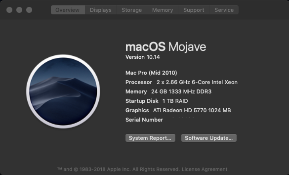

My issue is this. I want to update the BootROM to 138.0.0.0.0 on the MP5,1 but somehow it skipped that part. Also i don't have a Metal GPU, only a stock 5770.
Is there a way to force the firmware update without Metal? Does ROMTool do this in a few easy clicks ?
I think this info would be very helpful for people stuck in this position such as myself.

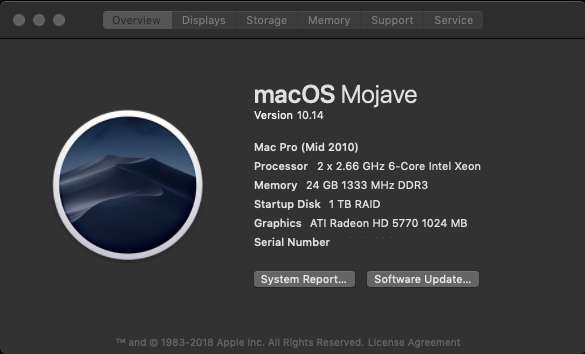

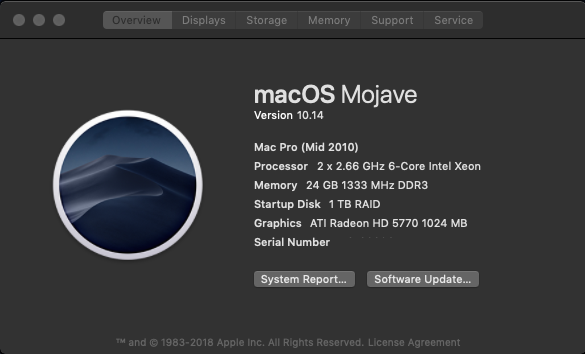

Somehow fiddling around i managed to install Mojave on a 5,1 using only a stock 5770 onto a RAID 4 drive setup., bypassing the installers Metal requirement and firmware update.....except now i don't remember how i did it.
Can someone help Remind Me ?!? :confused:
Much Appreciated
PS - My BootROM is still MP51.0089.B00

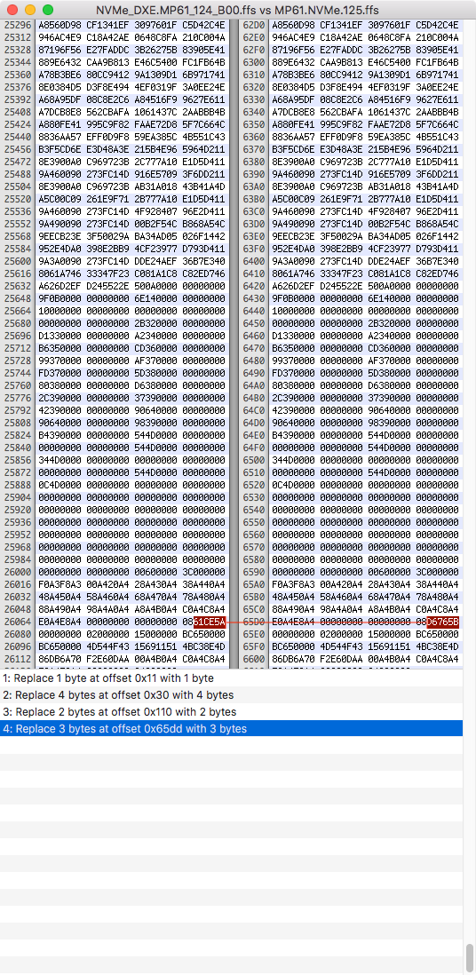

Just compared the trashcan NVMe EFI module from MP61.0125.B00 with the previous version (MP61.0124.B00) and again little changes:

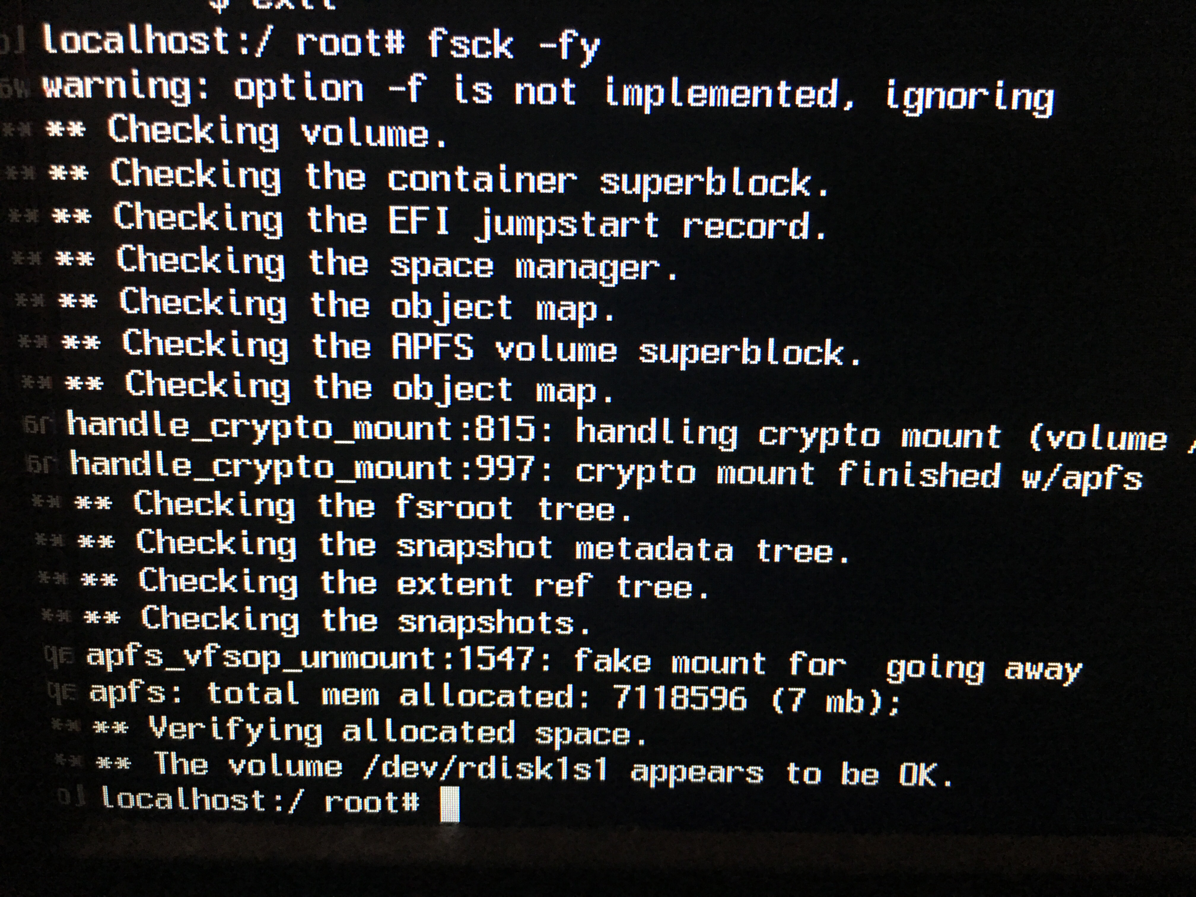

Ah, you used to be able to enter single user recovery mode but no longer it seems...
https://apple.stackexchange.com/questions/332587/single-user-recovery-mode-on-high-sierra-10-13-6
But yeah, you'd be flying blind anyway I think.

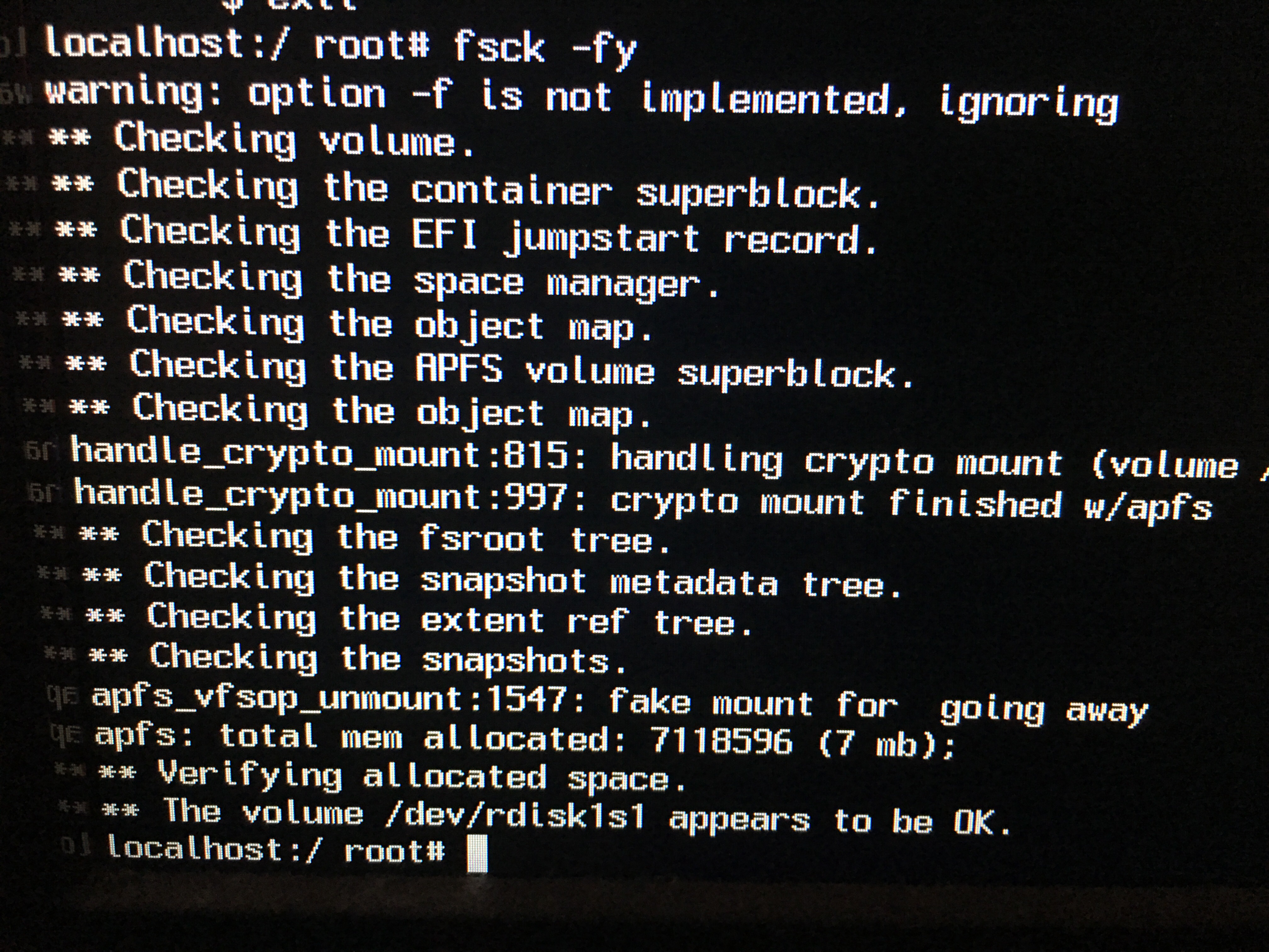

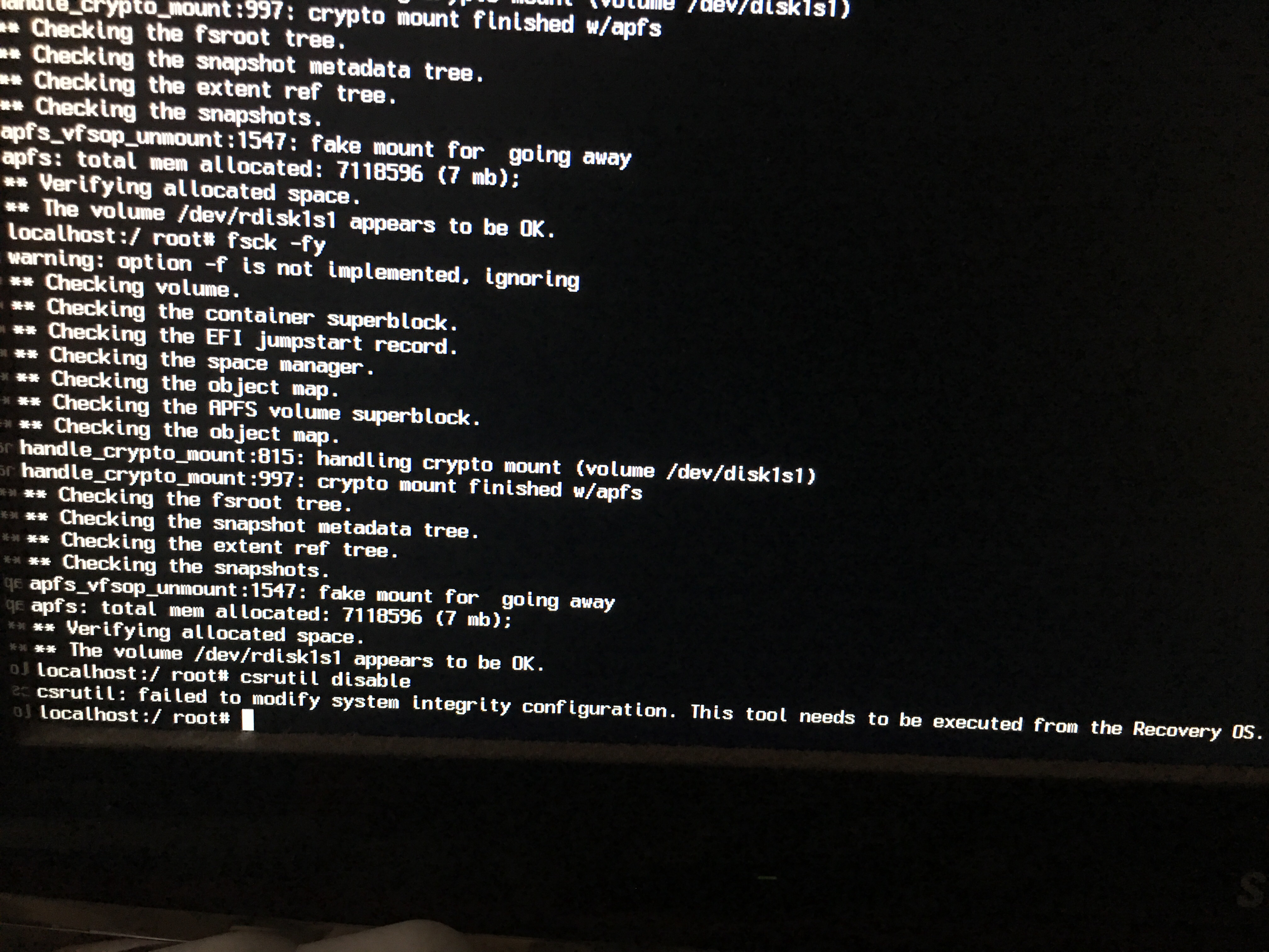

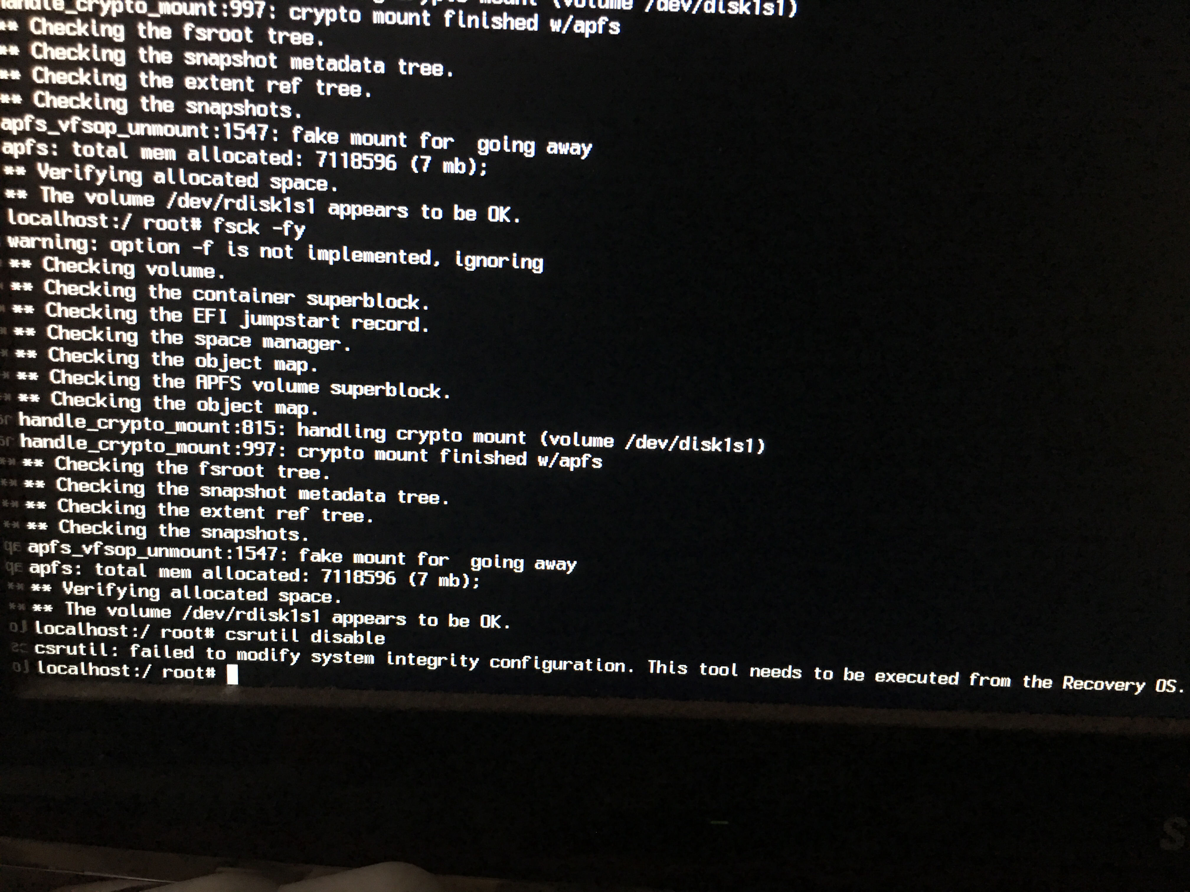

Still works here.
Still works here.

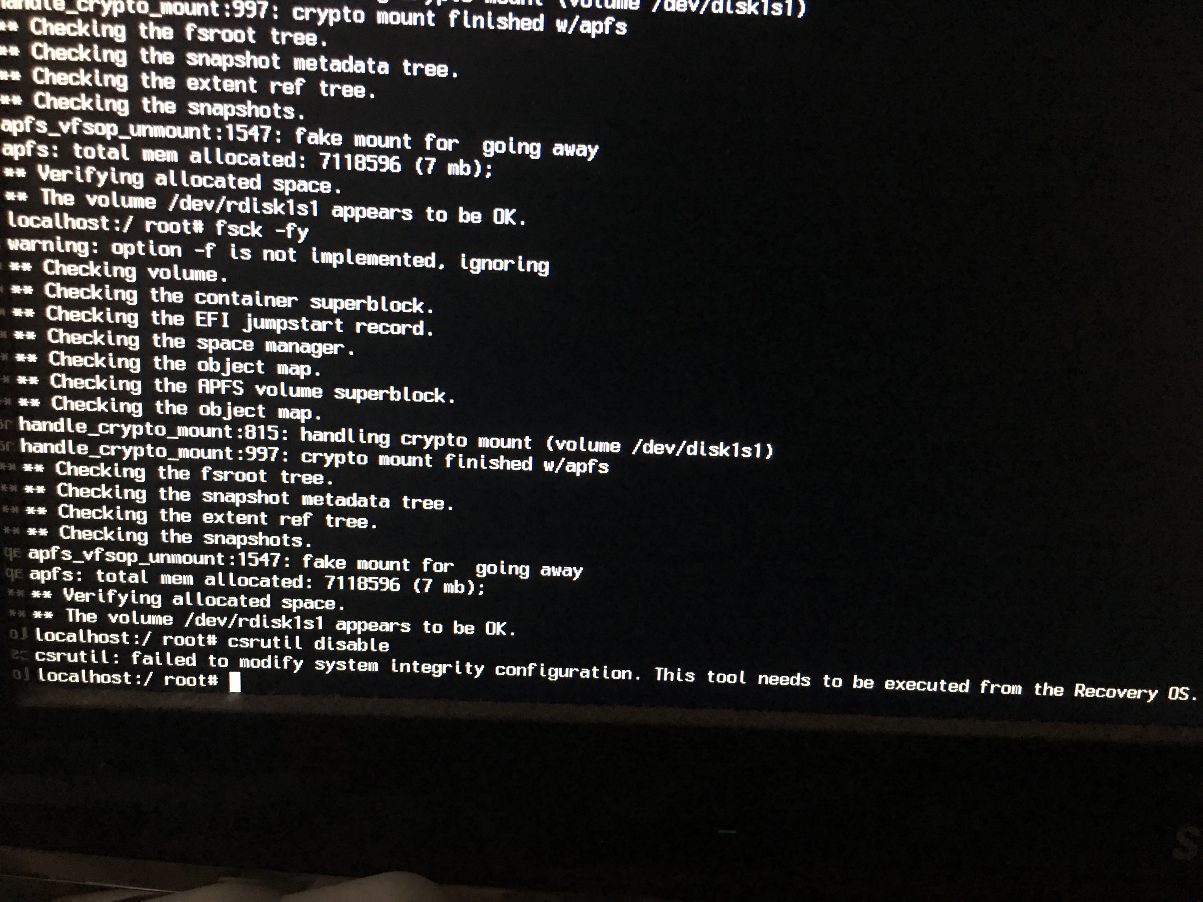

I think you'll find that it took you into single-user mode and not single-user recovery mode.
Try running csrutil enable/disable.
I discovered this the other day on Mojave, very frustrating that Apple removed this functionality.
