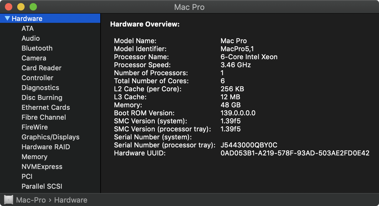

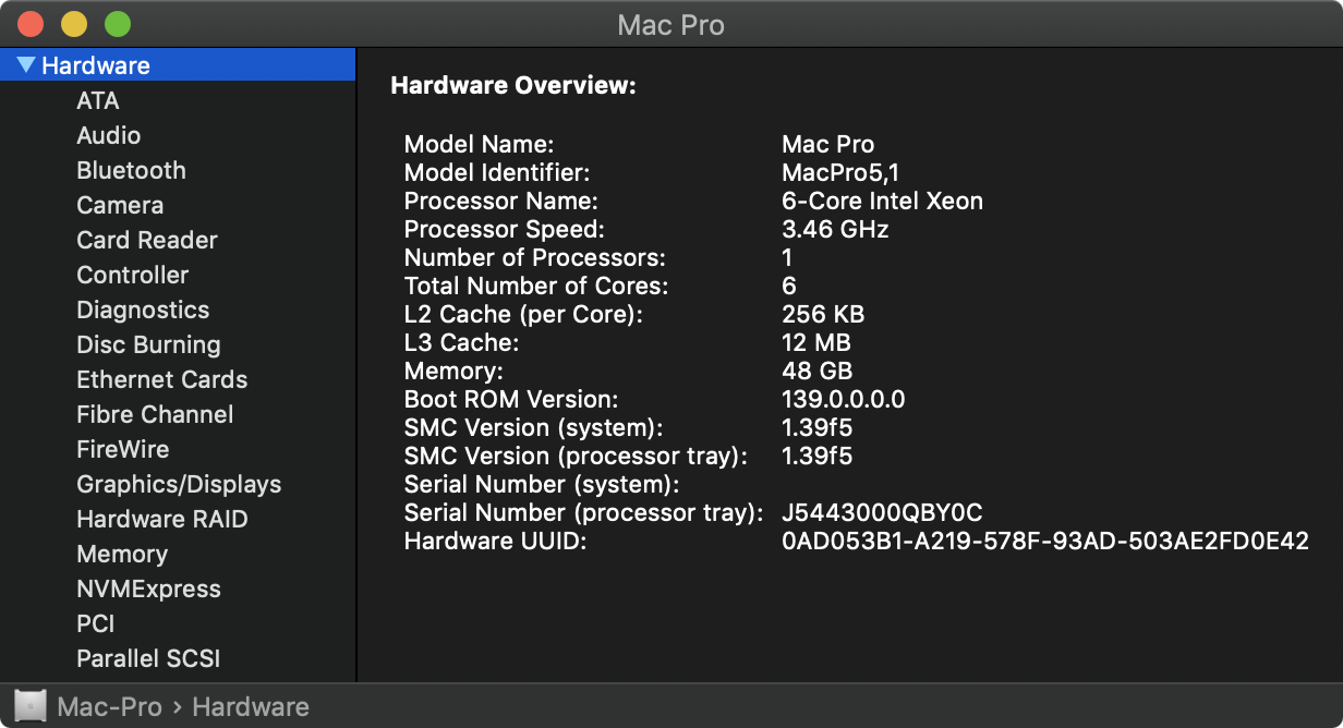

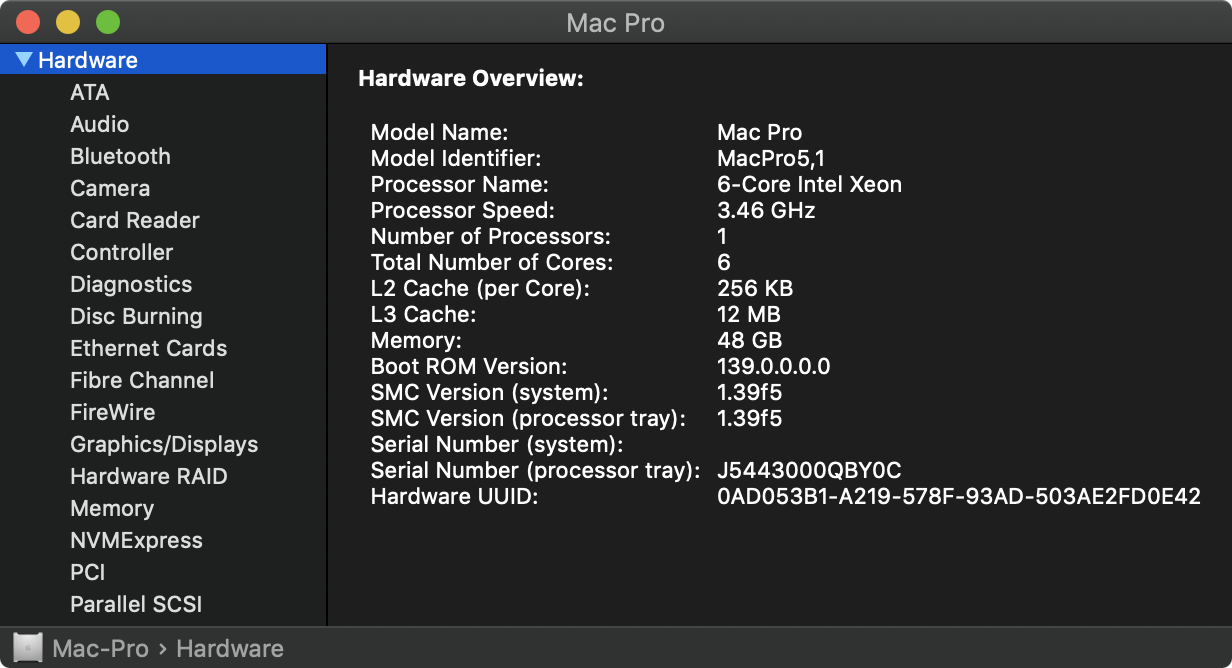

139.0.0.0.0 is good on my cMP as well. Can't spot any difference, but seems safe to upgrade.

Was wondering if I should mention something about about the boot picker being "within reach" and urge them to consider implementing (while they're at it w/ the eleventy cMP firmware updates we've had lately!)... What do you think?
3rd party boot loader showing boot picker is within reach. I really doubt that Apple will change Mac Pro to GOP.
[doublepost=1537917130][/doublepost]
People with NVMe EFI module injected on the BootROM will need to do it again.

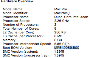

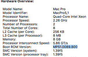

New here been following this thread since page 1. .Very Awesome Progress for 5,1's !! Kudos to everyone involved :)
Using Collins patcher i managed to install Mojave on a 5,1 using only a stock 5770 onto a RAID0 4 drive setup., bypassing the installers Metal requirement and firmware update.
My BootROM is still MP51.0089.B00

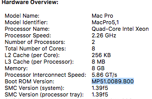

Somehow fiddling around i managed to install Mojave on a 5,1 using only a stock 5770 onto a RAID 4 drive setup., bypassing the installers Metal requirement and firmware update.....except now i don't remember how i did it.
Can someone help Remind Me ?!? :confused:
Much Appreciated
screen-shot-2018-09-24-at-4-04-30-pm-png.788870
Eh? :eek:
And the system is stable and 'usable'?o_O
