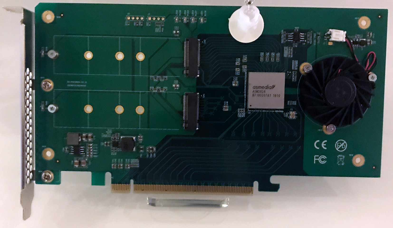

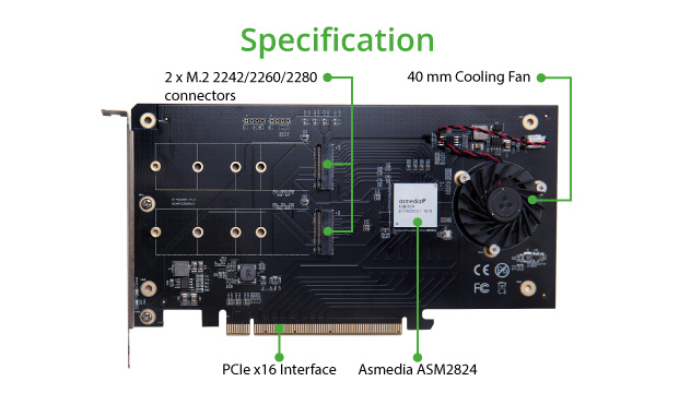

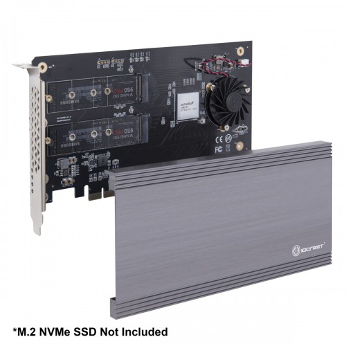

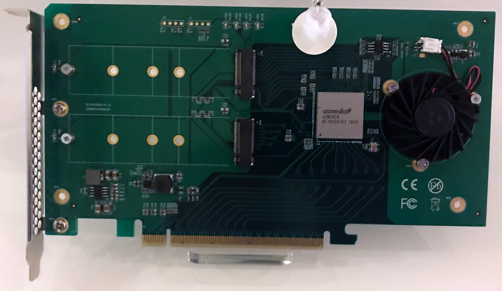

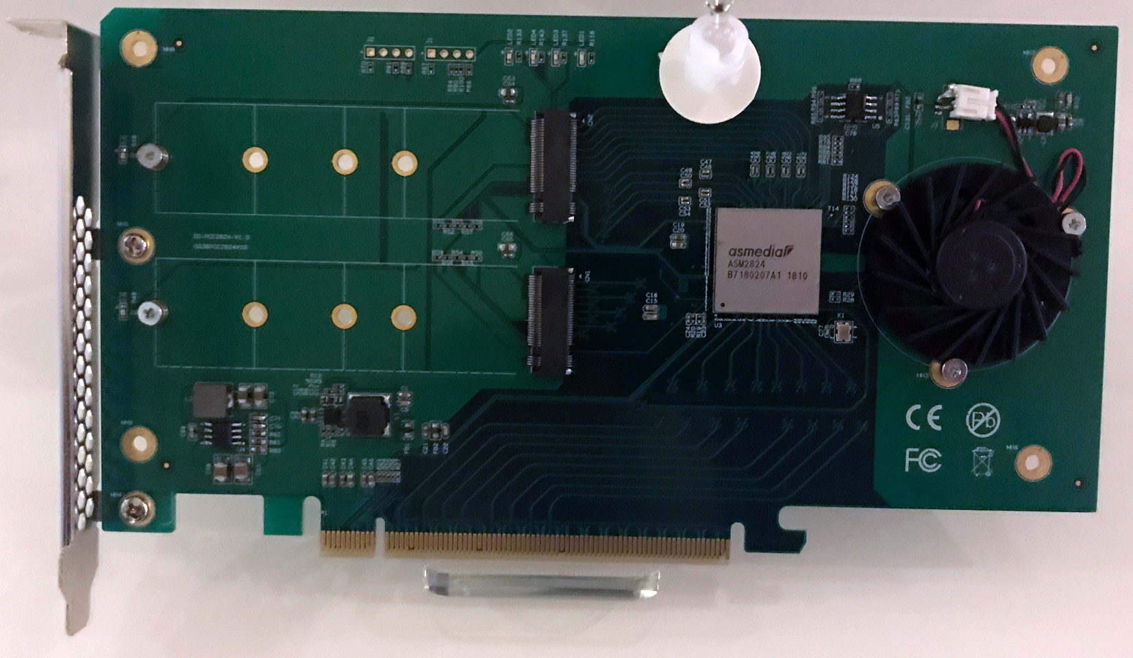

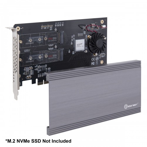

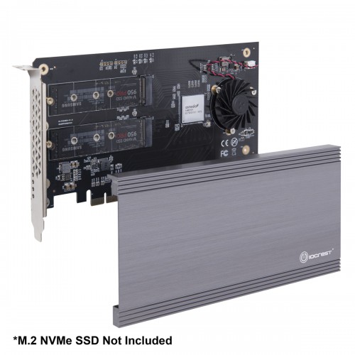

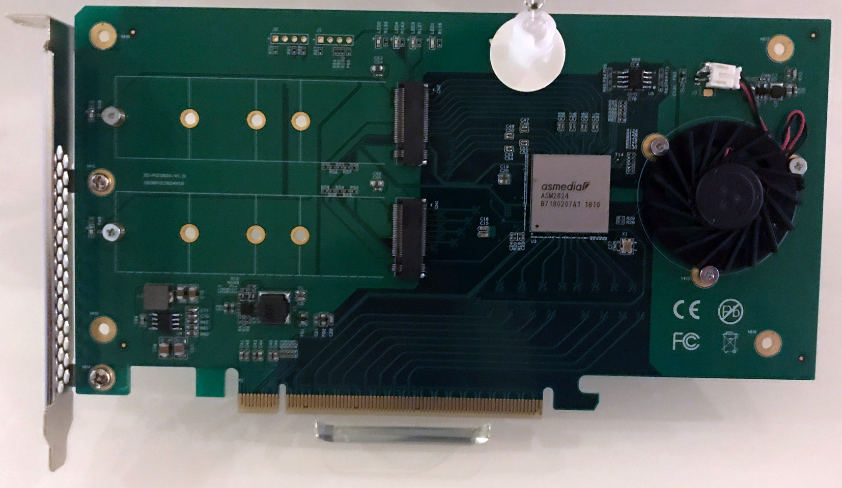

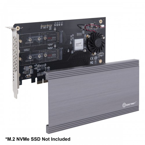

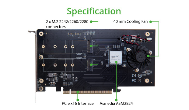

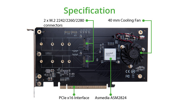

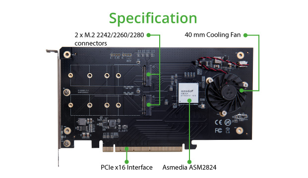

Found this - http://www.sybausa.com/index.php?route=product/product&path=64_188_148&product_id=992
Retailing for $214 on NewEgg
2 slots with half the lanes as the HighPoint/PLX PEX8747 .. not sure if it is supported by the mac pro so someone needs to order and test it.
Not sure if this card will work with PCIe 2.0, someone will need to bite the bullet.
Anandtech has a article about the PCIe switch used by this card https://www.anandtech.com/show/13022/asmedia-preps-asm2824-pcie-30-switch
I believe it should as the HighPoint card was designed for PCIe 3.0 but is working on our PCIe 2.0 boards. Looking again at the specs, it supports Non-BiFurcation and Bifurcation motherboards so there's a very good chance that it will work in cMPs although I am not sure how it will interact with or if it will impact other cards.
Looking at a close-up photo of the pcie card, it appears to be a cheaper alternative to the HighPoint and Amfeltec cards as it doesn't look to be well built.
link - https://www.techpowerup.com/245572/...-pcie-switch-anticipating-a-rise-in-m-2-slots
PLX one has support for PCIe 2.0 on the documentation, this ASMedia ASM2824 only cites PCIe 3.0 - so my warning.
