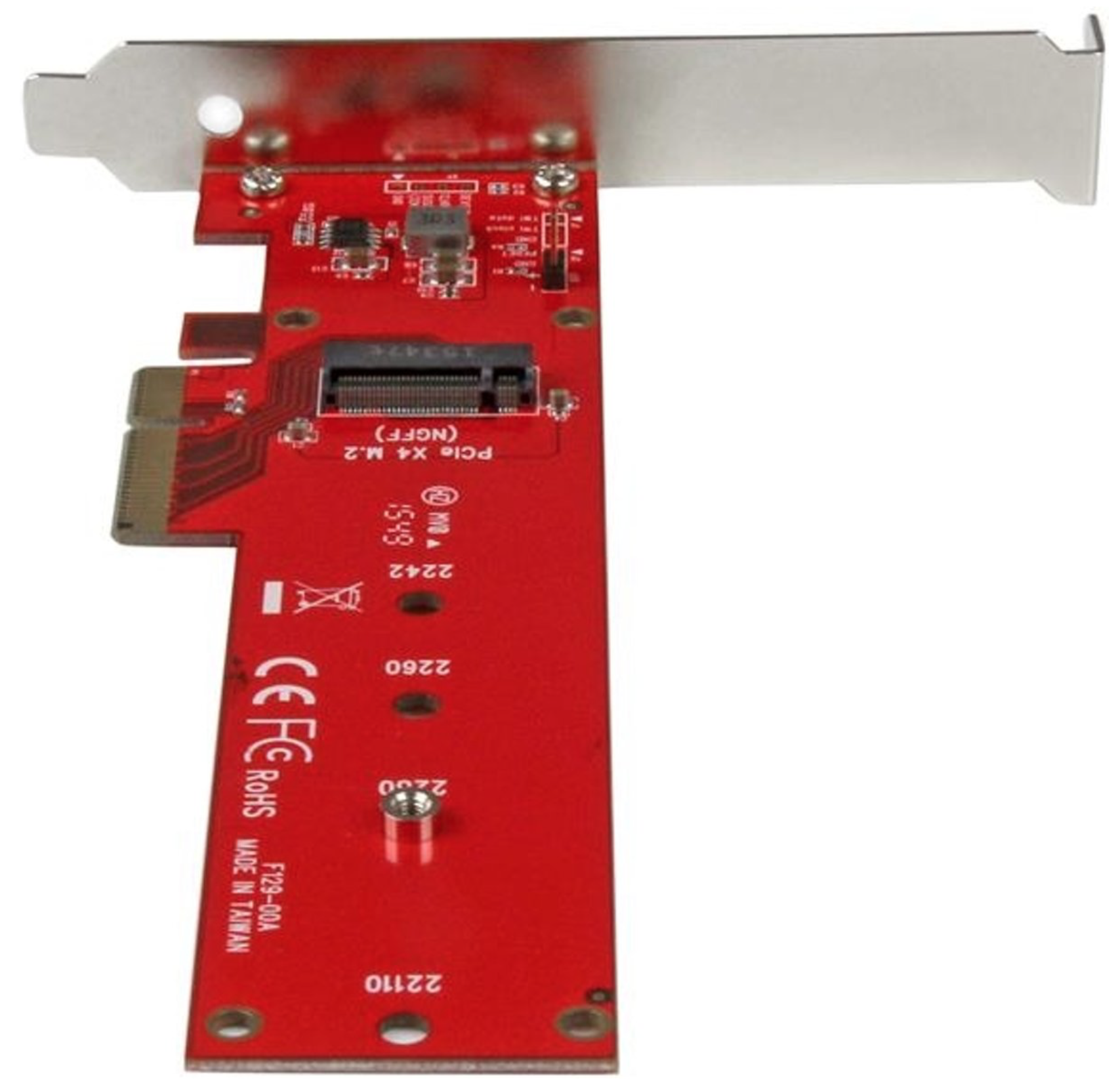

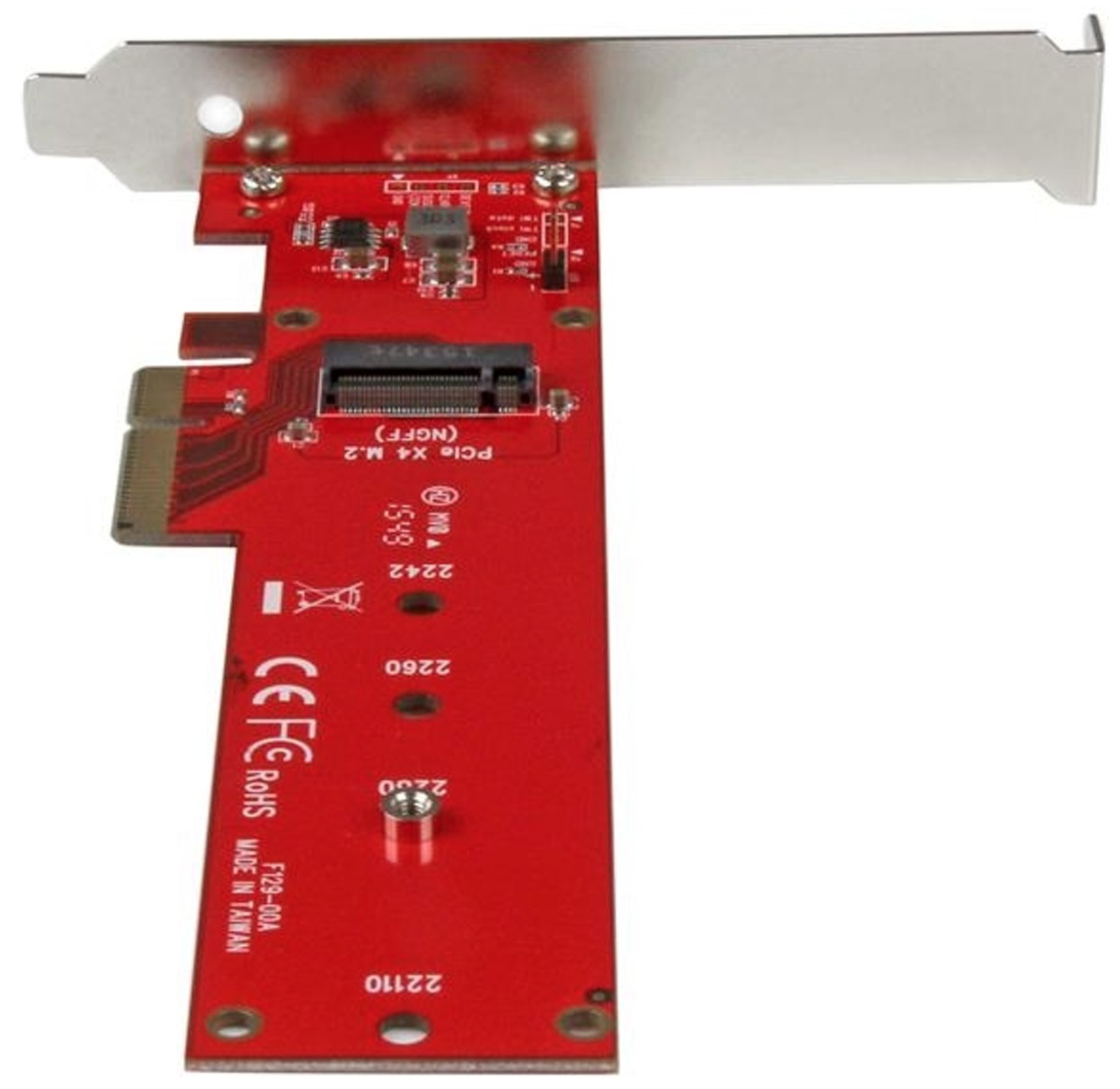

My StarTech x4 PCI Express to M.2PCIeSSD adaptor works fine in slot 4 of my cMP. It was only 32 euro in the Netherlands
With 39 euros you can buy Aqua Computer kryoM2. For just 7 euros more you get a huge heatsink and a better designed card.
Ok, thx for the correction, but let's be honest, it's not a 2.0 slots PCIe card. The backplate screws and the fans are out/over of the 2.0 slot dimensions and you can't have a full height PCIe card next to it.

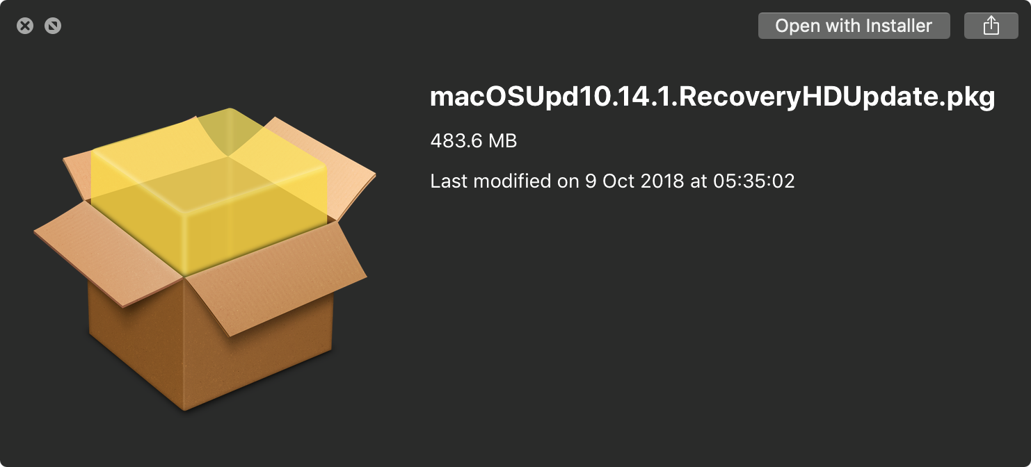

1) Download the macOSUpd10.14.1.RecoveryHDUpdate.pkg (thanks MisterAndrew PM me the link. Just learnt how to search the SUCatalog. Will do it myself next time. Thanks tsialex posted the SUCatalog link, and of course, share all his findings)

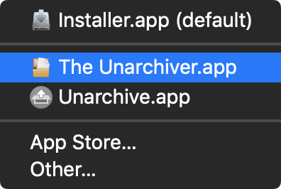

2) Right click the file, choose "The Unarchiver.app to unzip it.

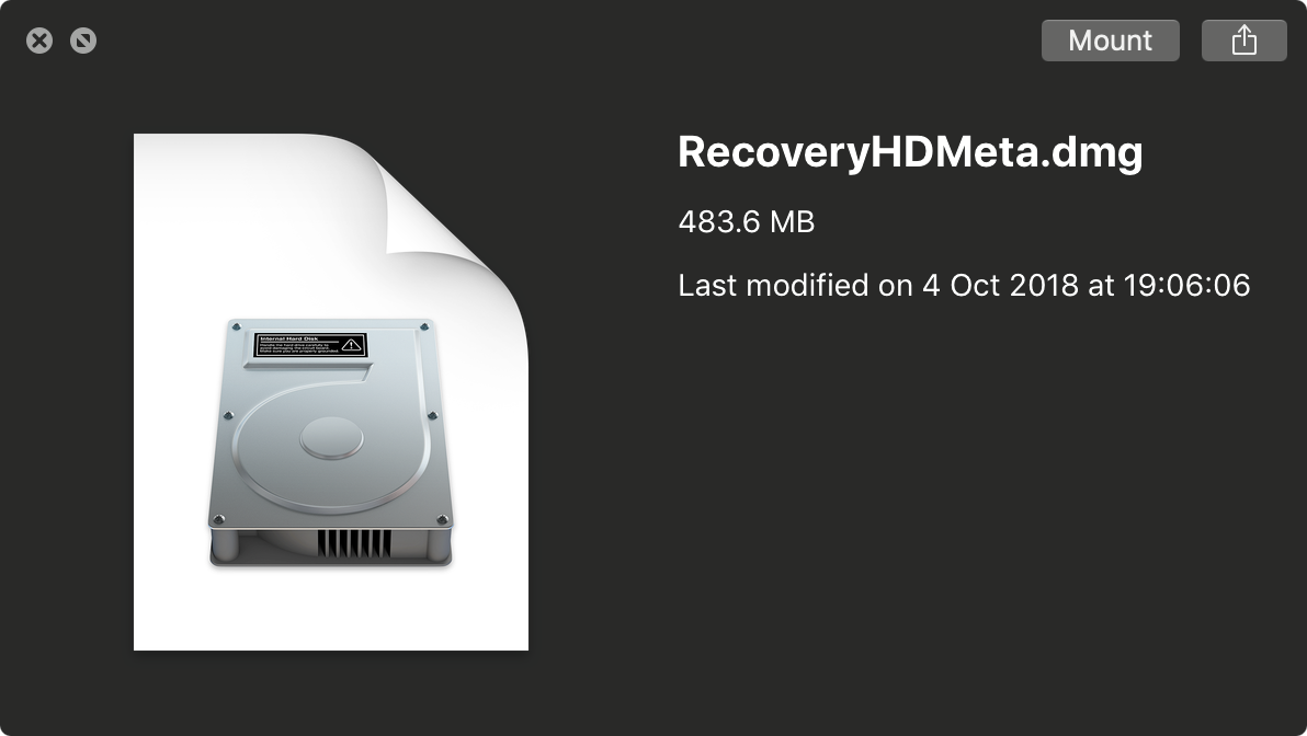

3) Inside the "macOSUpd10.14.1.RecoveryHDUpdate" folder, double click RecoveryHDMeta.dmg to mount it

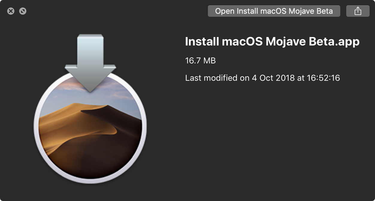

5) Double click this "install macOS Mojave Beta.app" to trigger the firmware update.
