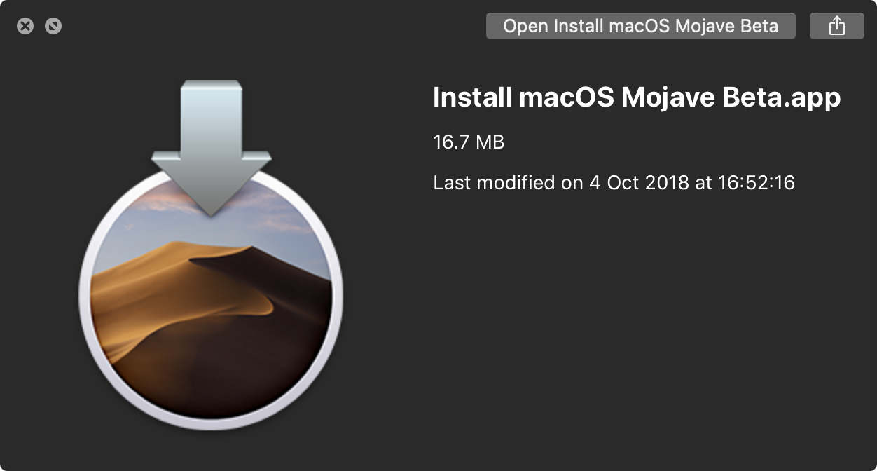

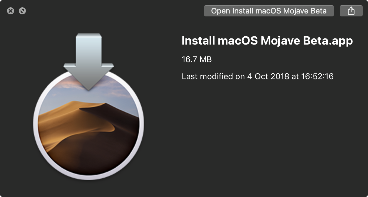

5) Double click this "install macOS Mojave Beta.app" to trigger the firmware update.View attachment 793387
6) Then just the usual stuff. Follow the on screen instruction, click shut down, wait 10s, press and hold power button until the long beep, release power button and wait for auto reboot. Anyway, as expected, this can be down with just the RX580, no Mac EFI GPU is required.

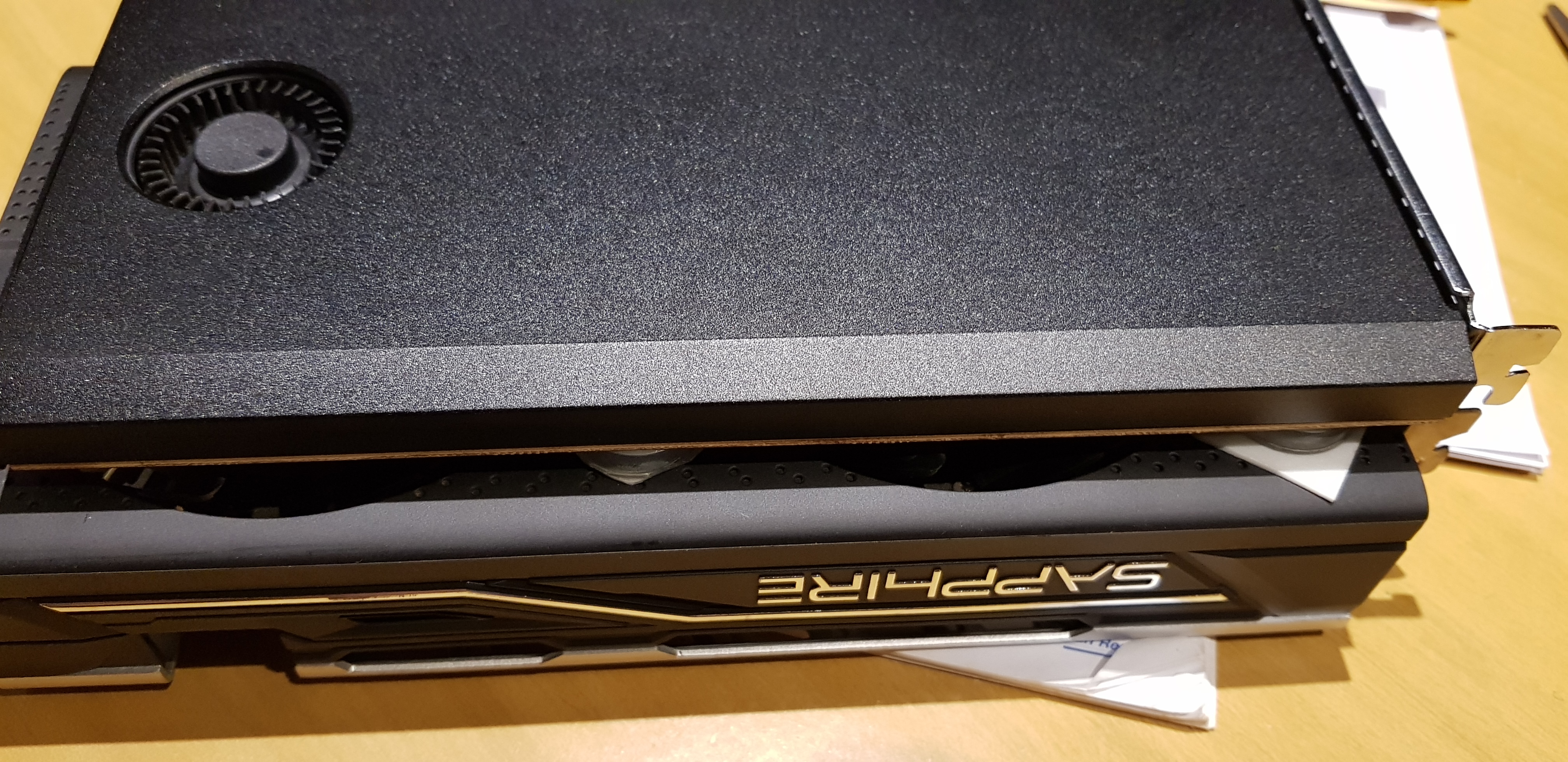

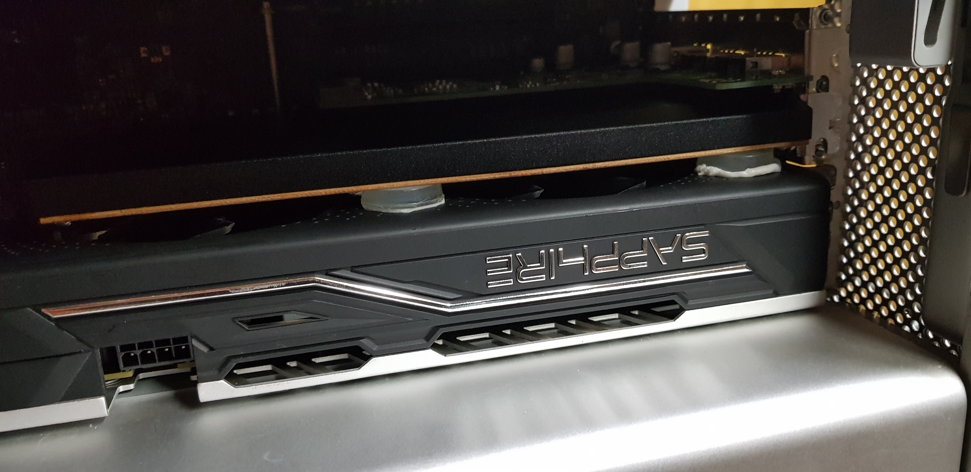

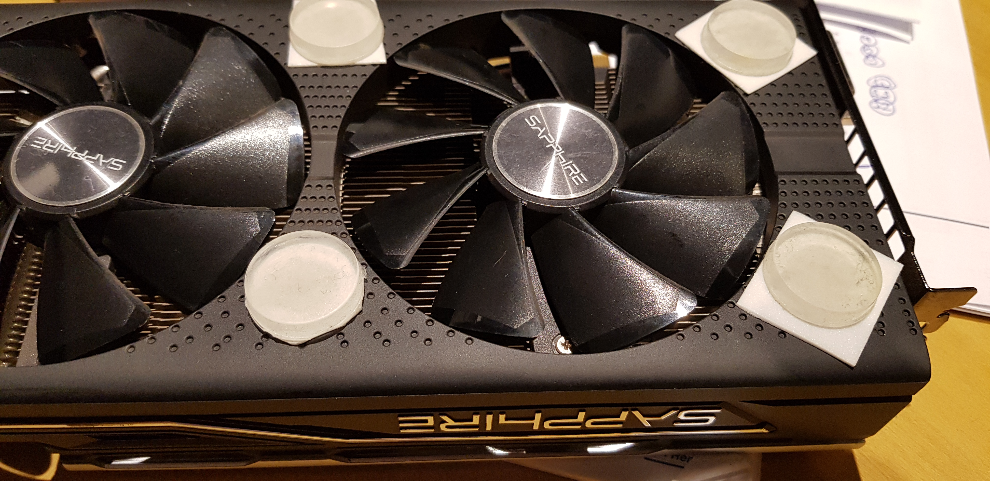

Agree, the PULSE won't completely block slot 2. But it may infringe slot 2.
Anyway, anyone know if the Highpoint 7101A is thin enough to install in slot 2 with a PULSE RX580 in slot 1?

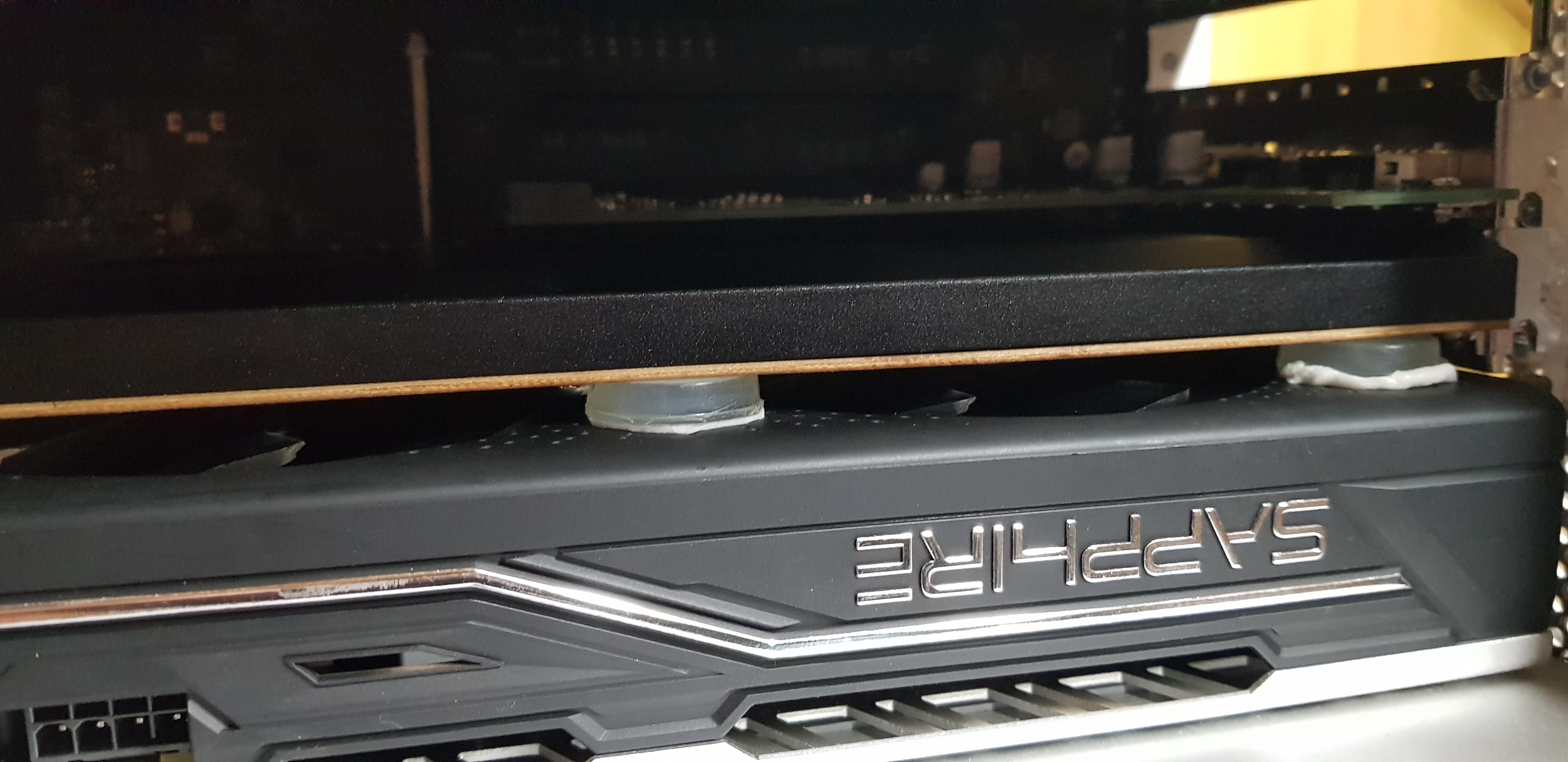

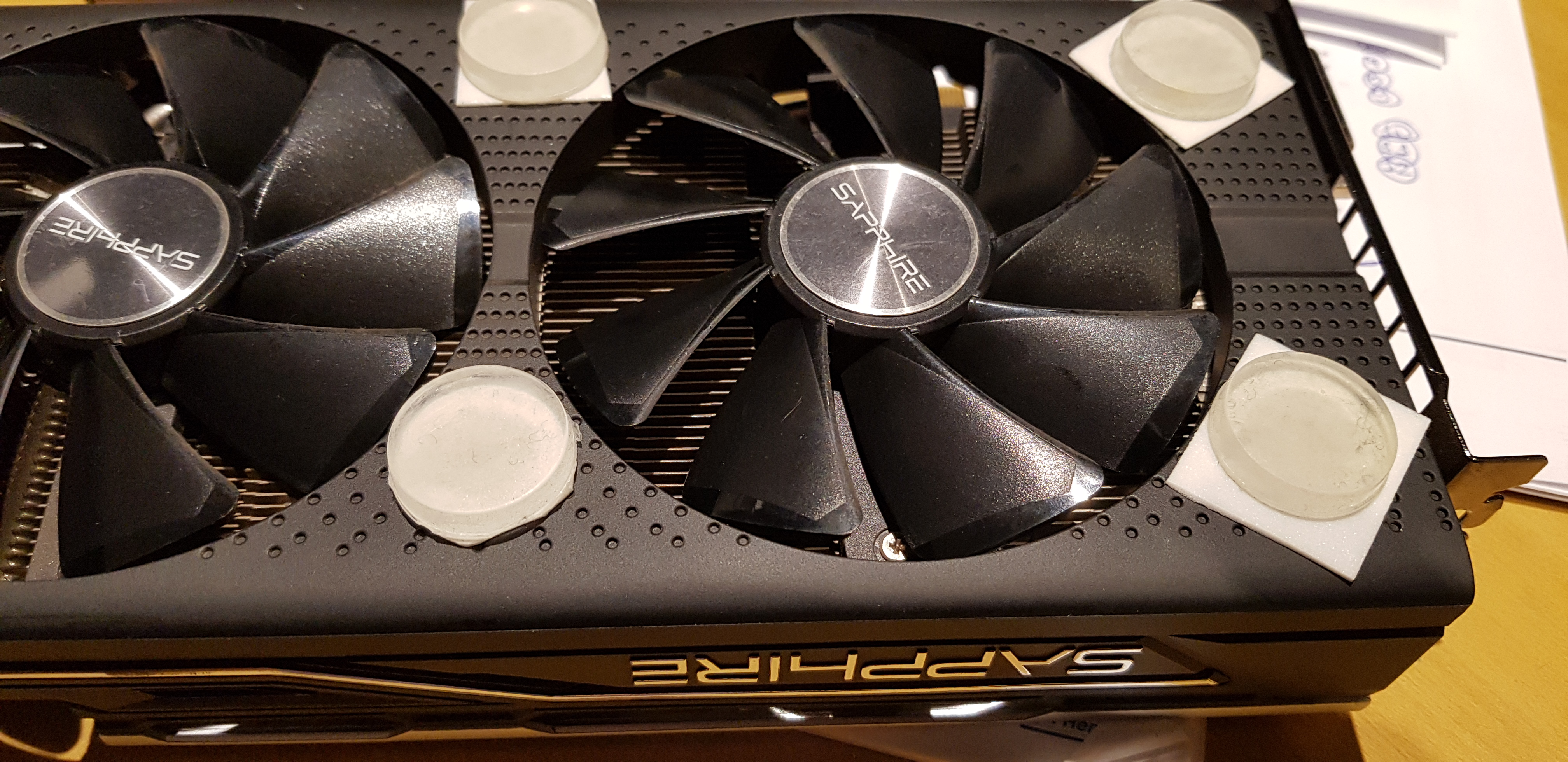

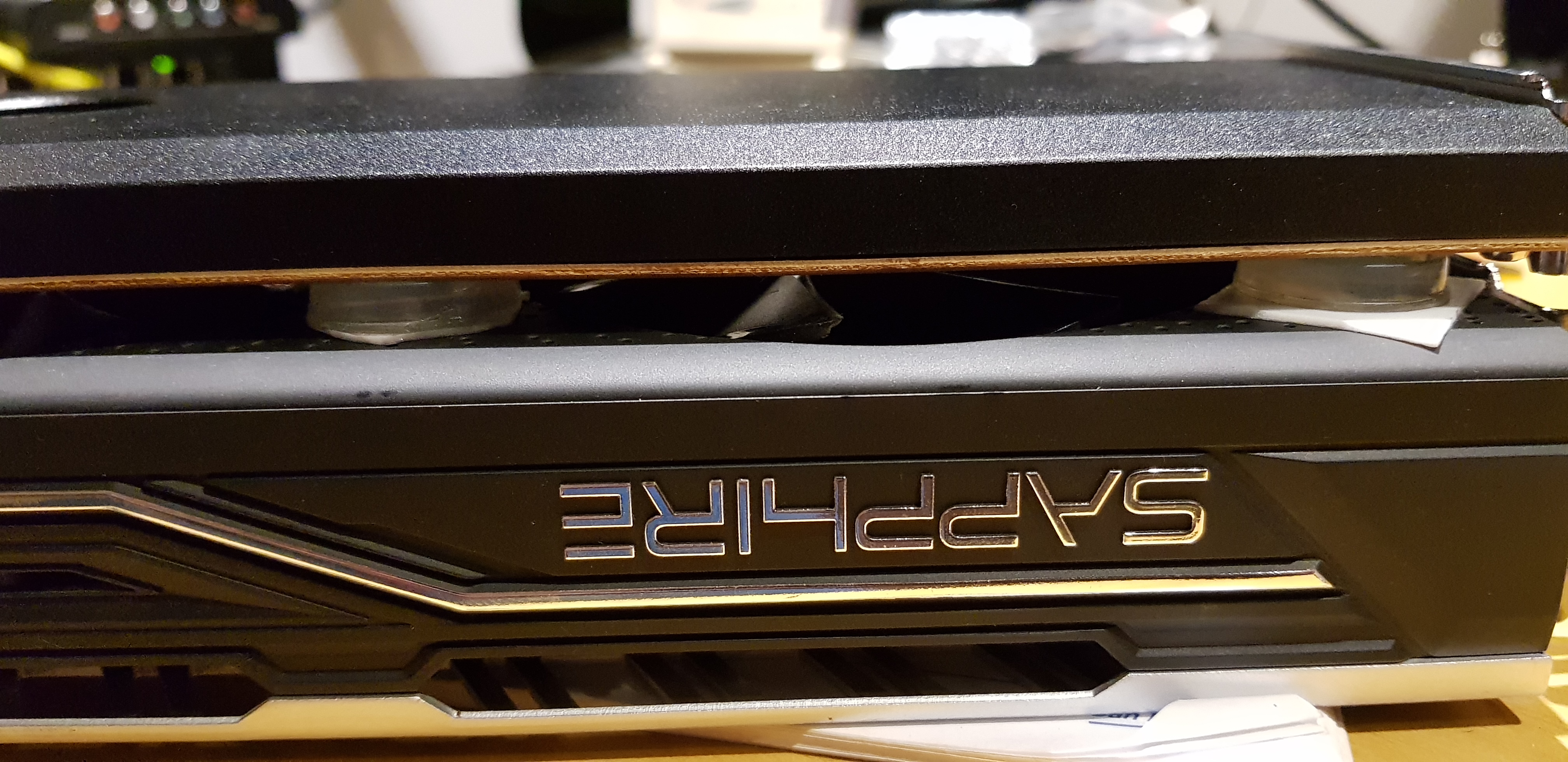

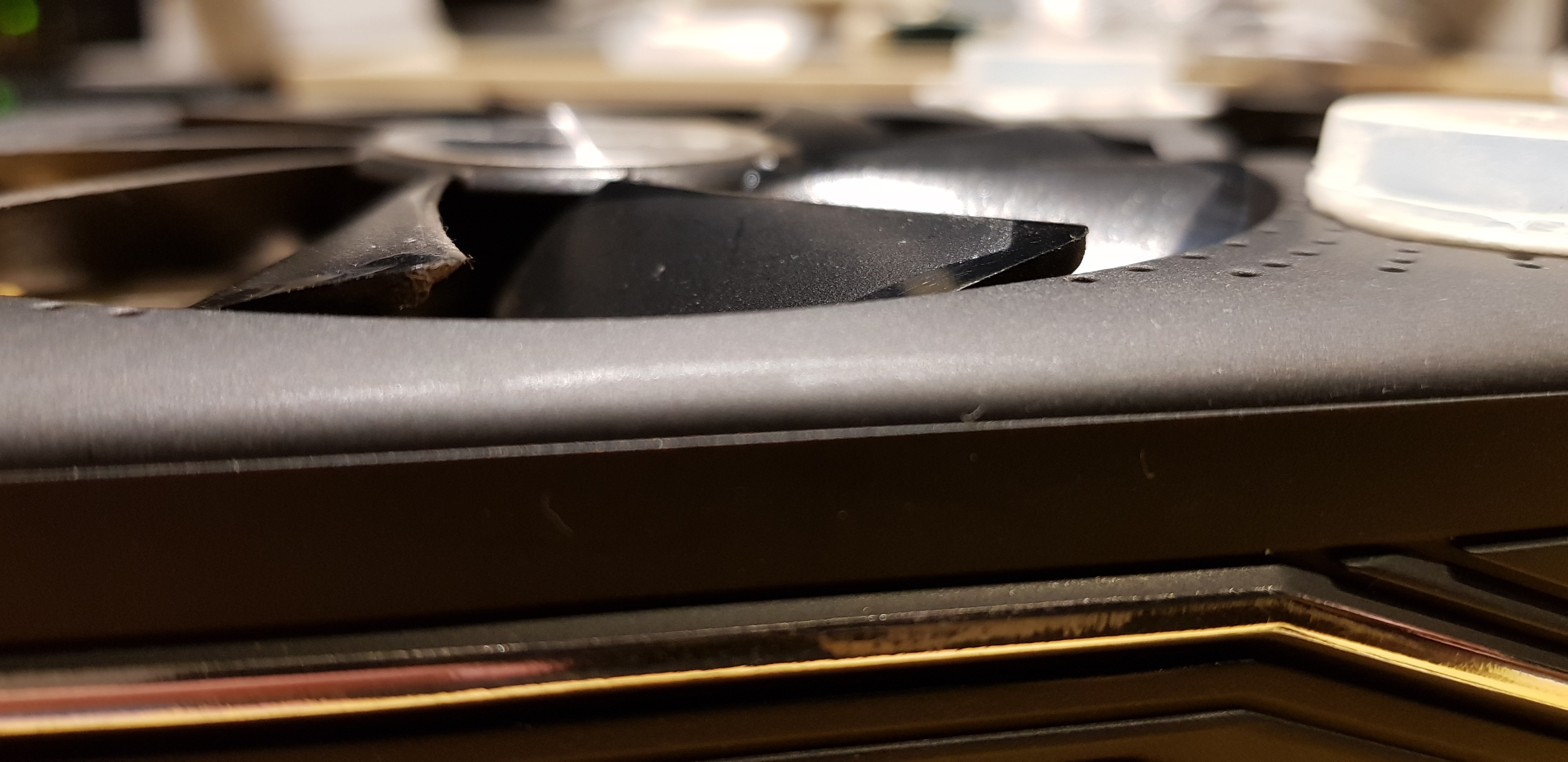

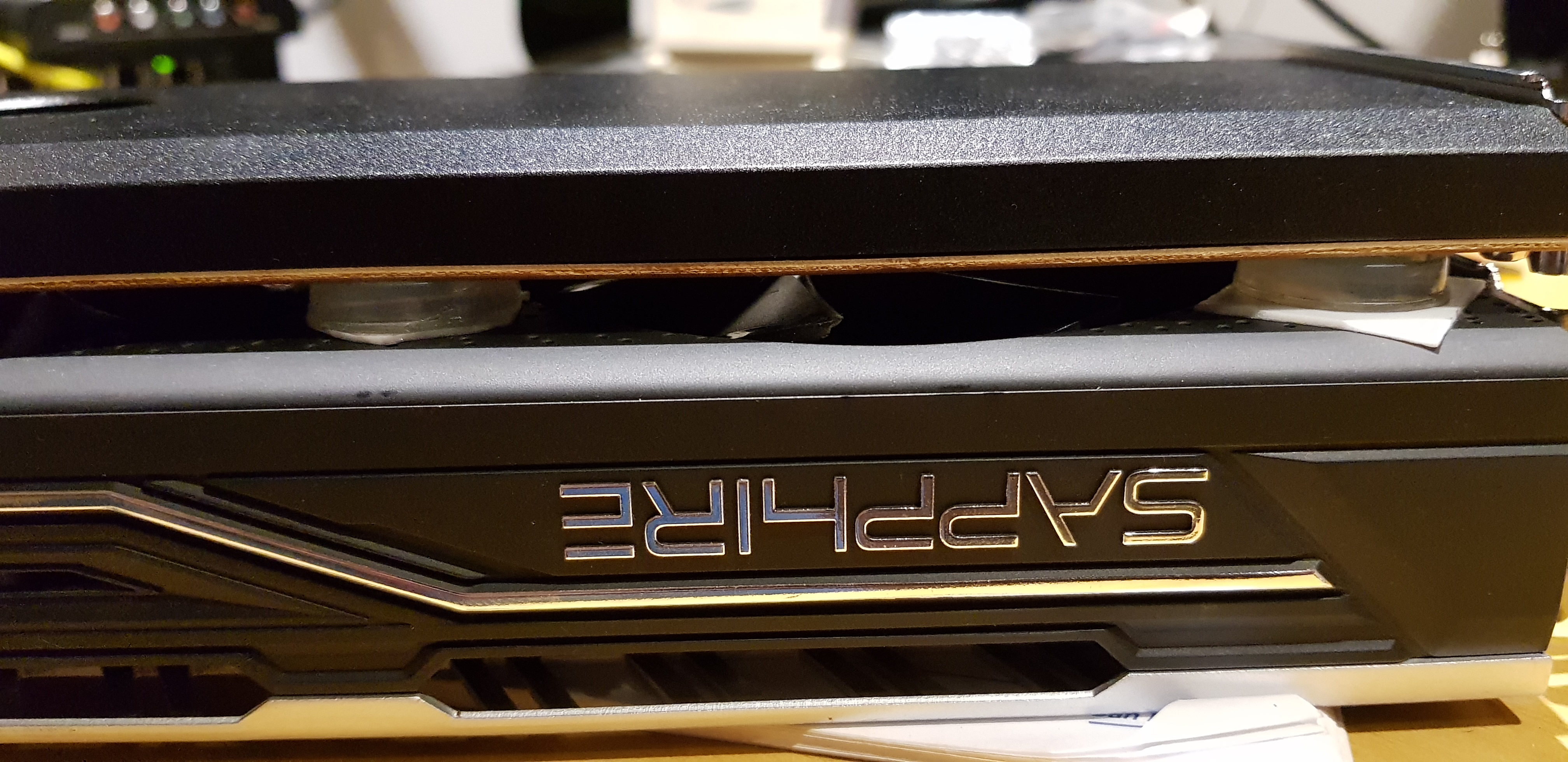

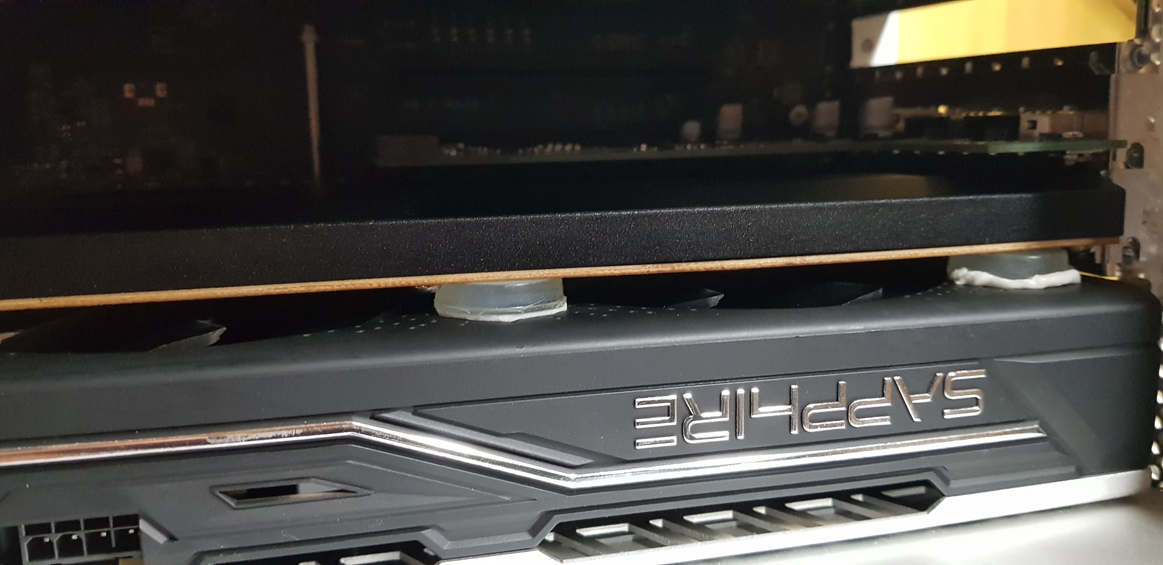

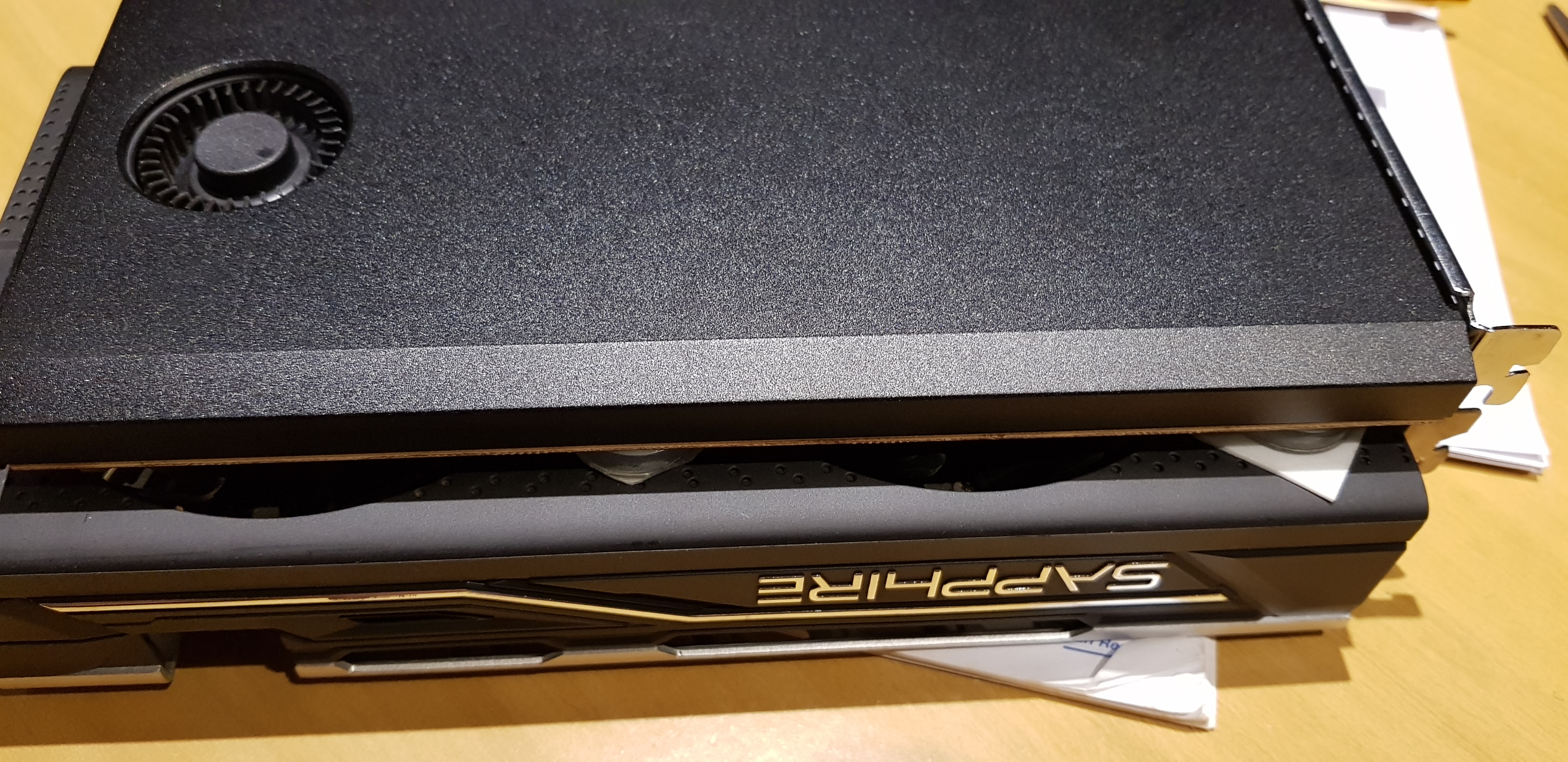

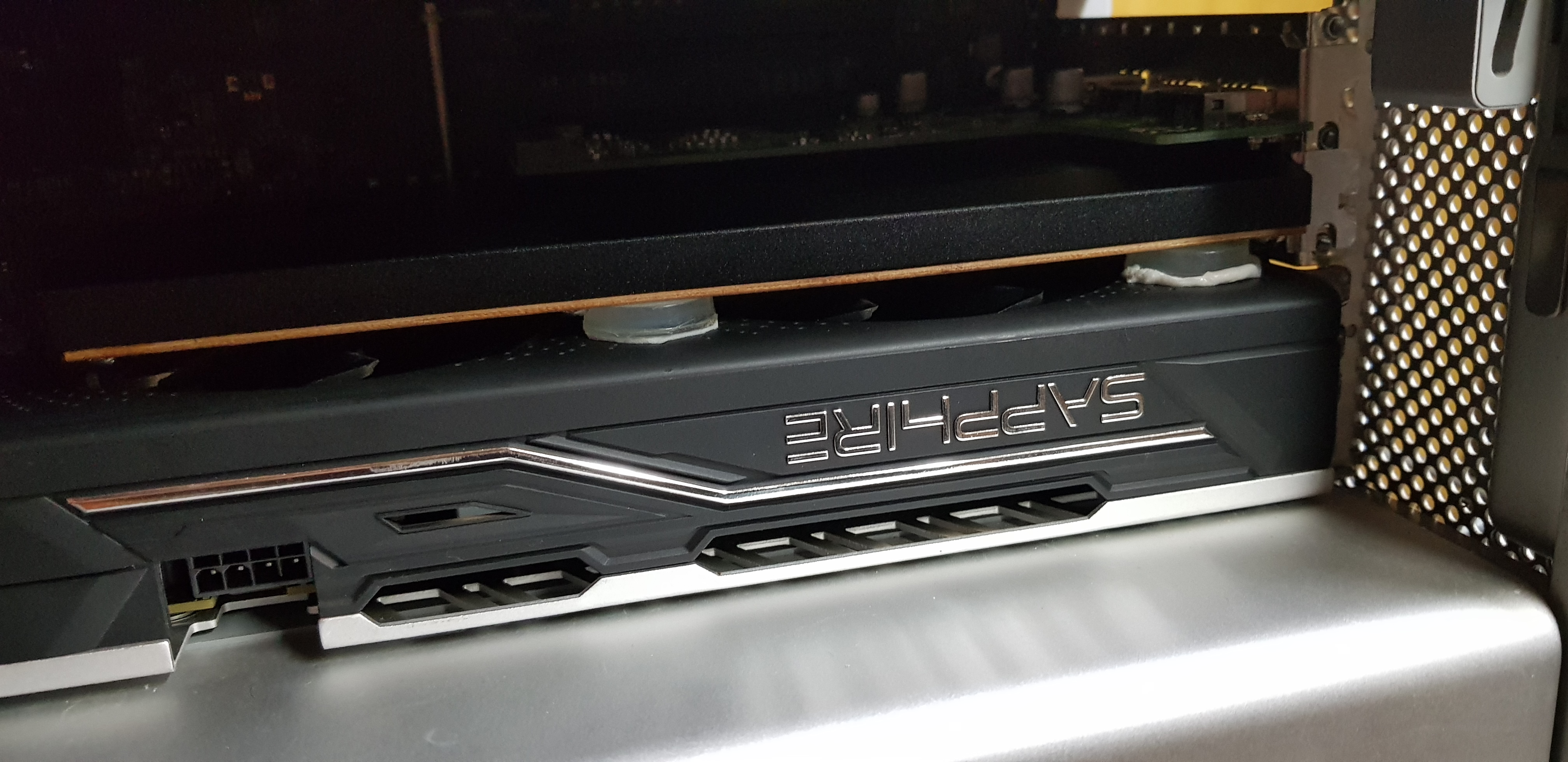

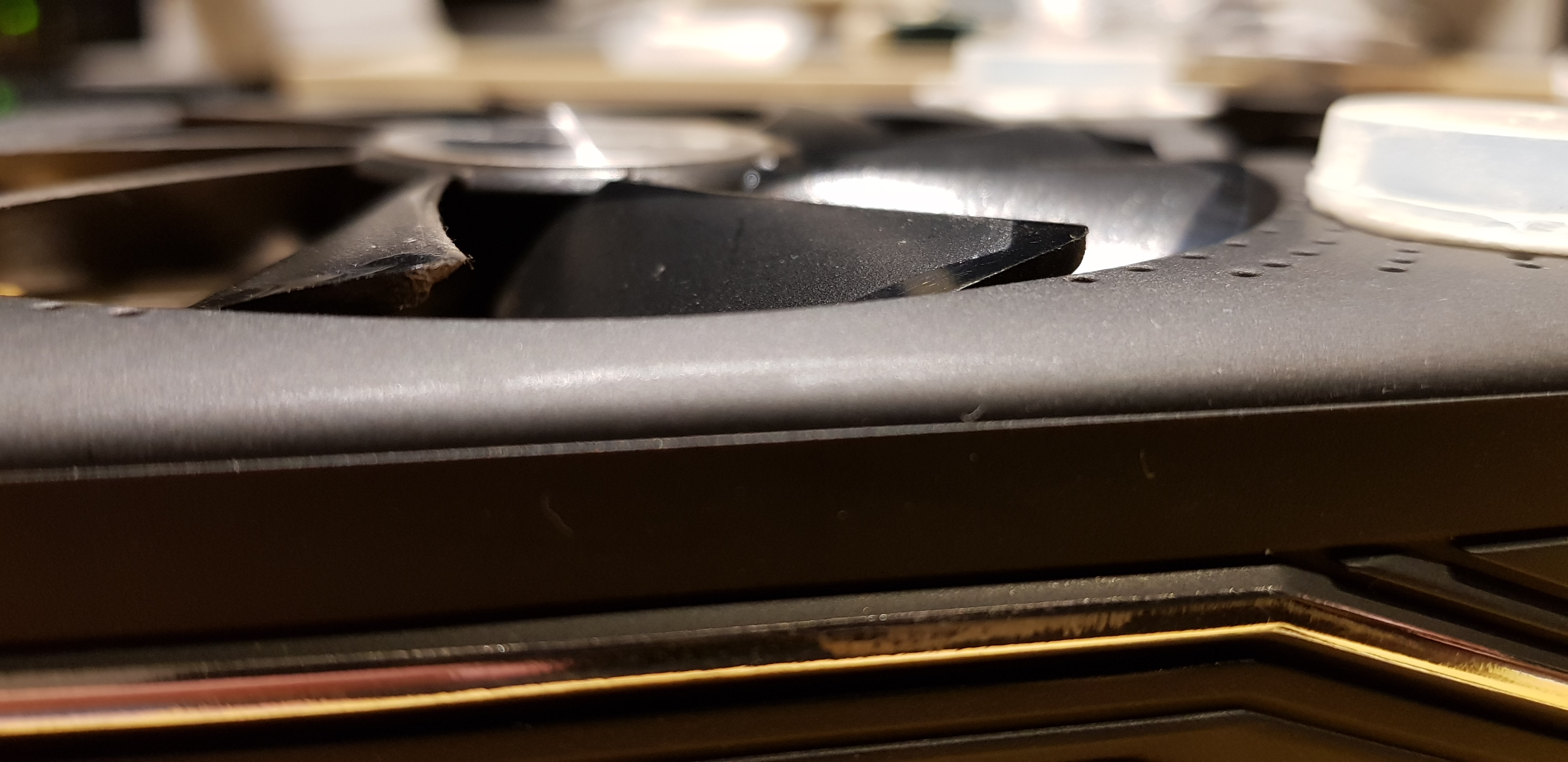

RX 580 fan can interfere with the HighPoint but I have installed it with a simple spacer. Look photos attached ...
that's probably the most tidy solution I have seen for this cramped space issue. what are those pads you used? they sort of look like something you would put on the bottom of chairs so they do not scratch up a hardwood floor lol
This one ...

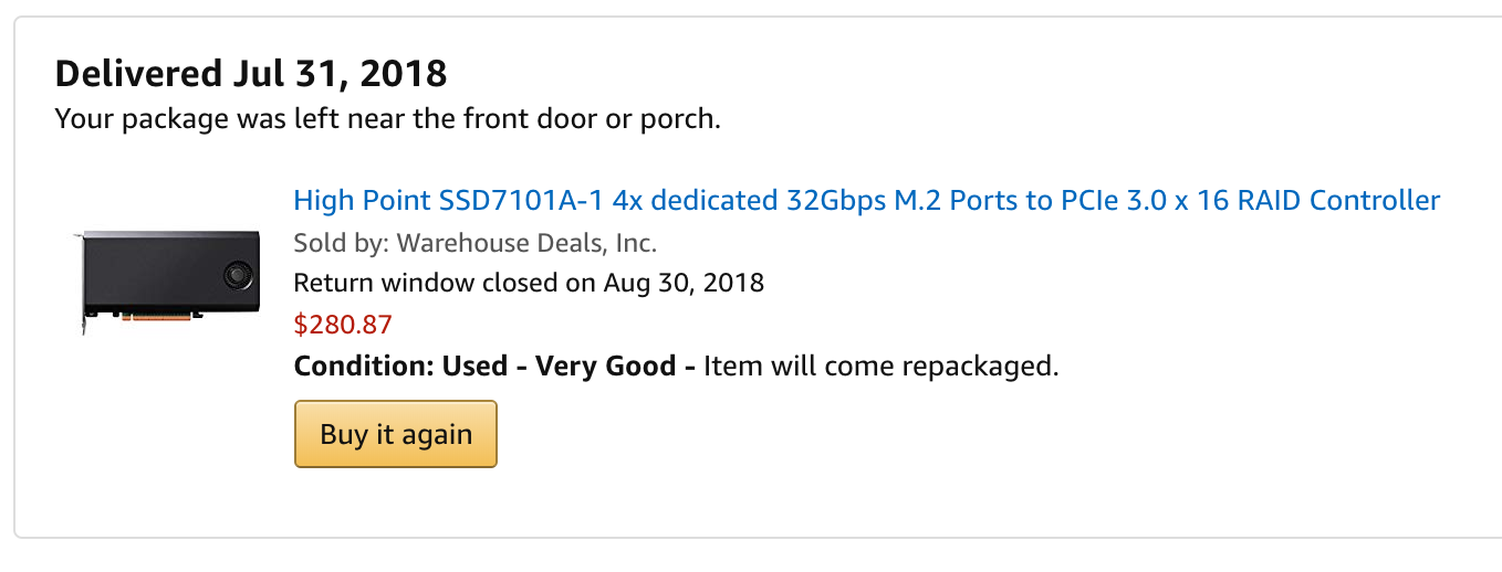

HighPoint SSD7101A was $275 when released on Amazon, now the least expensive card with a PLX switch is $400.
Mine was USD 281 in JUL 31 and now around USD 390.00 ..

This one ...
Your solution is better than the spacers used by my local friend, I really didn't like how he bent his HighPoint card.
I bet with him that he will have problems in the near future.
He bought in June, $275 If I remember correctly.

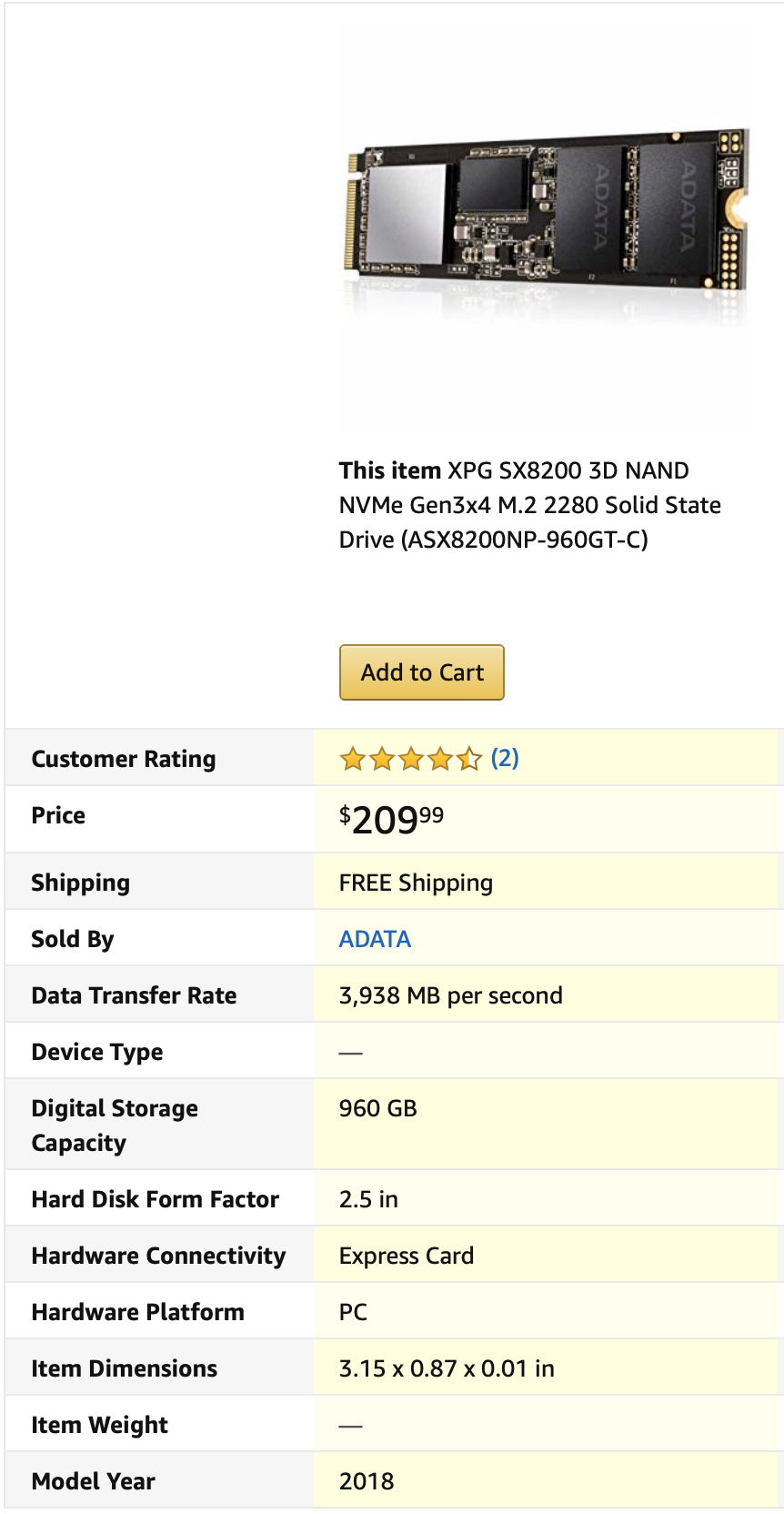

But for NVMe, this Adata SX8220 960GB only cost $210. Direct from Adata, free shipping, metal heatsink included. It really looks like the best "low cost' NVMe option to me at this moment.
I can see you have clearance from the fans but they will not operate properly being starved of air, with that small distance above the fan's there efficiency has been cut in half if not more. as a simple experiment, take a 12v fan say 1000 to 2000 rpm leave it in open air and feel the wind force from the fan CFM, then place a house brick 6mm in front of the fan and feel the wind force again, even better use a small ribbon. you will find that the fan is starved of air and will not be able to move as much air across the heatsink of the GPU for cooling.
the best solution is to swap the GPU to slot 2 where it can breath easy.
That's sure the best solution on cooling, but if the user not often stress the GPU, but want to use all 4 PCIe slots, it may not be best for him to install the card in slot 2 (IF no need to bend the Highpoint card). The RX580's fan may not even spin at all anyway (under low stress).
So, if the user need all 4 PCIe slots, but not extreme cooling for RX580. I think that's still a pretty "balanced" solution. Also, we can further down volt and down clock the card (if the user don't need extreme performance from the RX580), which can further help the situation.
I used a very similar solution. The cabinet door bumpers were the backup to the stacked thermal pads:
https://forums.macrumors.com/thread...-for-pcie-slot-2.2134562/page-2#post-26413743
I can see your point, but I would say if the user doesn't need extreme performance then no point buying a RX580, choose a single slot alternative and have no issues at all.
