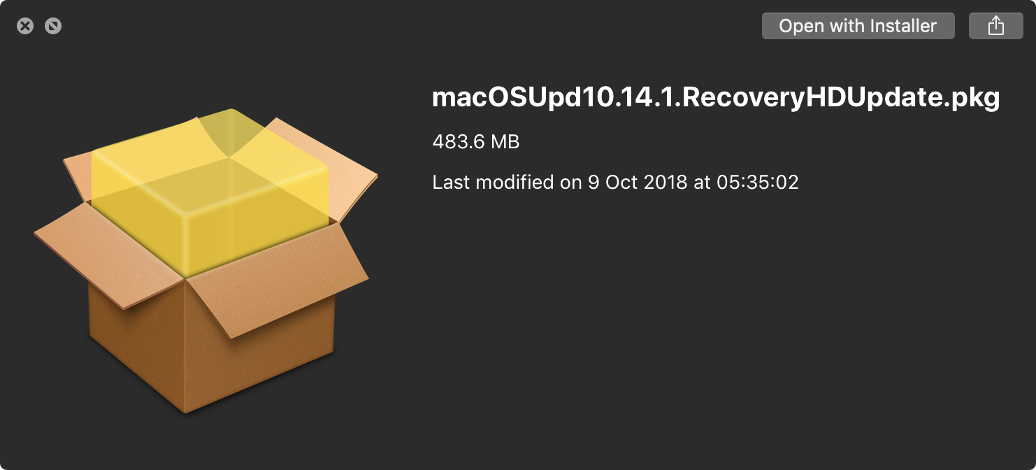

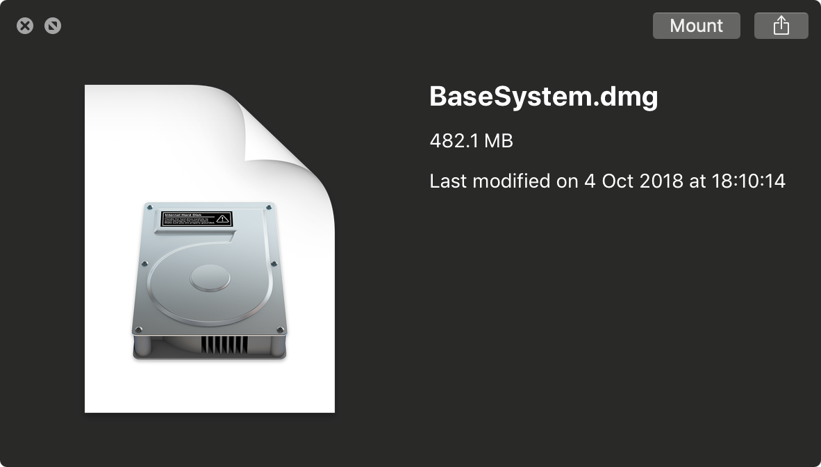

This is pretty much how I do it as well.

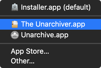

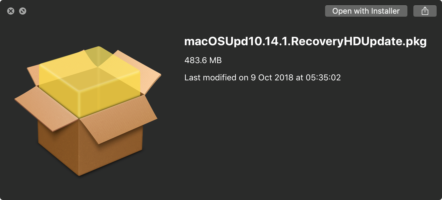

1) Download the macOSUpd10.14.1.RecoveryHDUpdate.pkg (thanks MisterAndrew PM me the link. Just learnt how to search the SUCatalog. Will do it myself next time. Thanks tsialex posted the SUCatalog link, and of course, share all his findings)
2) Right click the file, choose "The Unarchiver.app to unzip it.
3) Inside the "macOSUpd10.14.1.RecoveryHDUpdate" folder, double click RecoveryHDMeta.dmg to mount it
4) Then double click BaseSystem.dmg to mount it. View attachment 793386
5) Double click this "install macOS Mojave Beta.app" to trigger the firmware update. View attachment 793387
6) Then just the usual stuff. Follow the on screen instruction, click shut down, wait 10s, press and hold power button until the long beep, release power button and wait for auto reboot. Anyway, as expected, this can be down with just the RX580, no Mac EFI GPU is required.

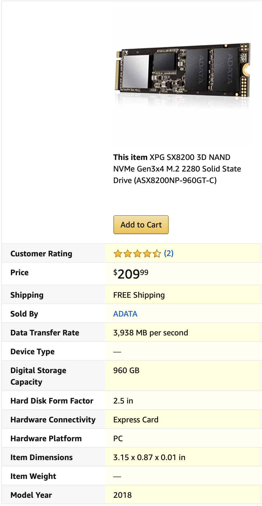

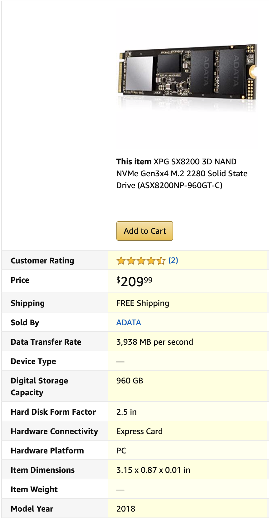

But for NVMe, this Adata SX8220 960GB only cost $210. Direct from Adata, free shipping, metal heatsink included. It really looks like the best "low cost' NVMe option to me at this moment.
What do you think about this?

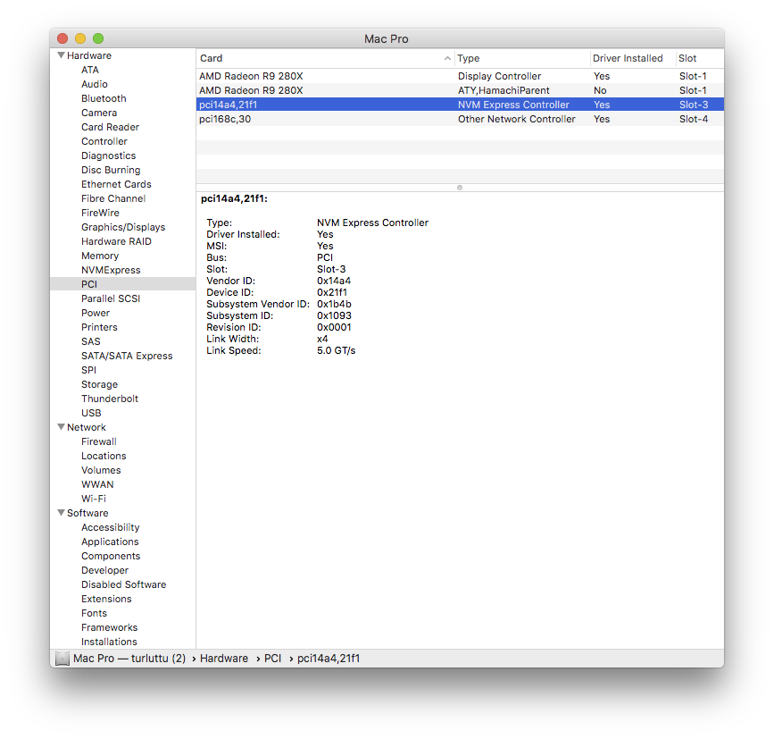

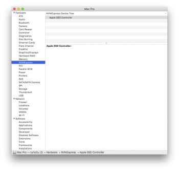

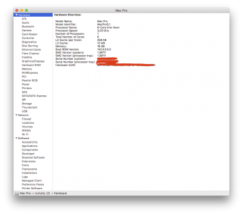

Does not work Plextor M8SE 256GB. Works on Windows. What do you think about this?
Controller: Marvell 88SS1093
Screen Shot 2018-10-09 at 23.19.28.png Screen Shot 2018-10-09 at 22.14.19.png Screen Shot 2018-10-09 at 22.14.48.png
