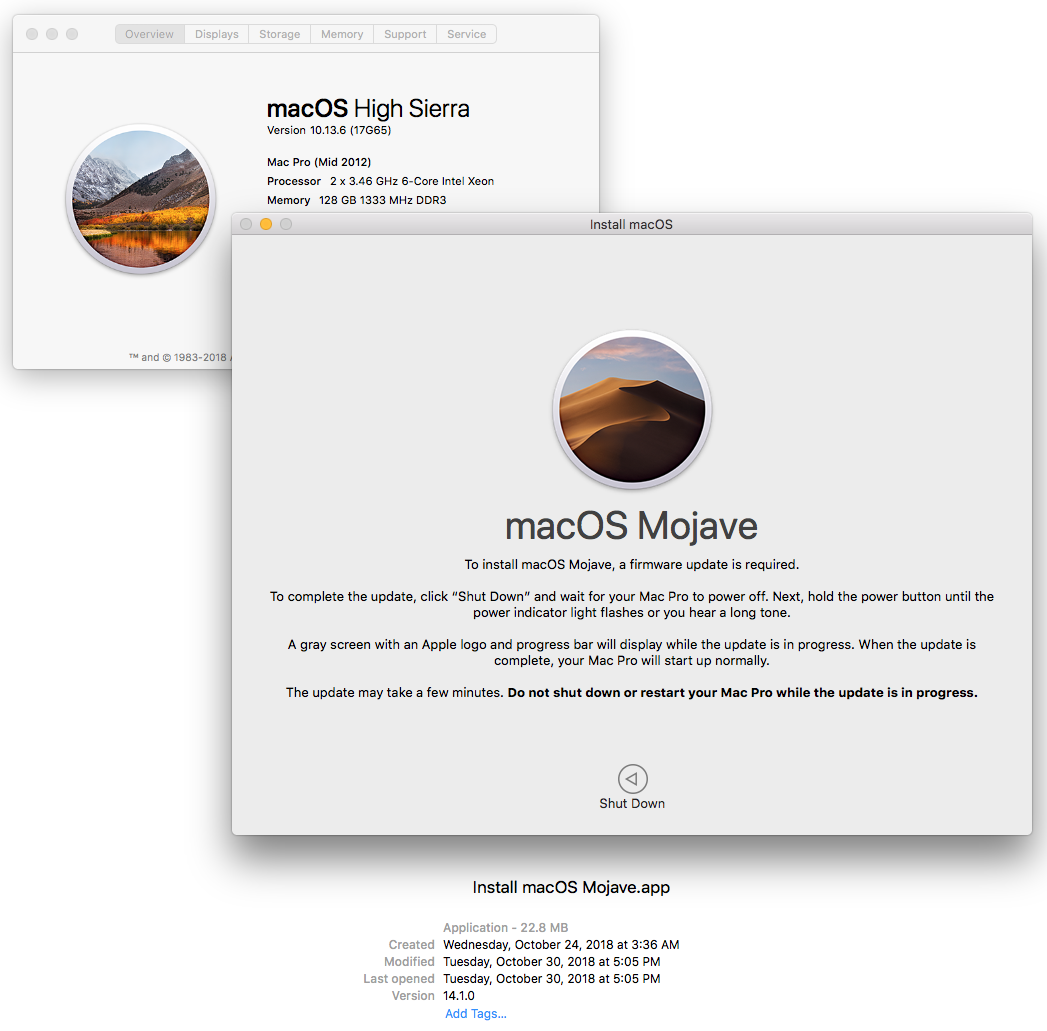

I'm on 10.13.6 with 138 firmware and GTX 1080 FE installed right now. Going to update to 140 firmware shortly. Will report back as soon as I update with the download from Mac App store at 22.8 MB. Waiting for a full system clone to complete before doing anything.
Well, I'm still on High Sierra because of my Nvidia GPU. Just downloaded the full 10.14.1 Installer. Because I have an MVC EFI card that shows loading progress that some folks don't like, I was able to follow the FW updating process, there's a couple of verification steps in there. I'm now on BootRom 140.0.0.0.0. Sure wish there was an Nvidia Web Driver. This situation is just getting silly:oops:

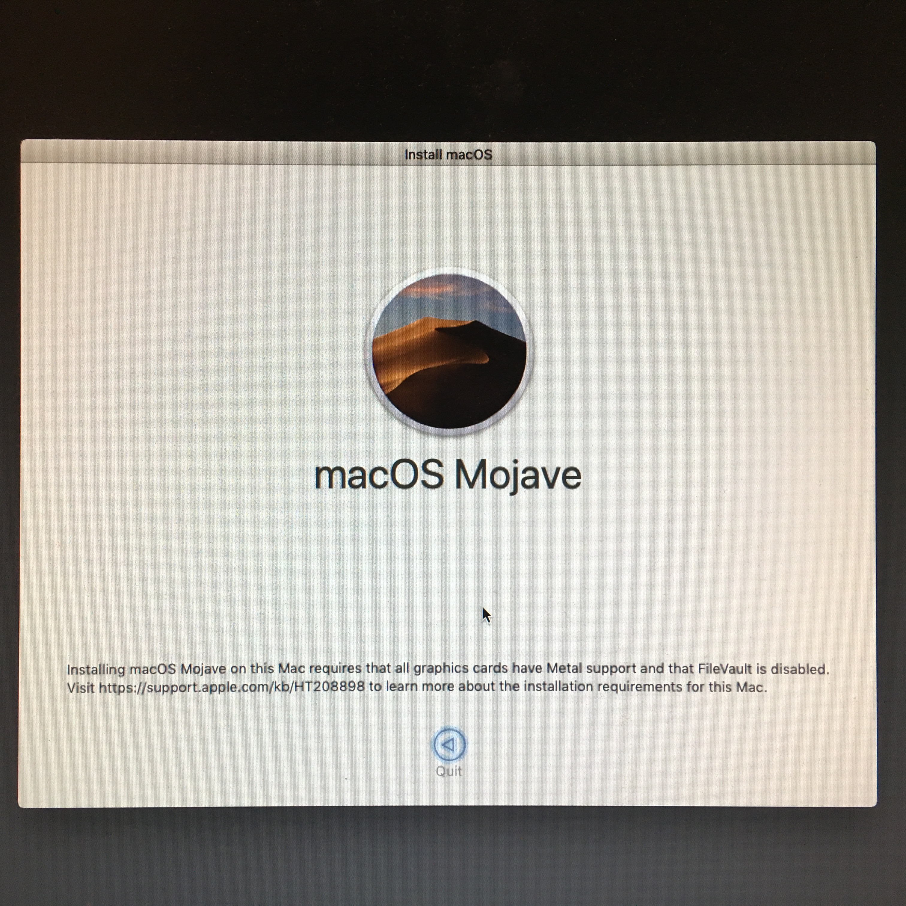

Has anyone tried installing 10.14.1 from USB installer with a GTX 680 yet? If so, does it now work?
FWIW I’m installing from USB with an RX 580 and it works just fine.
Probably not. It looks like it's still restricted to a few cards. The installer won't proceed with my Vega under 10.14.1.
