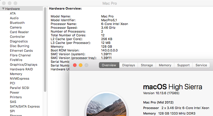

The small 22.8 MB Mojave installer app (downloaded via Mac App Store) worked to update firmware to 140.0.0.0.0 on my authentic MacPro5,1 with GTX 1080 FE installed, running 10.13.6 Build 17G65. Firmware update basically worked as all previous have, but no need for EFI GPU to be installed. System SSD is formatted HFS+ and is a SATA SSD connected via PCIe adapter. CD/DVD drive ejected as usual, but the wait until TONE after blinking power light did take slightly longer than usual/previous.
Overall was a bit more panic on my end, non-sensibly wondering if the rest of Mojave was going to be installed without my desire at this time... but had full bootable clones to turn to if anything went wrong. Figured was worth the shot since I'm one of the "lucky" ones that received this smaller file link to download via App Store.
For anyone else who uses this smaller download in the future, you do need to authenticate a Mojave Helper to install the firmware update.

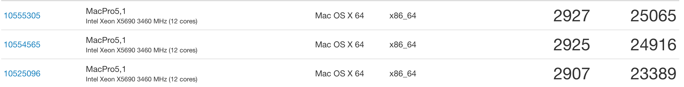

My Geekbench Results
Mojave 10.14.1 >>> 140.0.0.0
Mojave 10.14 >>> 138.0.0.0
High Sierra 10.13.6 >>> MP51.0089.B00
Have 8GB of Ram and S-ATA Disk at the moment and Quadro K600 installed

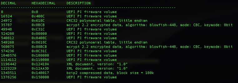

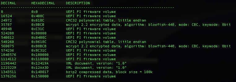

Firmware update problem -
I installed 10.14.1 over the 10.14.1 beta by downloading the full installer from the Mac App Store. Started the 140 firmware upgrade (had 138). I waited for power off, and held the power button until I had flashing LED and then released the power button. I heard the long beep a couple seconds later. The DVD tray never opened. Then it rebooted back into Mojave like normal without updating the firmware or anything else. Still 138.
I repeated the process and this time held the power button until I saw the flashing LED AND heard the long beep. This time the firmware updated and then Mojave 10.14.1 update proceeded normally. I binwalked the BootRom and two XML files appeared. Previously the 138 bootrom was clean with no XML files.
Is this trouble?
Is this trouble?
Your xml files are for documenting purposes after upgrade and they will disappear later just like they did on mine. So you don't have Windows, do you?
