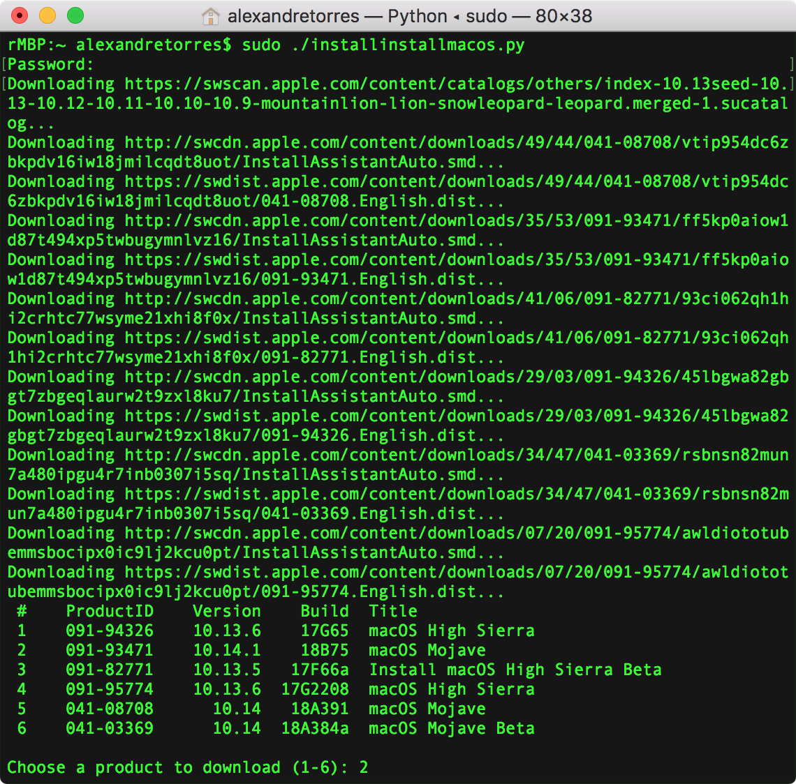

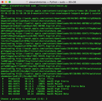

You can use installinstallmacos.py to download the full installer, or you can download the RecoveryHDMetaDmg.pkg.

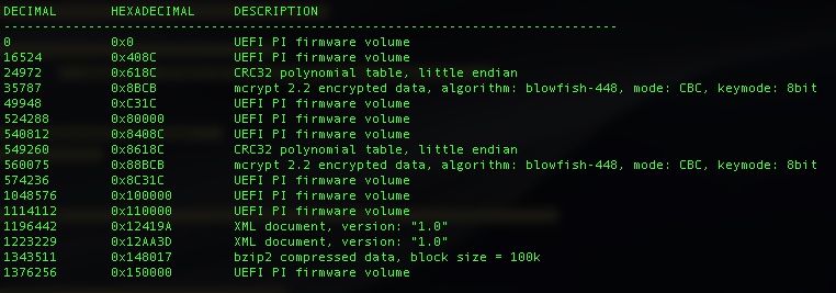

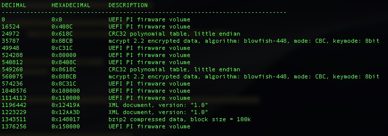

But a Binwalk of the 140 Boot ROM now showed 2 XML files that hadn't been there with the 138 firmware.

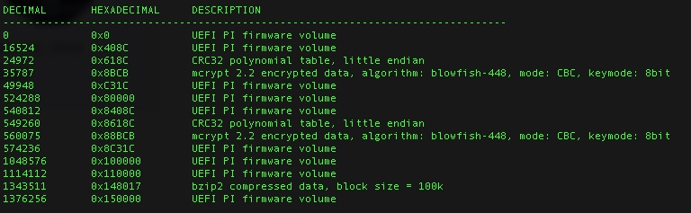

Your xml files are for documenting purposes after upgrade and they will disappear later just like they did on mine. ...

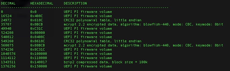

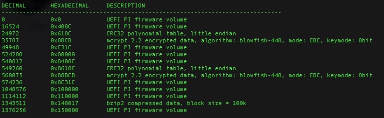

And indeed they did disappear. I'm not sure exactly when but apparently after a couple of reboots. They are gone now and the BootROM appears completely normal.

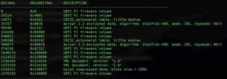

Problem 2 -
