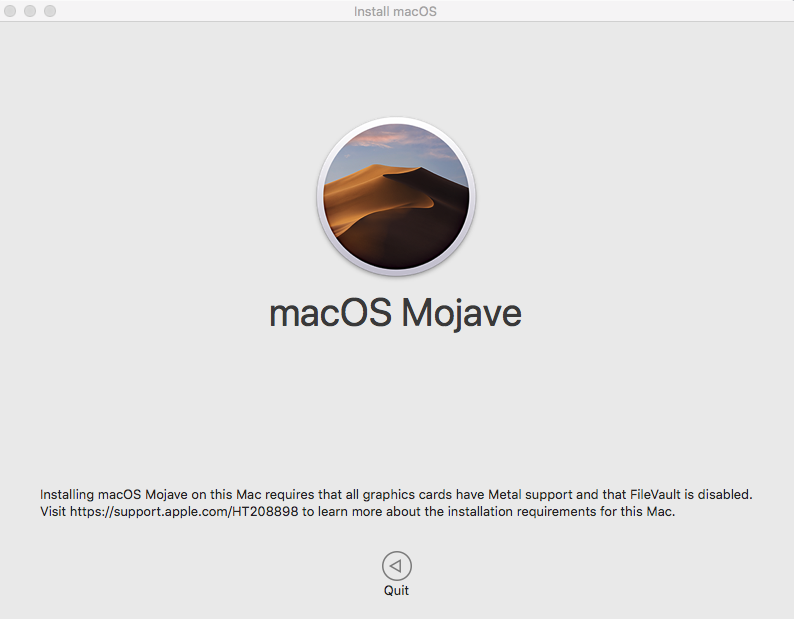

So I updated my firmware via the 10.13.6 installer, but Mojave doesn't allow me to install. Here is my sys report:
Any idea why it doesn't like the video card? Btw, FireVault is indeed disabled.

No, I also have GT 120 installed (the original card with this Mac Pro)
EDIT: Removed the GT120 and it works thanks! Let's see how the install goes!
Key wording from that error message: "Installing Mac OS Mojave on this Mac requires that all graphics cards have Metal support"
(I was scratching my head over the same thing ;))
