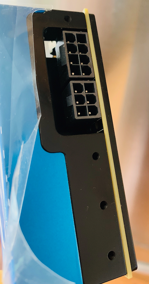

I don’t know how your GPU is electrically connected, but usually or you use two PCIe 6-pin or the 8-pin, rarely both at the same time. You have to check.
About your rant, I know that Apple has a lot wrongdoings with Pro Macs, but none is related with your GPU power requirements. 2009 designers never imagined that in 2018 we will gonna need more than 225W with a GPU or how electrically is connected.
The 9100 has a 6pin and an 8pin connector. One each. So does that mean it might power off just the single 6pin, or just off a single 8pin port?

Here's what it looks like.
I also tried just plugging in one of the 6 pin cables, and I get a horrible shriek, so that didnt work. :D I need to find a 2 female 6 pin to 8pin cable, I guess to try the 8 pin port?

Don’t try just one mini PCIe 6-pin. Buy the dual mini PCIe 6-pin to the 8-pin not this one that you linked.
Thanks so much. I just ordered the one from amazon, should arrive today. (Same day delivery is borderline magic). Fingers crossed. Sorry for the rants. Thanks for the handholding!

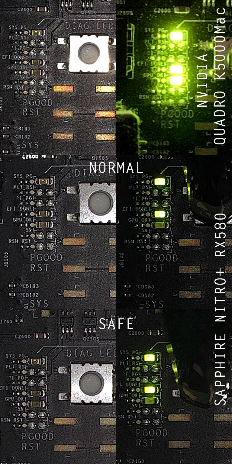

YESTERDAY was an 'interesting' day ...
THE GOOD: While using the Nvidia K5000 Mac card I tried the idea of patching the AppleGraphicsDisplayPolicy.kext by copying the entry for my board ID from the High Sierra version of the kext into the version Mojave uses. (I successfully rebooted with Nvidia card to make sure that it still functioned).
I was able to screenshare with the MacPro while the RX580 was installed and the screenshare showed the correct 2560x1600 desktop. But in NO way - using any connector at any resolution - would the card fire up my Apple 30" Cinema Display, which works perfectly with my Nvidia K5000 Mac card.
THE BAD: After replacing the Nvidia card it repeatedly hung before the login screen.
I decided to start again. I cloned my working High Sierra disk onto my main SSD boot drive and did a re-upgrade to Mojave with the Nvidia card installed. No problems and no requests for firmware updates (as I guess they had previously been done). The machine worked as wells ever it did with the Nvidia card.
UPDATE Post Mojave re-install:
1. I installed the RX580 and SSH'd into the machine from my MacBook Pro and learned that - yes - the Mac Pro does know that the card is present ... readout:

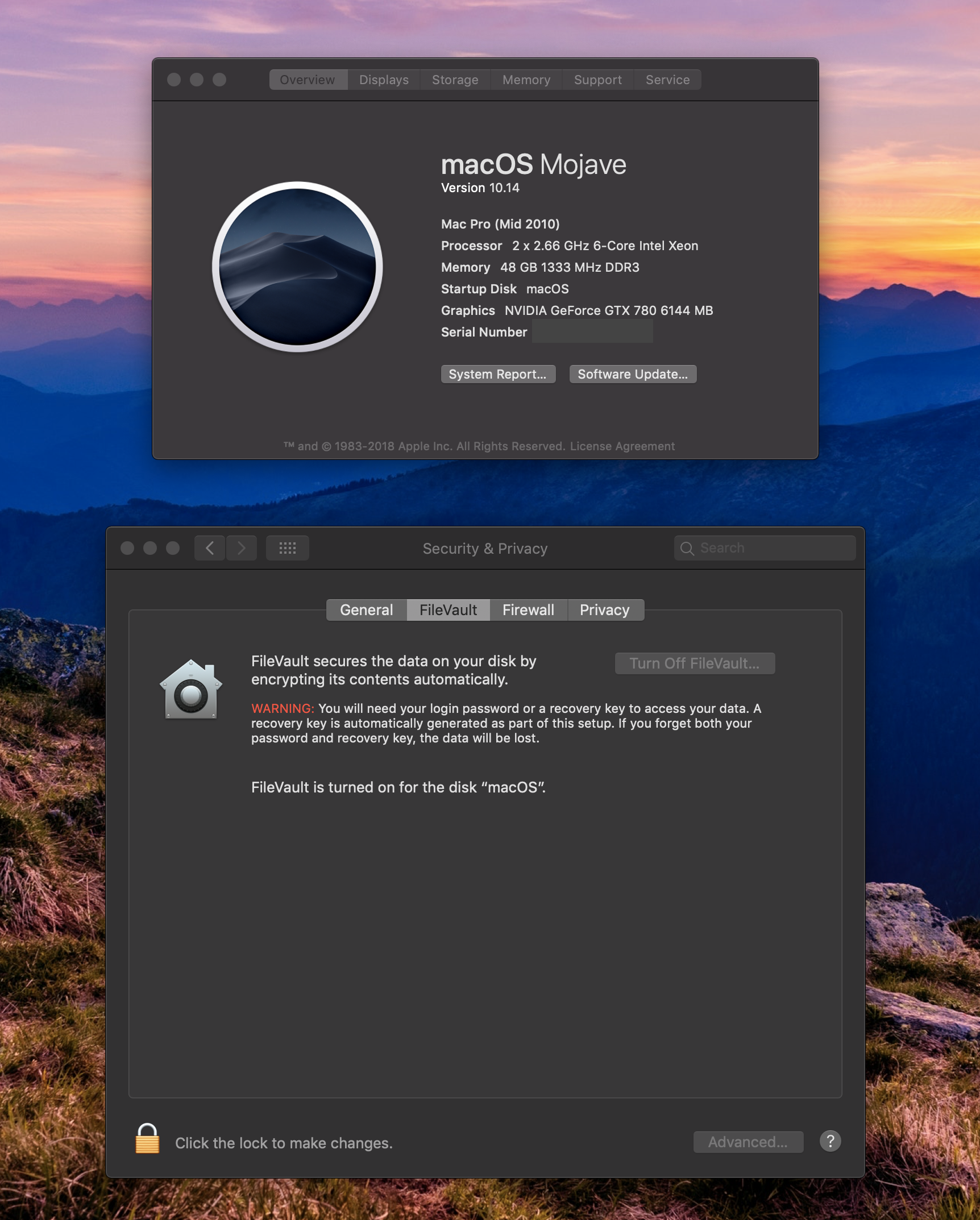

Just a quick update to let those interested in enabling filevault under Mojave know that it is possible but requires a clean installation and a Mac EFI GPU. You cannot convert a current OS drive to APFS encrypted - it will fail so don't waste your time trying.
The process is simple:
1. Create a Mojave USB installer using either the createinstallmedia or @dosdude1 Mojave patcher methods (search forums)
2. Backup whatever data is important to you then boot to the USB installer
3. Run terminal and destroy your installation drive's GPT (partition table) by executing
Code:
gpt destroy /dev/diskX
where X is the number of your installation drive
4. Run Disk Utility and format the drive to APFS Encrypted * No recovery key is set here so make sure you remember your password. A recovery key could be set at a later stage.
5. While the encrypted drive is mounted, install Mojave on it
6. Once the installation is over, reboot and you'll be presented with a 'Disk Password' screen - Enter the password you chose in step 4
7. The second part of Mojave's installation is now progressing and you will be presented with creating users at some stage after which you will be asked to enter the password that is used to unlock your mac's boot volume
8. Complete the installation, restore your data and you are done!
You can verify that filevault is enabled by going to system preferences and selecting the filevault option - it will report that it is enabled ;) I haven't tried disabling it though. Also, the recovery partition boots perfectly!

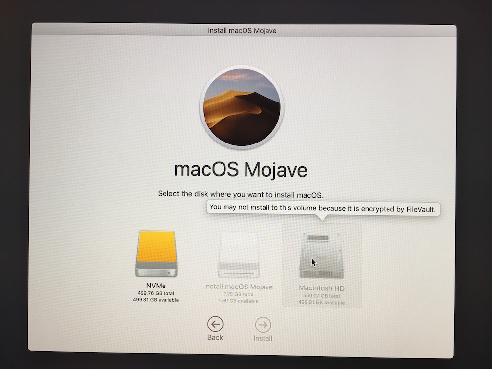

I mentioned this already in the other thread about FileVault, but wanted to report here also now that I have tried again. This method does not work for me, with a USB installer created via createinstallmedia and with a Sapphire RX 580 8GB card installed. I tried this method yesterday afternoon by chance before even seeing your post. The only step I did not do that time was the "gpt destroy" terminal command (but the drive was clean prior to formatting as APFS (encrypted). When running the installer after formatting the disk as APFS (encrypted), at the screen where I am supposed to choose the destination drive, the encrypted disk is greyed out. When I click on it, I get the message "You may not install to this volume because it is encrypted by FileVault"
I didn't think anything of it at the time, because Apple has disabled all other avenues of enabling FV on the cMP in Mojave. So I just reformatted the drive as plain APFS and proceeded with the install.
Then, in reading the new FileVault thread this afternoon you made a reference to this post. I was really surprised it worked for you, so I decided to try again just now. This time, I followed your directions exactly, including gpt destroy. Unfortunately, I ended up with the exact same result.
So at this point, it would be good to try to figure out why it worked for you and not for me. I think you said in the other thread that you used dosdude1's patcher to make your USB installer. So maybe that removes the "If Mac Pro 5,1, disallow installation onto encrypted volume" check--since I'd imagine it disables a lot of the other checks the installer does prohibiting install onto unsupported machines.
The only other possibility I can think of (less likely) is that the installer checks for the presence of an EFI GPU before allowing install onto an encrypted volume. But if that's the case then why didn't they include the same intelligence in the FV control panel so that users with Metal+EFI cards could enable FV after the fact?
Maybe some others can test this to make certain, but my hunch is that the key to making your method work is to use dosdude1's patcher to install Mojave. I bet it disables the 5,1-specific check for an encrypted install drive.
EDIT: Just want to confirm that it's dosdude1's patcher that allows this method to work. I created an installer with his tool and was allowed to install Mojave to my encrypted drive.
So the method W1SS posted does work, but the "magic" of it is dosdude1's patcher modifications to the Mojave installer (which makes sense since his patcher removes the other checks so Mojave can be installed on Mac models Apple no longer supports). The normal createinstallmedia installer will not allow Mojave to be installed on an encrypted volume on a cMP.

Today I tried the following with Sapphire card tests in-between ...
1. Removed all extensions that were not-from-Apple or an Identified Developer. Result: BLACK SCREEN
2. Removed all staged extensions. Result: BLACK SCREEN
3. Removed all user-installed fonts. Result: BLACK SCREEN
4. Turned off-screen sharing. Result: BLACK SCREEN
5. Tested both my NVidia Quadro K5000 Mac and the Sapphire Nitro+ RX580 using the Mac Pro's diagnostic LEDs with some interesting results (photo attached). With the NVidia card installed both the "EFI (is done loading)" AND the "GPU (EFI has configured the graphics card)" LEDs lit up. With the Sapphire card installed ONLY the EFL LED lit, NEVER the GPU LED. This was true in both normal and Safe Mode, although the RX580 does work in Safe Mode.
6. Re-checked power connections to the card ... 2x COMeap Mini 6 Pin to 6 Pin to a GutsParker Premium Braided Dual 6-Pin Female to 8-Pin Male Cable.
I am open to ANY thoughts on why this card will not produce video under Mojave.
