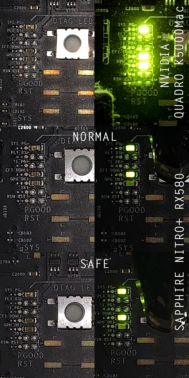

Today I tried the following with Sapphire card tests in-between ...
1. Removed all extensions that were not-from-Apple or an Identified Developer. Result: BLACK SCREEN
2. Removed all staged extensions. Result: BLACK SCREEN
3. Removed all user-installed fonts. Result: BLACK SCREEN
4. Turned off-screen sharing. Result: BLACK SCREEN
5. Tested both my NVidia Quadro K5000 Mac and the Sapphire Nitro+ RX580 using the Mac Pro's diagnostic LEDs with some interesting results (photo attached). With the NVidia card installed both the "EFI (is done loading)" AND the "GPU (EFI has configured the graphics card)" LEDs lit up. With the Sapphire card installed ONLY the EFL LED lit, NEVER the GPU LED. This was true in both normal and Safe Mode, although the RX580 does work in Safe Mode.
6. Re-checked power connections to the card ... 2x COMeap Mini 6 Pin to 6 Pin to a GutsParker Premium Braided Dual 6-Pin Female to 8-Pin Male Cable.
I am open to ANY thoughts on why this card will not produce video under Mojave.
UPDATE: SOLVED - SOLVED - SOLVED Sapphire Nitro+ RX580 now working perfectly.
SOLUTION: The issue was caused by two extensions by (Identified Developer) Avatron Software which made a product called AirDisplay that I once used to allow my my iPad to be used as a second screen. I removed AVVideoCard.kext and AVFrameBuffer.kext and the problem disappeared instantly. I have notified the developer.
By the way, the "GPU OK" LED still does not light but that may be normal (?).

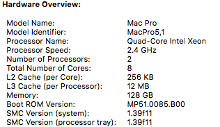

I do have the necessary GPU and am running 10.13.6 with BootROM MP51.0085.B00. I read your full procedure to update to BootROM MP51.0089.B00; however, I cannot find the OSX 10.13.6 disk image file on Apple Store -- it appears to be gone. Any suggestions where to find a copy?
Thanks
Thanks

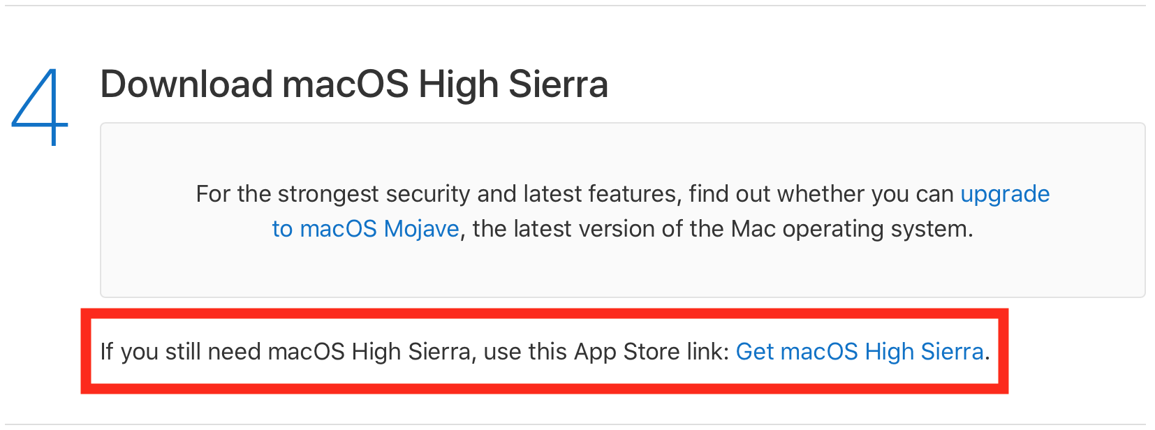

Item 4: https://support.apple.com/en-us/HT208969

Thank you for the link; I was able to download 10.13.6. When I ran the firmware updater, the MacPro shutdown completely after just a few seconds of the screen going black. When I rebooted the MacPro, it powered up and then down and then up again; the old firmware was still present, v85. I was careful to follow the instructions including using an old Samsung SyncMaster monitor (non-DP1.2). I could not locate my old Graphics card, so I left the AMD Radeon HD 7950 for Mac installed.
I have attached the system info FYI.
What could cause this Boot ROM update failure?
Did it shut down while you were holding the power button? When doing the firmware update you should be holding the power button down until you hear the speaker make a beep tone (and the power light flashes). Maybe give it another try.
