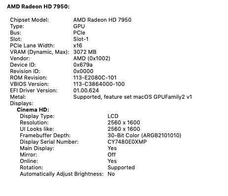

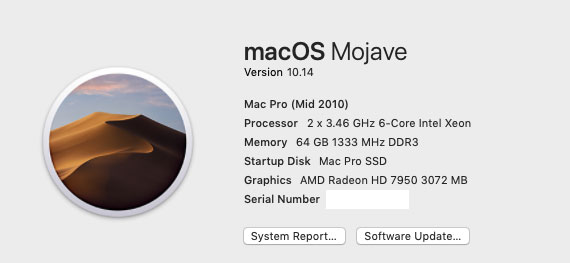

This is my current video card. It is a flashed metal capable card that does show the boot screen. It is great being able to still use my 30-inch Cinema display I bought new in March 2008!

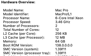

As mentioned, do not recall what the prior firmware was but this is the new Boot ROM. The video card was flashed (see above).

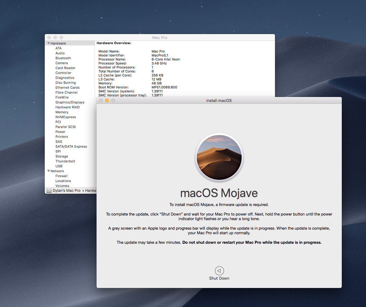

Thanks.. just to let everyone know. I am on 2009 Mac Pro ,4.1 flash to 5.1.. I was already on high sierra 10.13.6 boot rom
MP51.0085.B00. I downloaded the full installer, ran it, it said i needed to update firmware, did the shutdown, held the power button until it flashed, let go, then a beep, machine updated firmware but could not see anything on the screen, it rebooted back into OSX, installer was still open and ready to continue, checked boot rom and it updated to 138.0.0.0.0.
( so for me it updated from MP51.0085.B00 to 138.0.0.0.0.) no issue; but I was already on 10.13.6.

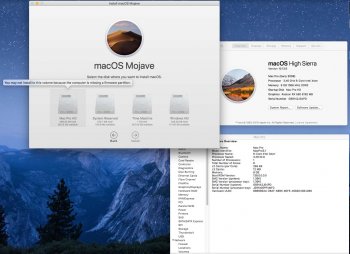

I can't install even though the firmware was updated correctly, here is the error.
"you may not install to this partition because the computer is missing a firmware partition"

What hack did you use to ID as 5,1? Some of the hacks have Mojave updates, including the often used dosdude. Unsure if that’s related or not.
You found the external drive bug. Erase your SSD, remove all other drives, use a createinstallmedia USB key to install. The best way to fully erase is this:
Find what are your SSD disk number.
Code:
diskutil list
Unmount your SSD, replace diskXX for the number you found.
Code:
diskutil unmountdisk diskXX
Fullu erase, replace diskXX for the number you found.
Code:
sudo gpt destroy diskXX
