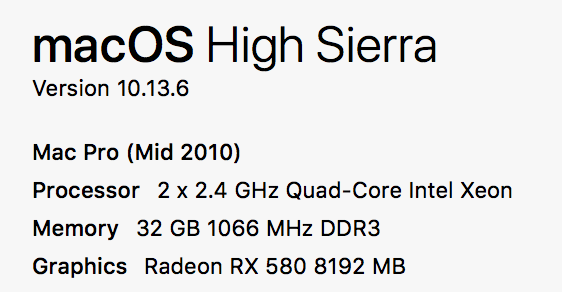

Do you mean did use the internal power cable? Yes
I just tried it and still a black screen. It sounds like my card is not compatible?

with Mojave and the RX580 8GB, I appreciate that you don't see the boot screen, however, will I be able to see the install process? I have the new card coming today and want to make sure it will be ok, as I don't want to get all that way through to fin I can't see the install process at all,
Install and Recovery works.

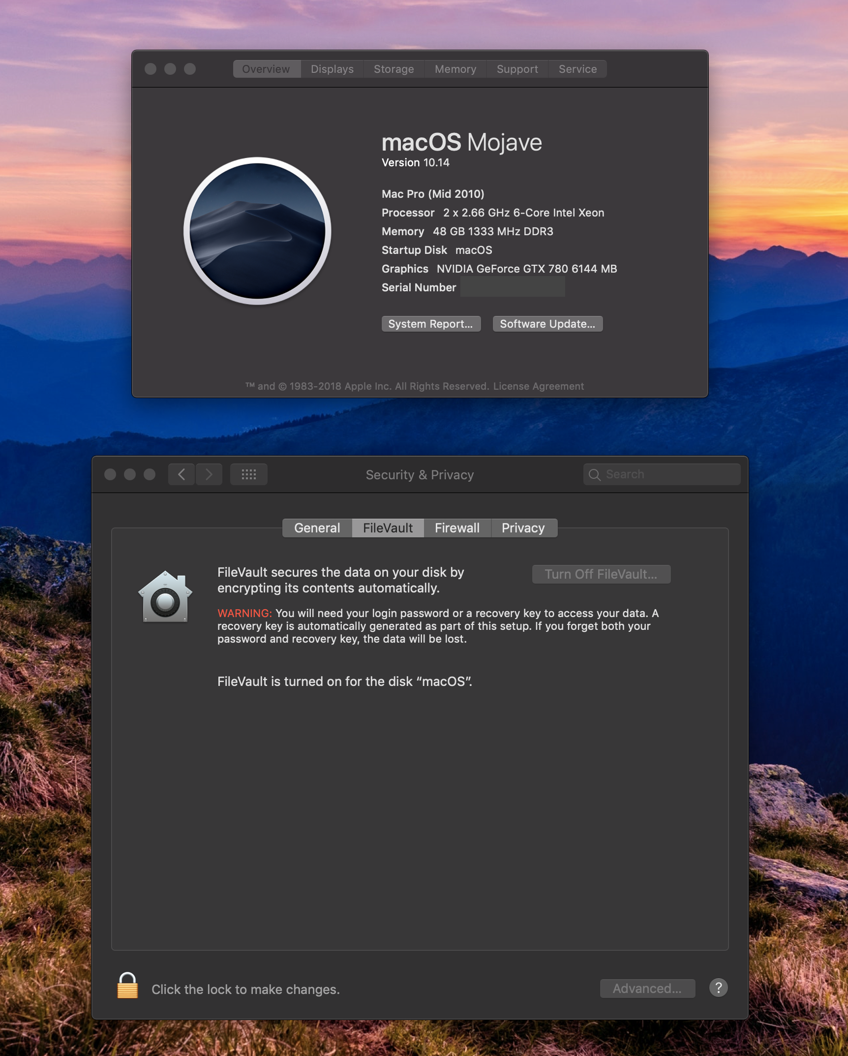

Just a quick update to let those interested in enabling filevault under Mojave know that it is possible but requires a clean installation and a Mac EFI GPU/Graphics card. You cannot convert a current OS drive to APFS encrypted - it will fail so don't waste your time trying.
The process is simple:
1. Create a Mojave USB installer using either the createinstallmedia or @dosdude1 Mojave patcher methods (search forums)
2. Backup whatever data is important to you then boot to the USB installer
3. Run terminal and destroy your installation drive's GPT (partition table) by executing
Code:
gpt destroy /dev/diskX
where X is the number of your installation drive
4. Run Disk Utility and format the drive to APFS Encrypted * No recovery key is set here so make sure you remember your password. A recovery key could be set at a later stage.
5. While the encrypted drive is mounted, install Mojave on it
6. Once the installation is over, reboot and you'll be presented with a 'Disk Password' screen - Enter the password you chose in step 4
7. The second part of Mojave's installation is now progressing and you will be presented with creating users at some stage after which you will be asked to enter the password that is used to unlock your mac's boot volume
8. Complete the installation, restore your data and you are done!
You can verify that filevault is enabled by going to system preferences and selecting the filevault option - it will report that it is enabled ;) I haven't tried disabling it though. Also, the recovery partition boots perfectly!
Cheers

If you mean lack of boot screen, No. As I mentioned in my post, you will need a mac efi flashed graphics card that enables boot screen support for filevault to work on the cMP 5,1.

The way I worded my question and the way you used "no" leaves me still a bit uncertain. I have an HD7950 so a Mac EFi rom is not a problem for me. I was just wondering if your method would show the file vault login screen on reboot.
It should, yes. I got it working on the video card in my sig for filevault login prompt, recovery and firmware/update progress bar. If Apple's usb installer creation method doesn't work for you then try dosdude's Mojave usb installer.
FileVault is not officially supported in MacPro5,1 with Mojave. Any attempt to "make" it work is an unofficial workaround or hack. Hacking an install (via dosdude or other) is almost the exact opposite of what FileVault protection is designed for. If you truly need boot drive data protection, stick with High Sierra or get another machine. If you can accept the "risks" of being without FileVault, then it's a different story...
https://support.apple.com/en-us/HT208898
Turn off FileVault, then install macOS Mojave
Many third-party graphics cards won't show anything on the display when macOS Mojave is starting up, including the Apple logo and startup progress bar. As a result, you can't log in to a system that uses FileVault, choose a different startup disk before your Mac boots into macOS, or perform some hardware diagnostics.
You’ll need to turn off FileVault and then follow the steps to download and install macOS Mojave on your Mac Pro.

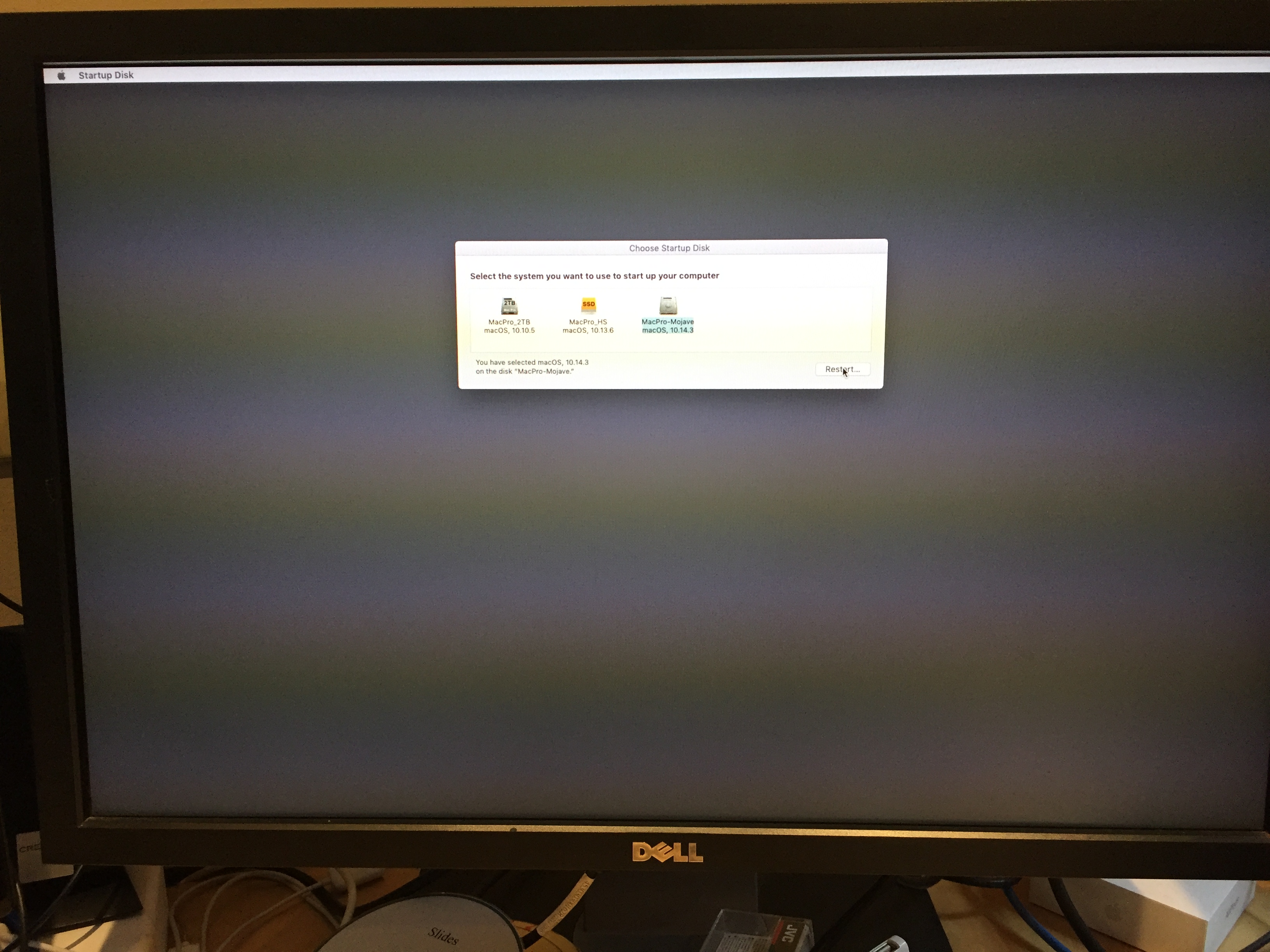

I just tried to install the 10.14.3 Supplemental Update, which didn't seem to work for me. After downloading a large blob (like 800MBs...) I restarted. The screen went dark, for perhaps 45-60 minutes. Later, the system went to sleep. I pressed a key and a screen came up that said, in effect, that MacOS can't be installed on this computer. The this screen came up:
Note this is a 4/5,1, RX580, firmware 140. Software Update wanted to do it again - same result.
I had similar problems with the update to 10.14.4 DP2 and the most recent 10.13.6 Security Update DP. I restored my backup clone for my main disk, 10.13.6, then did the update again, this time worked.
I just reinstalled my Mojave disk with today's reissue of 10.14.3.
I had no issues installing the supplemental update as it was applied like any other update. It appears to vary from one hardware setup to another.
Reactions: crjackson2134
Seems the update itself must be buggy. I updated mine without this issue. I have another 2 copies of Mojave installed. I’ll try each and see if they all update correctly.
I had this same problem but I got passed it successfully.
It got stuck while trying to shutdown. After waiting for maybe 20 minutes, I impatiently pressed OPTION+CMD+ESCAPE and then Relaunch Finder. As soon as I did that, my cMP shut down. Then I got the Apple Logo screen with Installing Software Update where the progress bar stayed stuck at about 5-10%. After waiting for another 30 minutes, I grudging hard powered down my system (which was painful to do considering it was in the middle of a software update). Fortunately, it booted back up in Mojave without the update applied. I then went into About This Mac, Software Update, and relaunched the update. This second time it powered down properly and started back up into the update and was completely responsive through the whole process. It did several reboots and then it came back up with the Update applied. Not sure why it worked the second time and got stuck on the first. I would strongly recommend to others to make a complete clone of your Mojave partition using something like SuperDuper before attempting today's 10.14.3 Supplemental 2 System Update considering there are multiple reports of it locking up for us cMPers.
