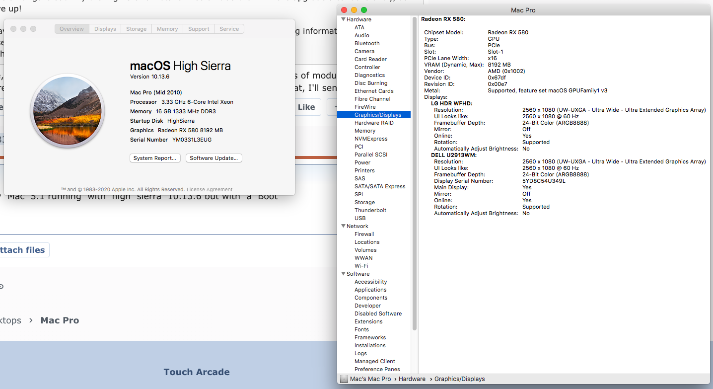

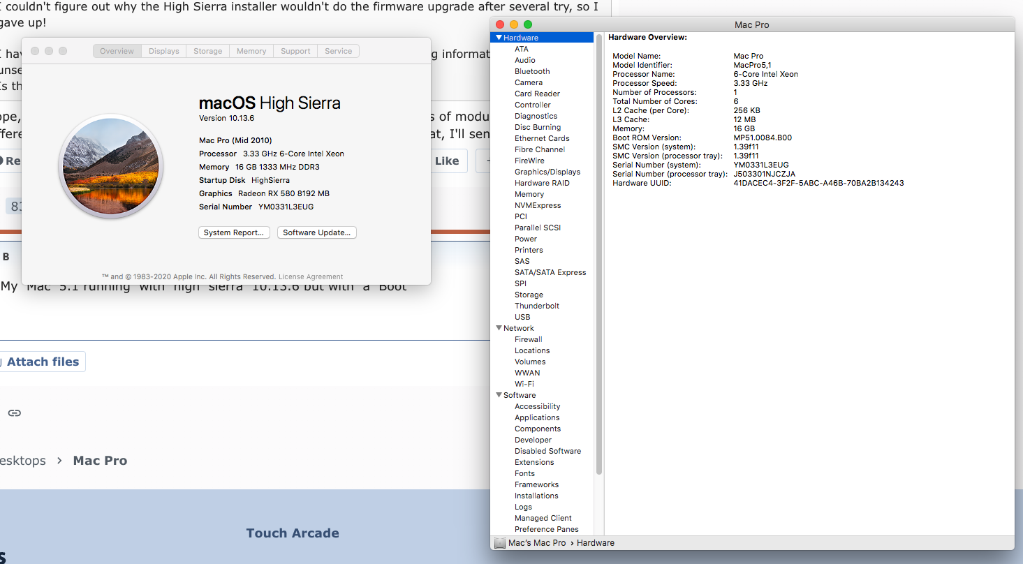

My Mac 5.1 running with high sierra 10.13.6 but with a Boot Room MP51.0084.B00
Could i go ahead and up grade to the Boot Room 144.0.0.0.0 from the Mojave ?
