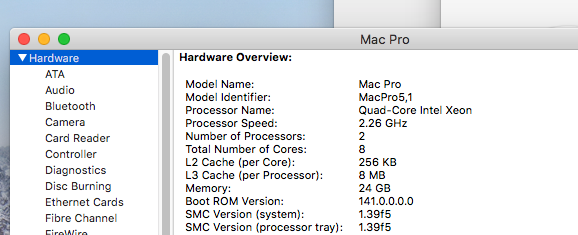

fabio67
macrumors newbie
Aug 5, 2009
8
2
a step forward
