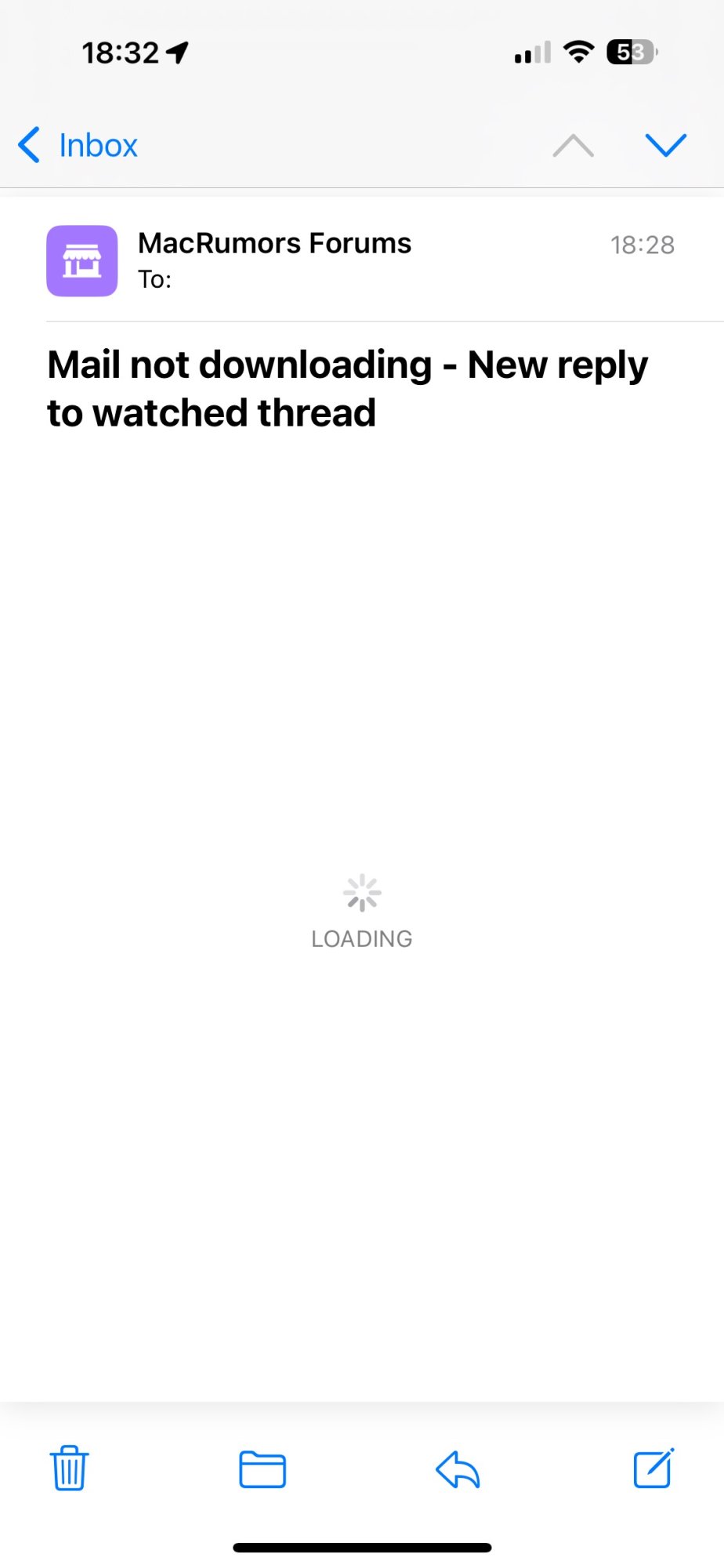

This is what my notification email looked like a few seconds ago from the reply above. The fix is to force close and re-open mail. It will then work for a couple more hours or minutes…

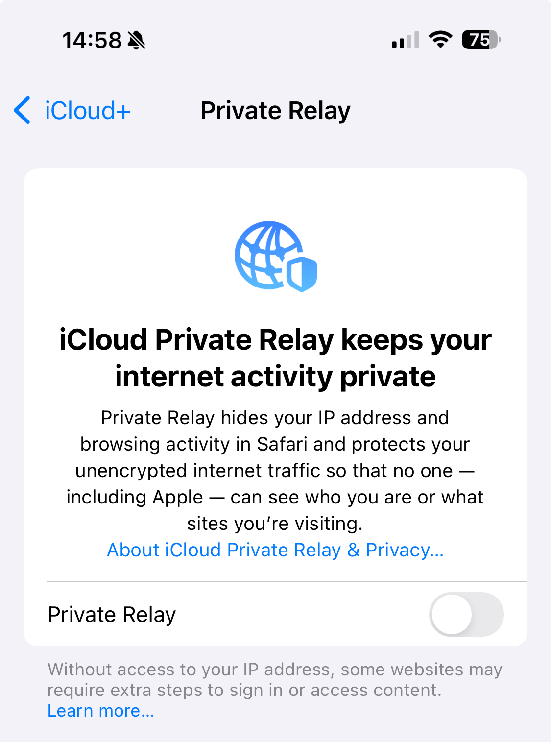

I did find some update to my situation. At home I use pihole, after setting block iCloud private relay to false the mail app is working just fine at home. I was able to receive emails a minute after they were sent and it works just fine on my iPhone and iPad. So my issue was partially because pi-hole was blocking private relay and for some reason the mail app is using the same technology or servers private relay is using and was getting blocked.
I am not sure why I get the same issue when I visit Disney and the grocery store and use their wifi unless they are blocking the same servers.
Thanks for the tip. Using iOS 18.2 and allowing iCloud Private Relay through my local DNS has restored full IMAP Mail functionality back to how it was before iOS 18.2.
I use a third party email provider so I wonder why it needs access to Apple's Private Relay servers. Maybe the categorization feature? (even after disabling the "Categories" view). Or maybe it's the "Mail Privacy Protection" feature.
Either way, it really shouldn't cripple basic email functions when the relay servers can't be accessed.
Are you saying to turn this on?
I had this same problem with PiHole. It was blocking a few variations of *.icloud.com, so I added iCloud to the DNS whitelist in Pihole, and the problem seems to be solved.
