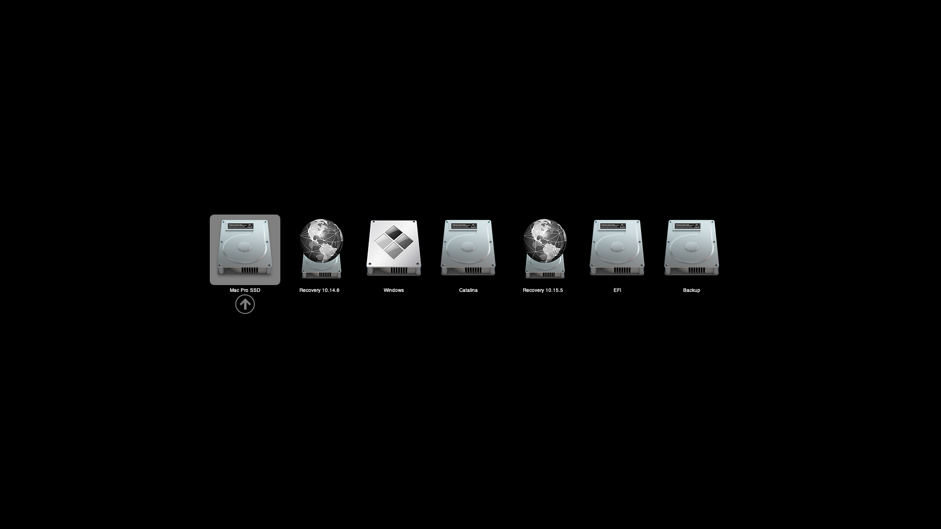

Hi there! this works great! only a few questions left:
1. How to fix the Mac Pro's (mid2012) internal wifi-card?
2. How to fix the optical drive?
3. In the boot-picker screen my Catalina icon is named "catalina", but the Mojave icon is called "test".
Any one encountered these problems as well? Any suggestions would be great!
Thanks a lot (especially for this great post!)
Catalina does not have the AirportBrcm4331.kext in the IO80211Family.kext plugins. You can add the Mojave version to the Catalina plugin. Dosdude1's patcher can do this for you. Alternatively upgrade the hardware to a BCM94360CD as this works OOB with Catalina. Many have done this and it has the benefit of giving you all the handoff/continuity features. A thought for @cdf - can the AirportBrcm4331.kext be added to the Kernel part of OC to do this for members who wish to keep the old wifi card working in Catalina?
What problems are you having with the optical drive. Mine works fine.
