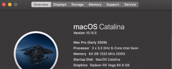

Thank you! Great guide! Catalina up and running with everything working but SideCar. Do we have anything to make that work? I'm not sure I would use it but part of the joy the whole MacPro 5,1 experience is making everything work. Thank you, again!

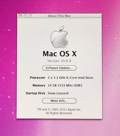

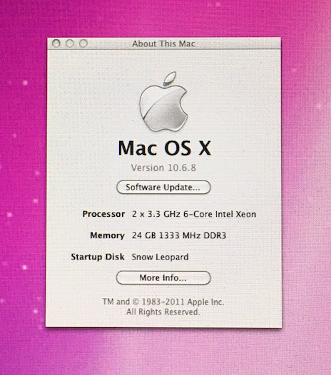

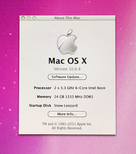

Confirmed. Snow Leopard through OC with an RX 580 works beautifully.

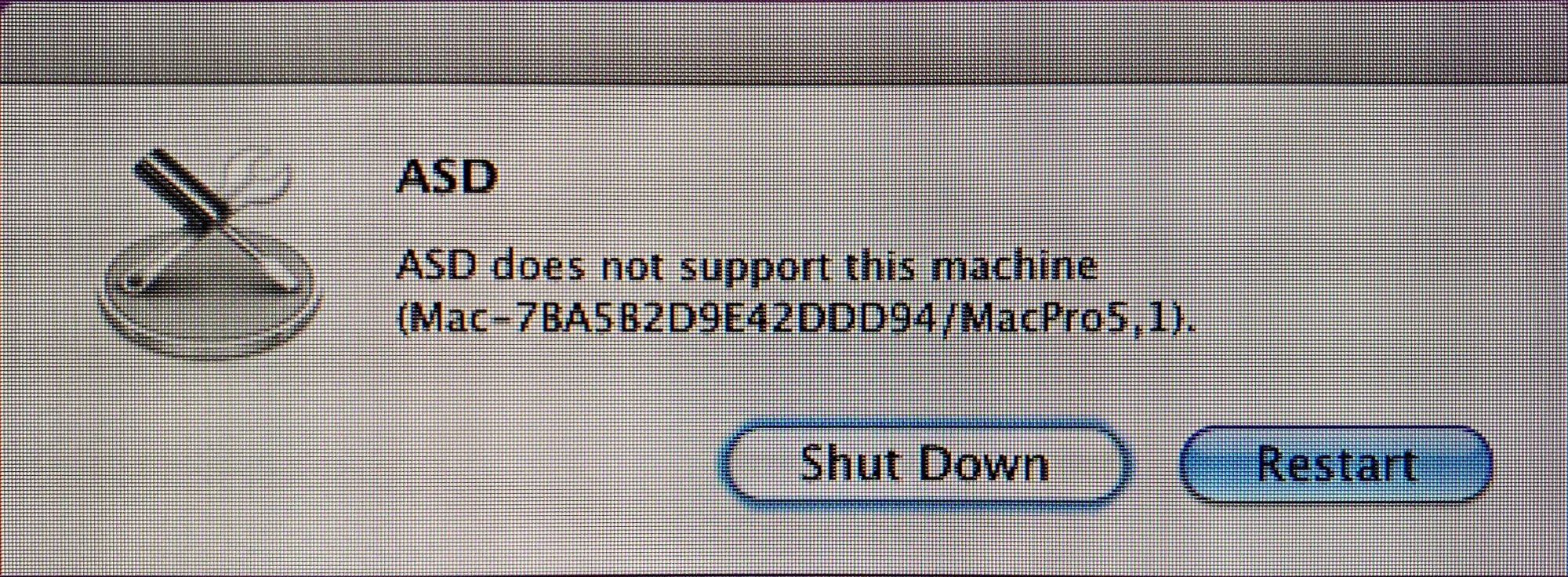

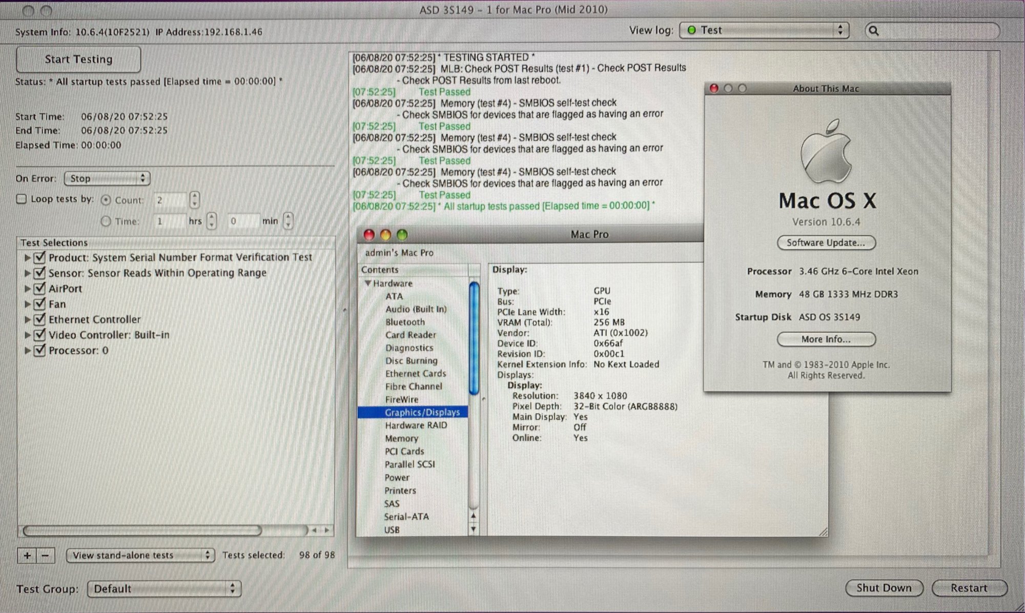

I just tested ASD via OC. It also works with the non supported Radeon VII.
But we must turn off SMBIOS spoofing, otherwise, the spoofed board ID will cause ASD fail to start.
I ran some of the tests that have supported hardware (e.g. Processor test). It actually works, and able to show me the big green pass result.
This may not be a super useful finding, but at least it means that we have a good tool (for those who doesn't have the original graphic card) to verify system serial number, and test processor / sensors / fans / ethernet (I assume most of us have upgraded wifi card and GPU, therefore the Airport and Video tests won't be valid).

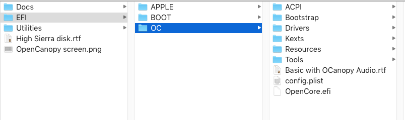

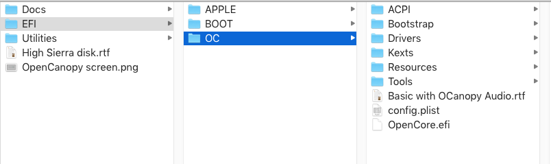

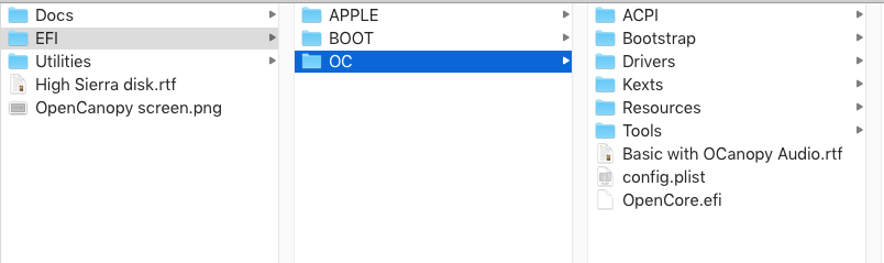

Unrelated but not totally unrelated... is it possible to add comments in a plist file? I'd like to leave notes in my HW Acceleration config in order to find them easily the day I want to update OC on my machine.
As far as I know there is not a way to annotate the config.plist file.
I tried several methods suggested in posts on the internet but they were incorrect.
The XML checker does not seem to tolerate comments, nor does the OpenCore validation tool.
If someone knows of a method to incorporate comments please document your method for inclusion in a FAQ.
What I have done is to add a .rtf document to the EFI folder and the OC folder. I also keep a screenshot of the OpenCanopy screen in the EFI folder.
