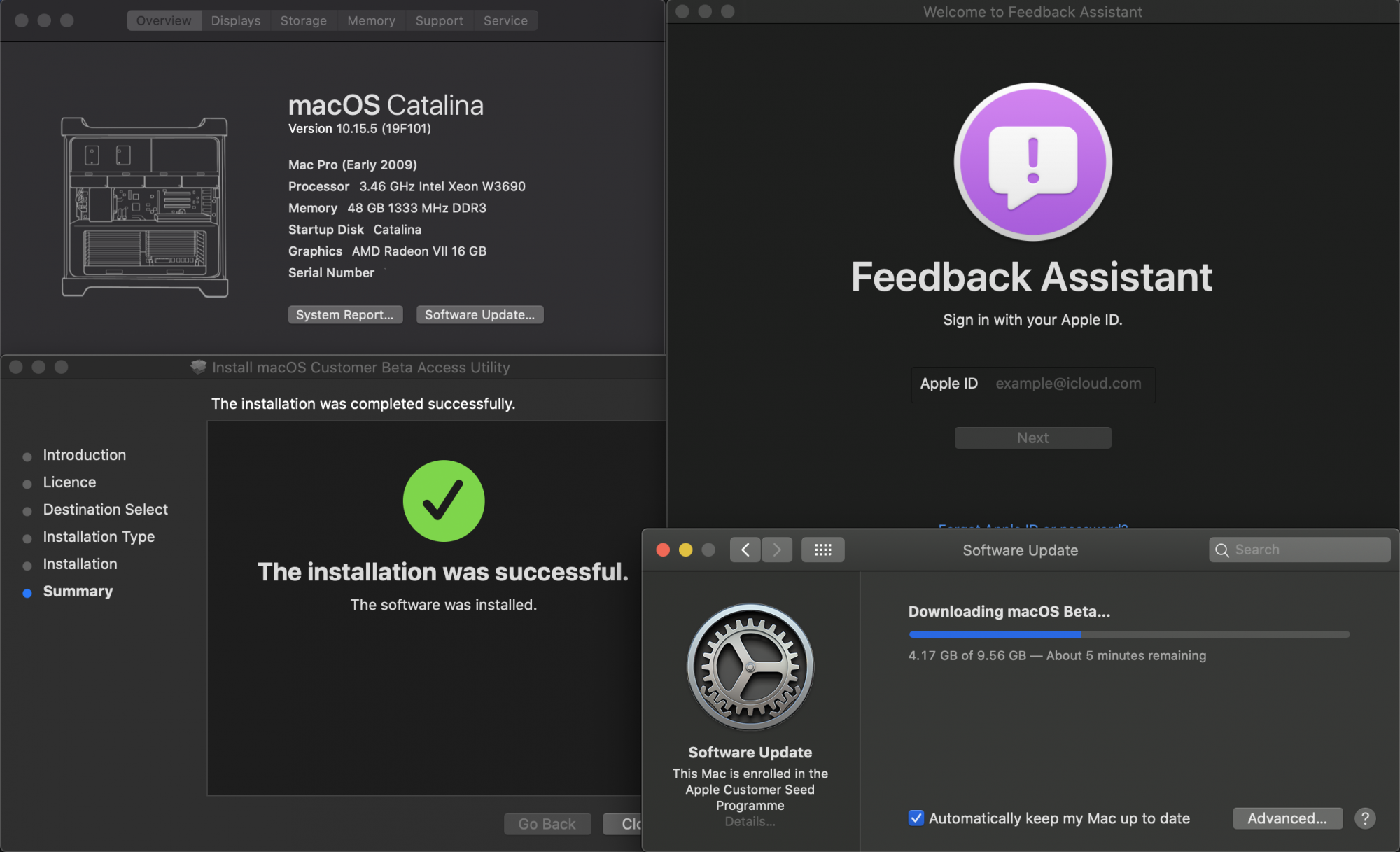

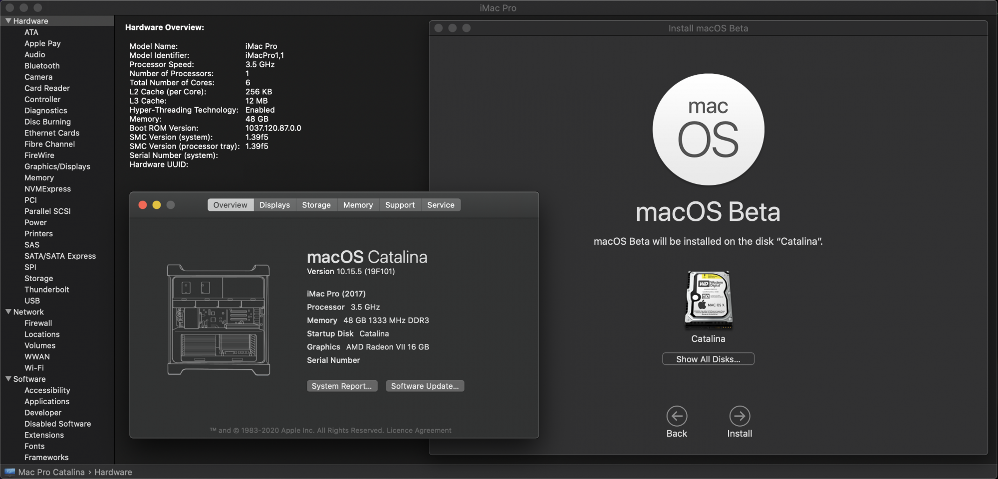

Having trouble running the Big Sur updated from on-site Catalina with VMM flag but will try to install from USB or I will disable the iMac / whatever green kept stuff and see if that makes a difference.
It seems OK at this moment. Let's see if I can install that properly.
