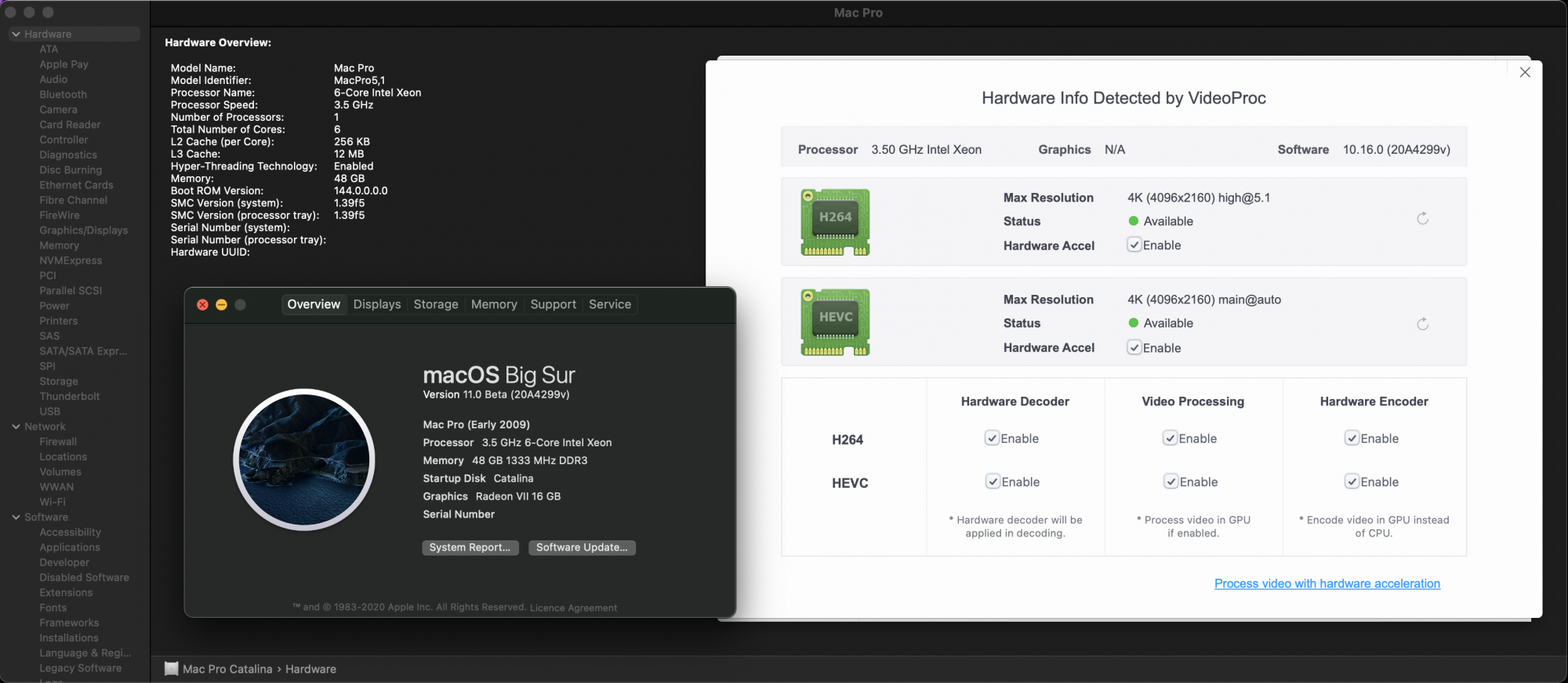

Interesting. Boot Camp Assistant in Big Sur now works without modification. No more "This Mac does not support Boot Camp." The utility even detected my existing Windows installation and gave the option to erase it.
Reactions: TECK
That's due to the iMac Pro SMBIOS spoofing, nothing about the Navi X6000 framework issue.
Without this boot argument, most likely only one display port on the card will work.
