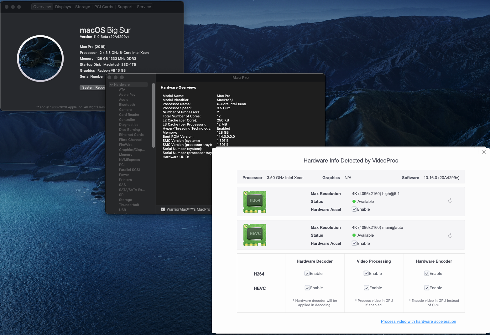

Well I was finally able to spoof it has a MacPro7,1 on Dual CPU Tray. There is only one thing that you do not see here if you paid attention to...
